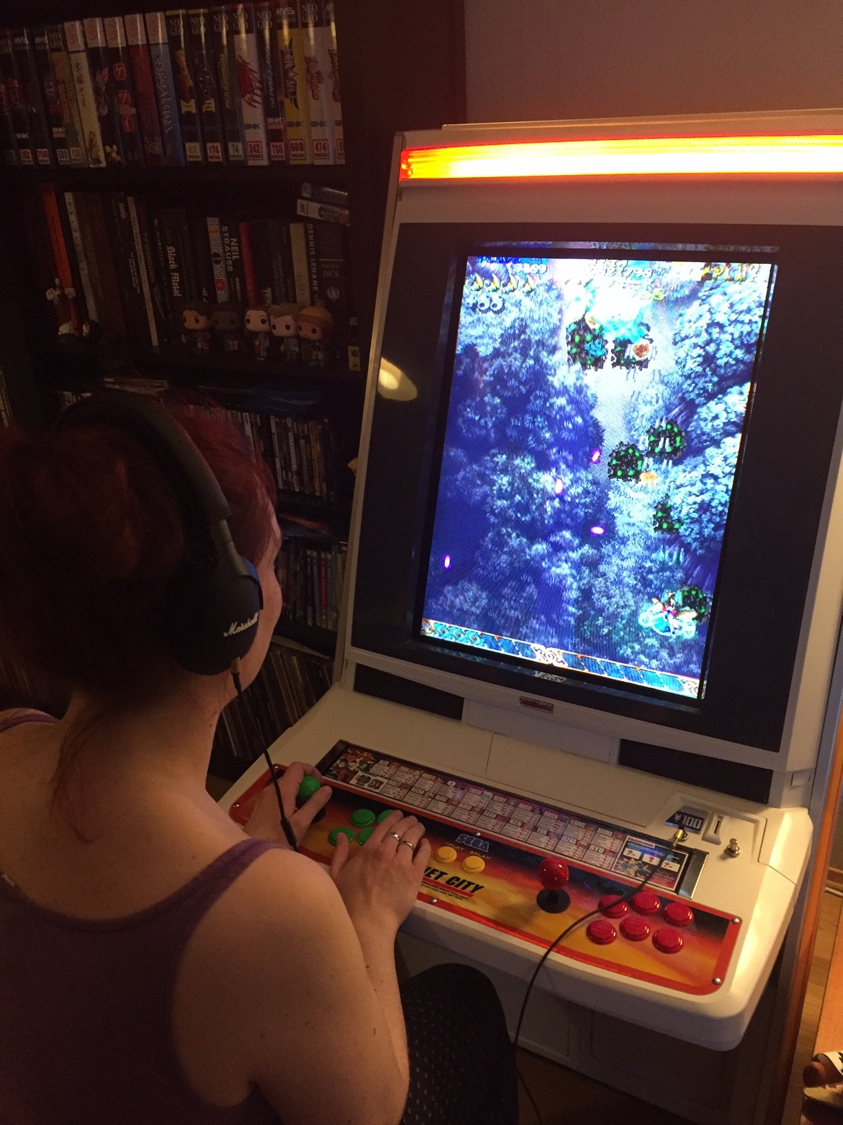

Got my wife hooked on Mushihimesama. She’s rocking maniac mode like a boss!
Make her play with you and you’ll have no issues :D
All wives are bosses! I found that out very soon after marriage :) looks like that picture captures all your life's loves in one image. I am jealous of how good the screen looks too.
Yup. She’s awesome!
The screen looks soooooooo much better in real life!
Get a jammafier and tri-sync helper from @invzim. You won’t regret it!
