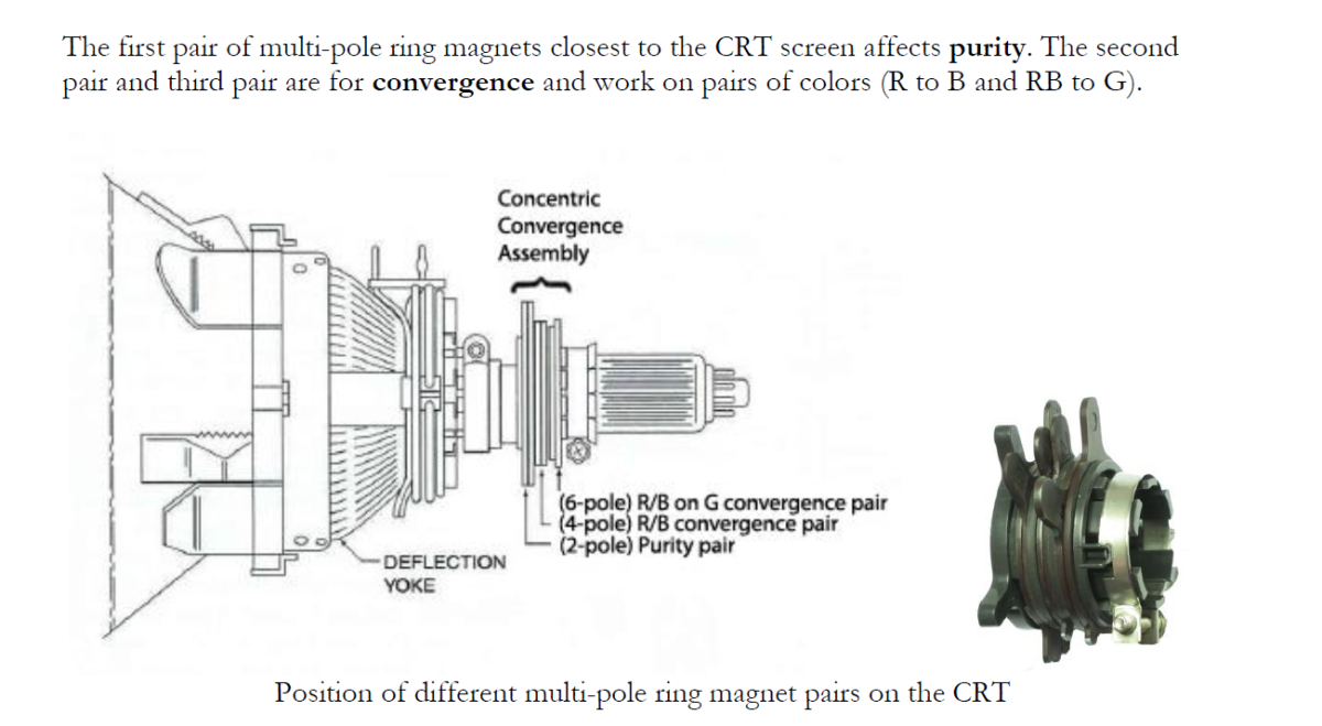

So you have a big purity issue there, the last ring set placed on the neck of the tube, the ones most near the yoke should cure this but if do Not and a degauss do Not fix, then the shadow mask is dislodged due to an impact..really I hope this is not the case.
Interesting, I'd be curious to learn more about how that works. At the moment, they spin freely all day with minimal resistance. It's entirely possible I just lack understanding of how this is supposed to work.
I think the lock ring set might just be glued down.
The two rings closest to the yoke adjust purity.
It takes a lot of mucking with to get a real feel for any of it making sense. The guide on AO is really helpful.
I dont think they glue those rings tbh they might put glue on the ring to hold it to the plastic one one single point but thats it.
Heres a good question when you say the rings move pretty freely. You say ring(s) Are they all moving at once?? cause if so that is an issue. I feel im reading into that too much.
Theres a pretty good pdf document called A Guide To Setup and Adjust The CRT of an Arcade Color Monitor by Ingvar Karlsson that has some really good info and reference diagrams. Highly recommend checking that out a little if you can.
