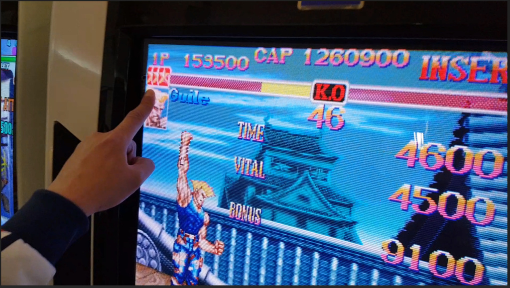

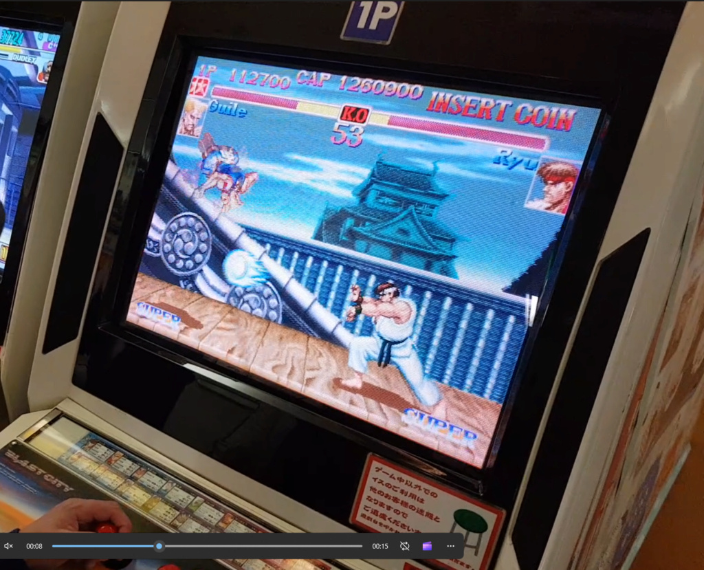

I have already a NNC. One picture from my last Japan's trip:
I dont remeber exactly but I am pretty sure was TF in blast.
Another way 3D print from NNC Bezel?
Hard to tell the chassis from a picture. From my experience, Blast monitors used to be replaced by Wei Ya chassis, I've seen that a lot, but never with a Toshiba PF. Toshiba chassis tend to have geometry deformation on the top of the picture on 15kHz, but not always with CPS2.
