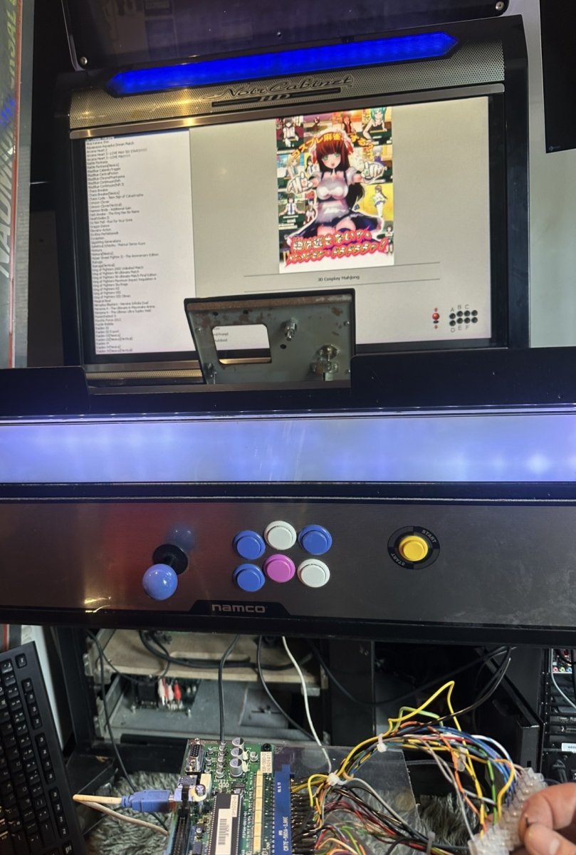

I picked up some namco noir and a Naomi NNC ….
and have been trying to get past a jvs error on a ttx2 multi I have had a year or so ,
but I have never actually used until now. 😁.
I have the namco tekken 6 blood lines type io in the cab ,
And it works 👍
It works with nessica games but no 3d taito street fighter fast io titles ..
But … I get jvs errors chaos breaker ,
Death smiles 2 boots but
Just does not respond .
Street fight 4 super & ultra ..
jvs error 00002
So I wired up a sega jvs to jamma today to try that and
It was exactly the same as the namco ..
same games worked / same games didn’t work .

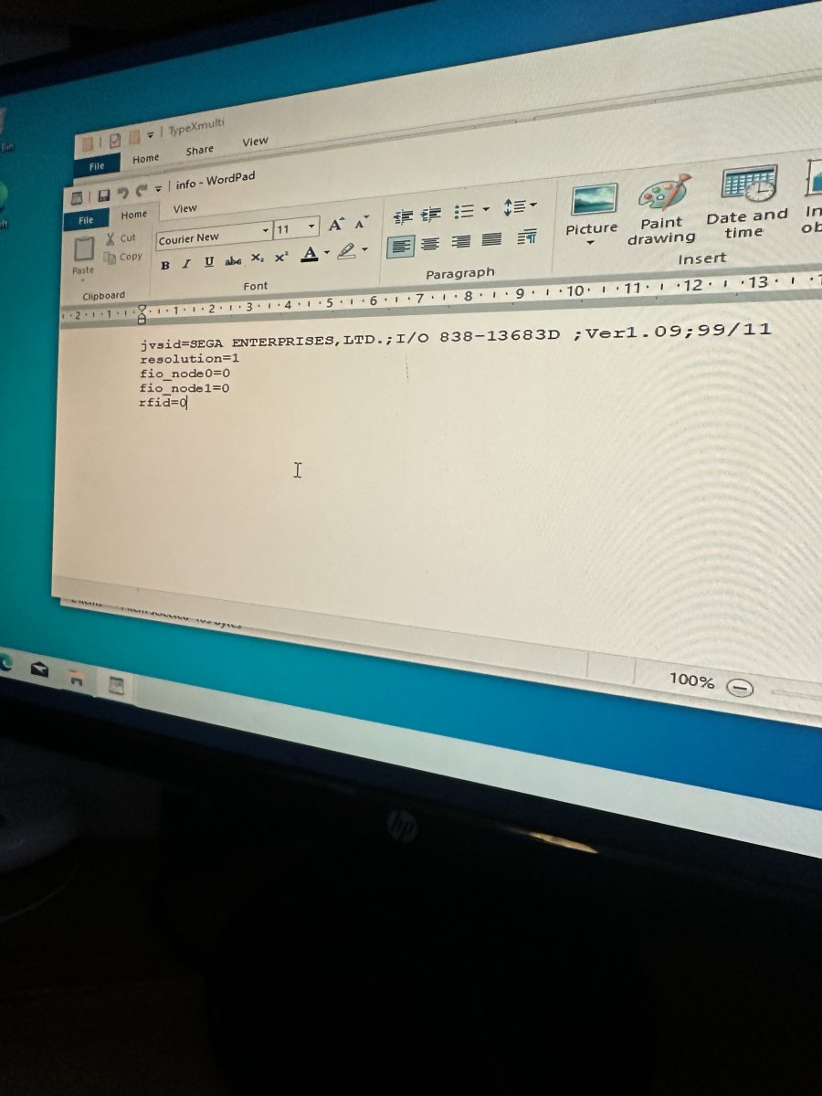

plugged the ttx niko multi to my pc just to see if the
Game type = jvs
Was present and it was ?
So I’m scratching my head now ;)
Also info word doc in the typex folder that resides in with game folders has an info doc that has documented that it has seen my jvs to jamma io ..
Any help really appreciated . Thnx
Like should a sega jvs to jamma work ok ?
Should namco
NA-JV2 work fine with all games on niko multi ?
In other words is my problem residing somewhere els ?
