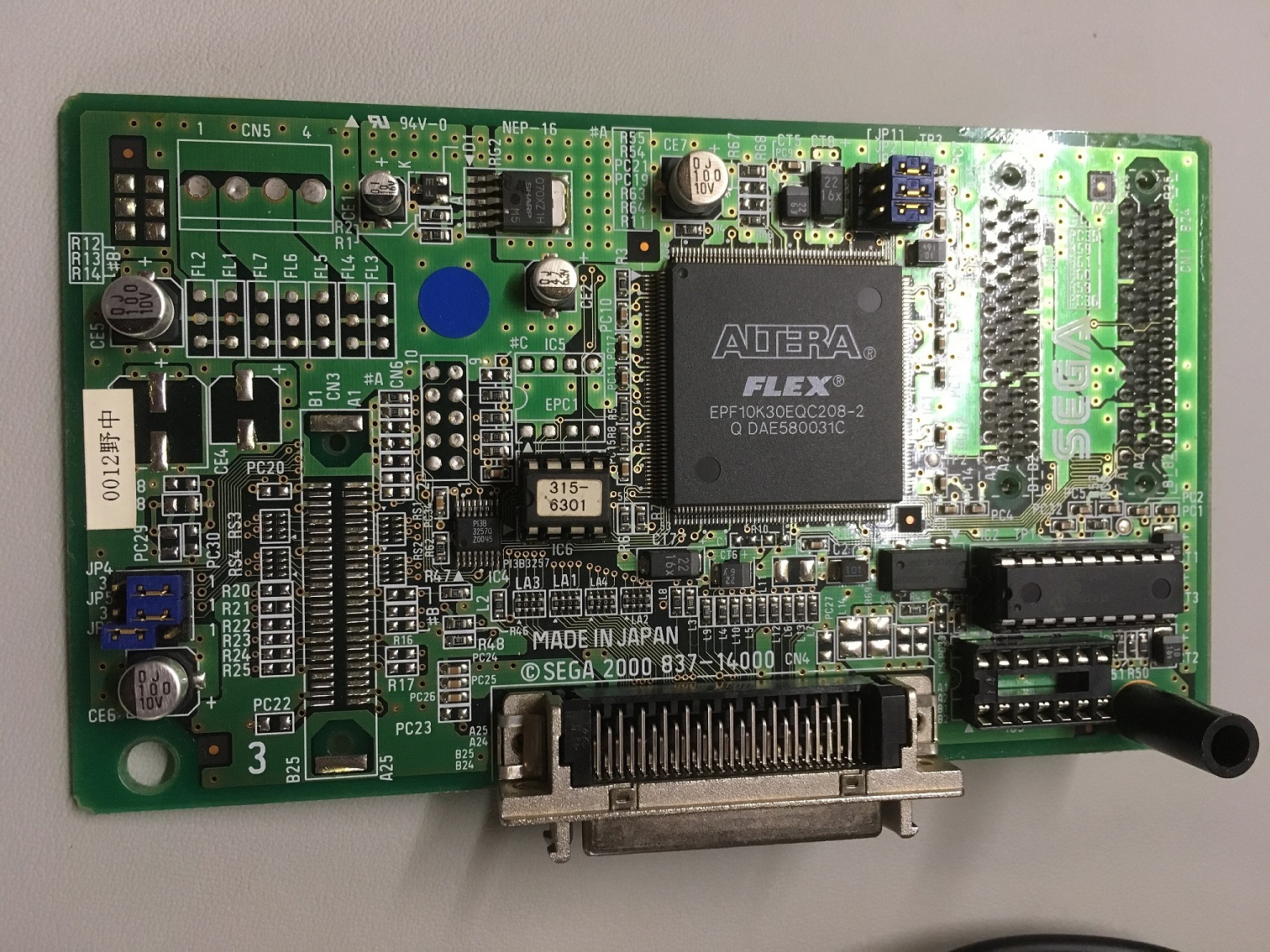

Related question...Could someone please check and tell me if the blue JP1-6 jumpers are set up correctly on this Dimm board?
I...may... have borrowed them for something else and not exactly documented their original position for re-installation... :whistling:
