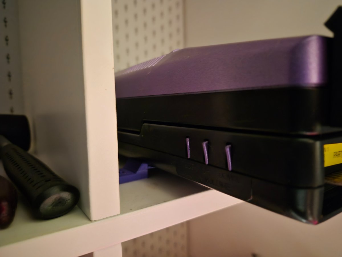

I cant get these to sit right in my multi they are just a bit loose and flop around. Its fine if I dont adjust the volume too often but they either fall off the internal button and dont hit them correctly or get stuck under the top opening lip and hold down the button continiously. Any tricks to getting these to work?

yeah the tolerances need to be on the tighter side for these to sit right. truth be told they're tuned for my own printer which over-extrudes slightly. you want the windows in the bracket to be as small as possible without actually binding. So you could set your printer to slightly over-extrude (if your software allows that), or modify the bracket model to either shrink the windows, and/or expand the size of the buttons.
