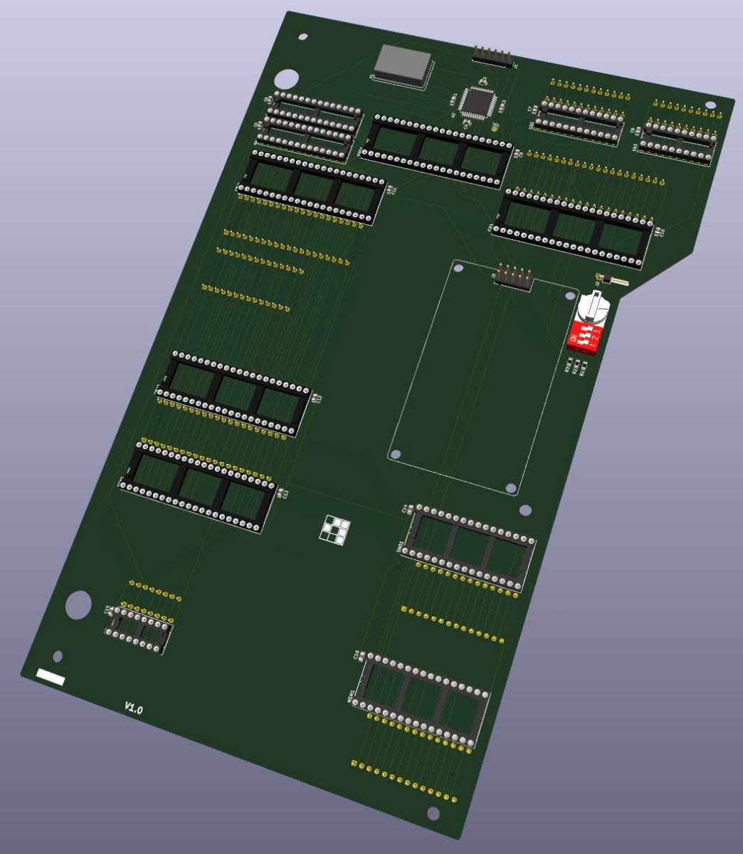

A few months back I made a few small PCBs for some experimentation, and more recently I did my largest PCB yet in the form of a simple multi for the Metro VG420 hardware.

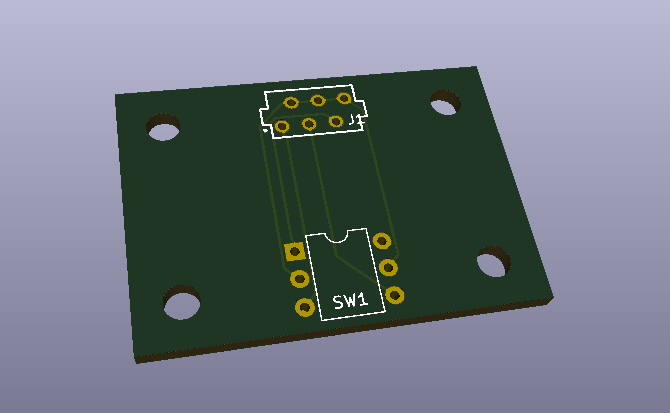

followed by my smallest PCB ever in the form of a rotary selector for the CPS3 Ultra SIMMS

the PCB I'm working on now is another multi... and NOT for the VG460 hardware :D
In this one I'm incorporating all of the lessons learned from the VG420 and doing things a bit more professional and repeatable and designing with manufacturability in mind.

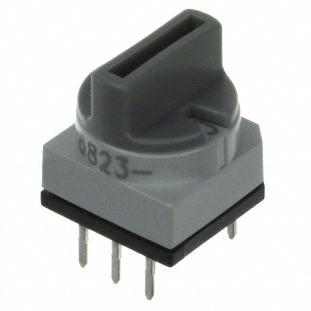

The Rotary Switch is something I really like instead of dip switches on these simple multi kits, a simple 8 or 16 position knob is much more user friendly and nice looking than a bank of dip-switches.
It's been difficult to find these at a reasonable price though.
the Apem PT65 series is the one I'm using so far:
https://www.apem.com/media/apemProduct/PCB_serie_PT65_10_11_2021.pdf
It's a nice little switch but the price is damn near $15 which is robbery for what should be a <$2 part.
The only other models I've found with a nice "segment wheel"
the only other options I've found are:
1. Gray Hill 94 series:
https://app-grayhill-website-cms-prod-001.azurewebsites.net/media/xvhksa34/94h-datasheet.pdf
they sell the knob separate from the switch and once you buy both it's not much cheaper than the PT65, not to mention it's a much uglier looking switch.
2. E-Switch RDT series:
https://configured-product-images.s3.amazonaws.com/Datasheets/RDT.pdf
These actually have a reasonable price, but I can't find any evidence that the version with a segmentation wheel actually exists anywhere for sale.
searching around Alibaba the only evidence of any of these is this one listing which shows a picture of one of these switches:
https://www.alibaba.com/product-det...offerlist.normal_offer.d_title.410813a0njNhYq
there's no clarity on the listing on how to spec that version of the switch though, I've reached out to them for more info but haven't heard anything back in over a week now, so I have little confidence that anything will come from it.
Anyone else know of any other options here? it's be really great to find a <$2 option

So here are some tips that has really helped me out, especially with these big PCBs that need precise pin alignment in sockets.
Of course using the grid feature in the PCB editor is the first step. pinspacing on normal DIP chips is 2.54mm (or "100mills") so make sure you grid is setup to a derivative of that. I've found that going at half hat size (1.27mm aka 50mills) will ensure that all of the chips will be snapped to the right measurement. Then you use calipers to measure distances between chips helps a lot.
but I had an EE that I work with recommend I print out my PCB layout to test fit before sending the PCB to fab... this has been a game changer!
this allowed met to quickly double check that all of the chips are in the right spot and the right size, and also gave me really great visibility as to what is under the chips so I can make sure I have good clearances between pin legs and any taller components like socketed chips on the lower board.
Another UPGRADE to this technique has taken this even further. Assuming you're working with a nice PCB that has straight pins on the solder side, you can place you paper model UNDER the PCB line up some pins for chips on opposite ends of the paper and puncture the paper with the pins. then continue through puncturing all of the pins for every socket header you've got on the sub-board you're designing. Then you can peal off the paper and the puncture holes should all line up with the chip pins on your print out... if they don't you should have a clear indication of how far off they are and in what direction.
for the VG420 PCB I probably printed and re-printed the paper a dozen times to dial in the pin spacing. figuring out the pin puncture concept for the VG460 and this new ***** multi I was able to dial in the chip spacing in just 2 or 3 prints. And of course the best part is really high confidence that the pin alignment is going to be right when you send the PCB to fabrication and blow a few hundred bucks and a few weeks of time to get the boards made.
