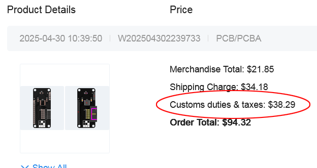

Just designed a small interface board with some voltage buffers to interface this LCD PCB with the multi... sent it to fab...
...ooof
if this doesnt affect any part of your bussiness , im happy to receive the items and forward to you (small postage costs for goods)
I appreciate the offer. I think for now it is what it is, though maybe with the next multi I can have things shipped directly to an EU distributor

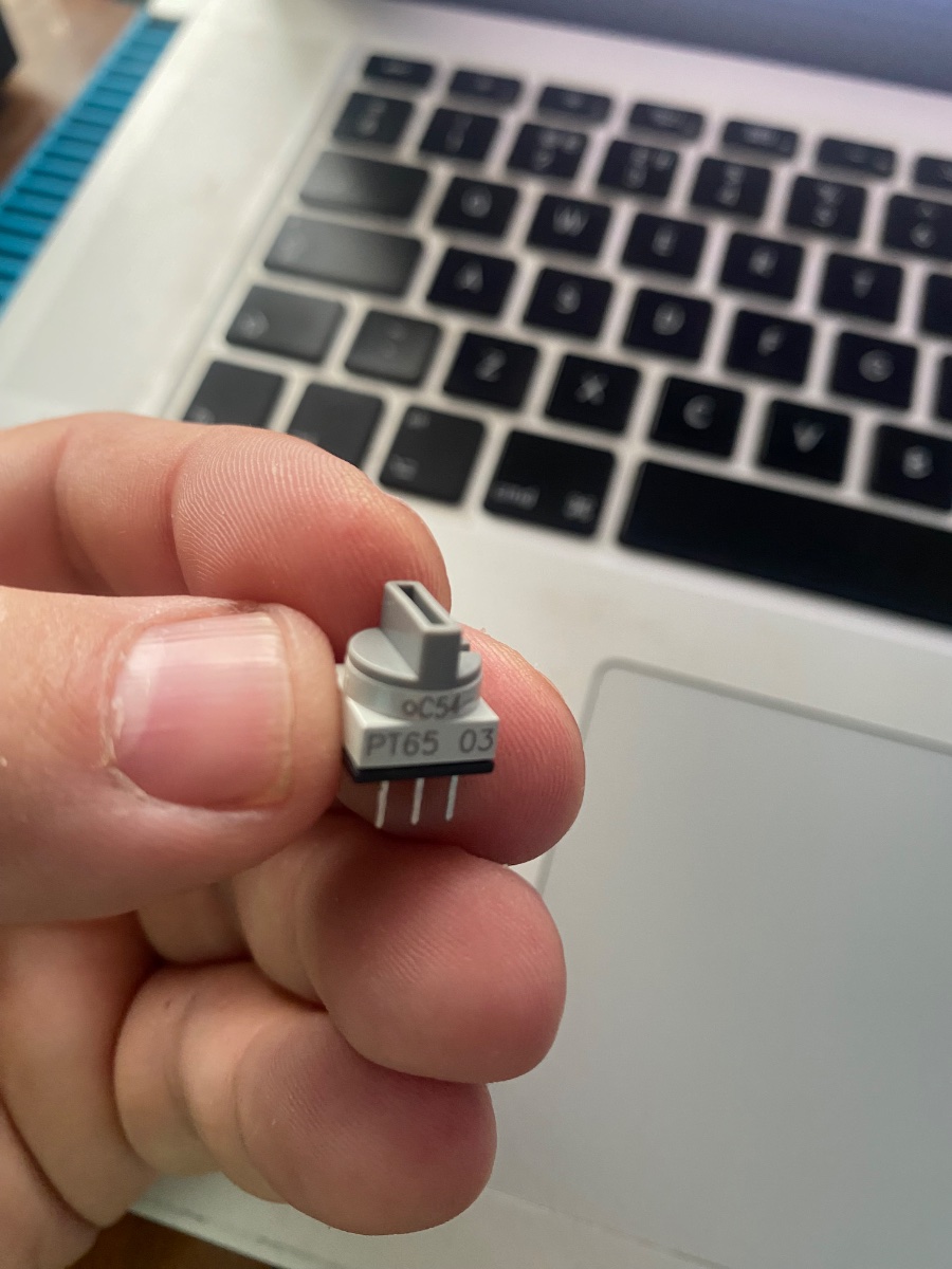

the Apem PT65 series is the one I'm using so far:
https://www.apem.com/media/apemProduct/PCB_serie_PT65_10_11_2021.pdf
It's a nice little switch but the price is damn near $15 which is robbery for what should be a <$2 part.

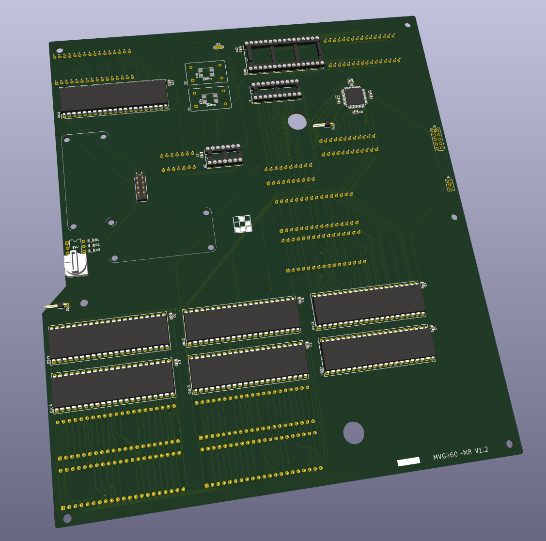

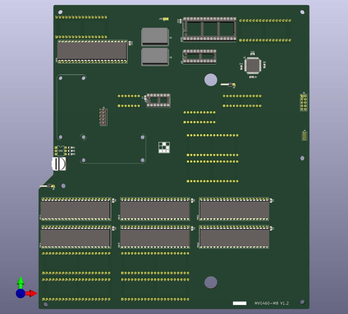

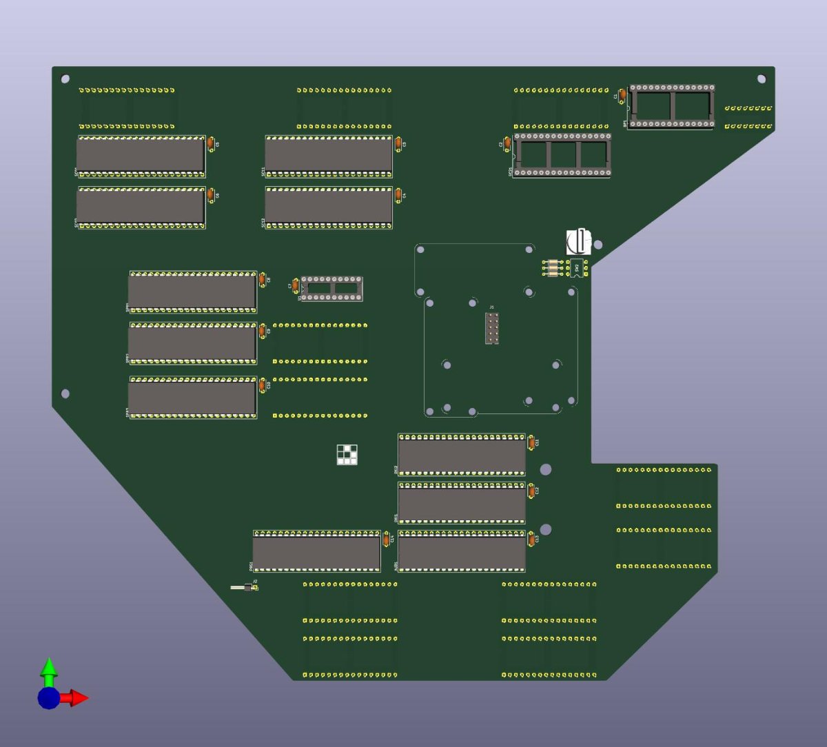

yes, progress is being made on the VG460.
I have the new design complete but I do need to finish writing the code and then go over the whole schematic with a fine tooth comb before I get a prototype made.
here's a sneak peek
