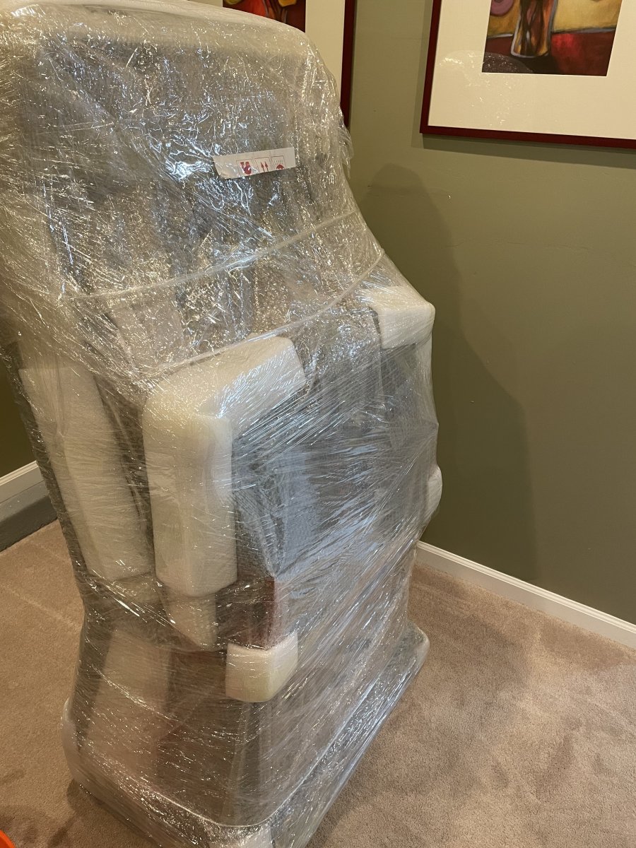

I received my cabinet on Friday Feb. 24th. It was a group order with someone else so there are 2 crates
The machine itself was wrapped in bubble wrap but otherwise not secured inside the crate. This is going to be important later.
The unit was packed using the traditional Vewlix shipping L brackets
Unfortunately, the cabinet had a hard time inside the crate and the frame bent; cracking one plastic piece
I tried disassembling these parts to see if I can click them back into form but to no avail. I'll have to live with the panel gaps.
