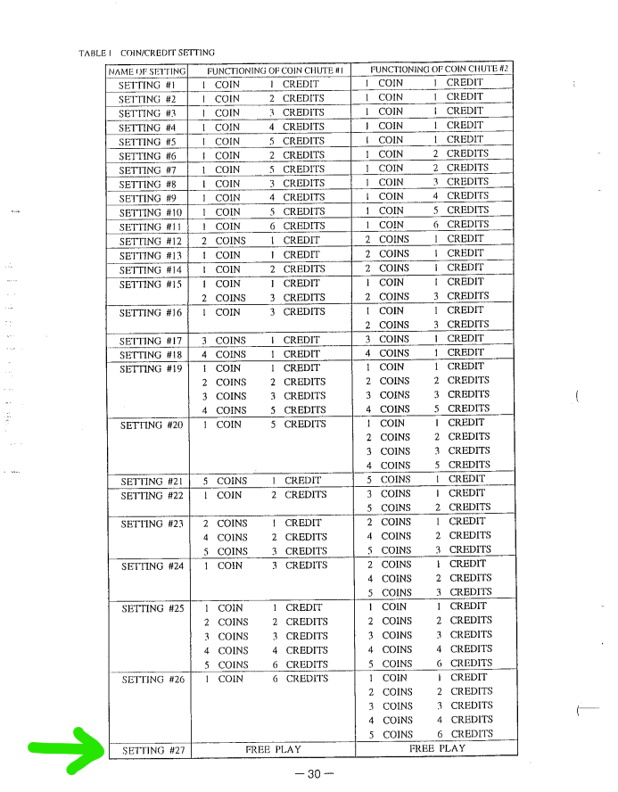

I run HOTD2 with CF Boot and setting free playFreeplay is already built into the game.
check the manual on how to set it: https://oldgamesdownload.com/wp-content/uploads/The_House_of_the_Dead_2_Manual_Arcade_EN.pdf
