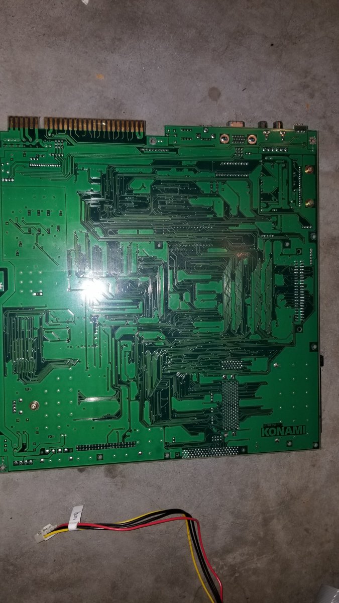

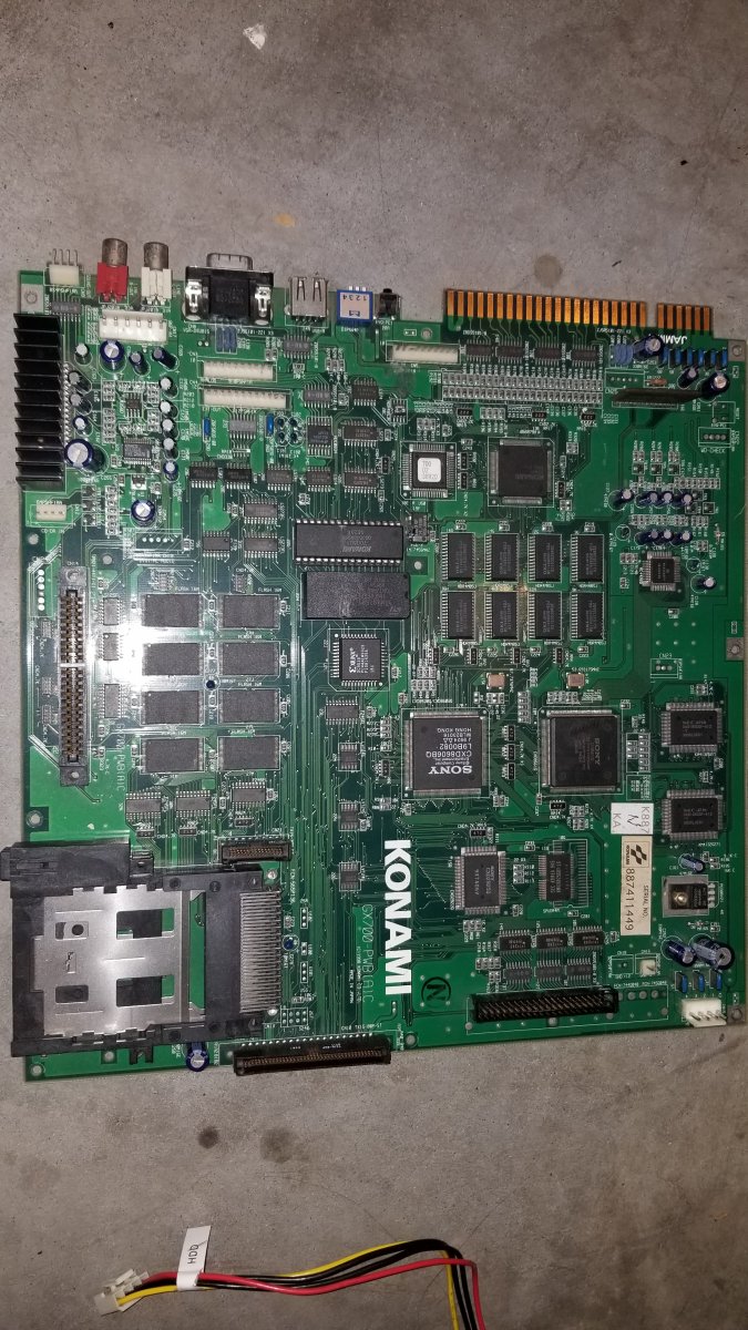

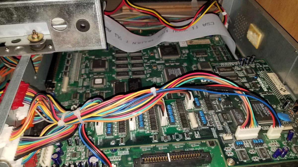

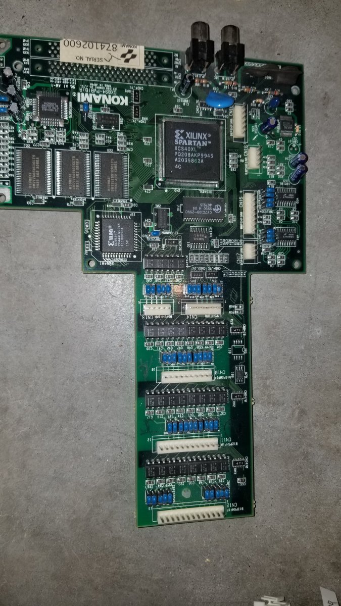

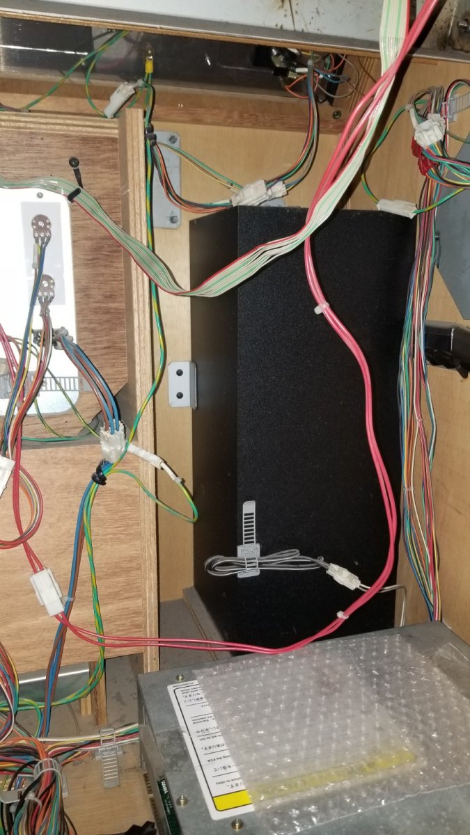

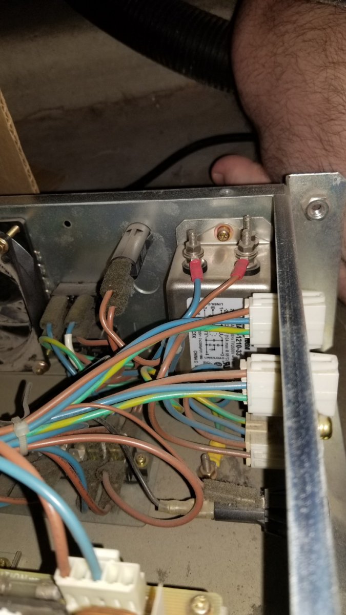

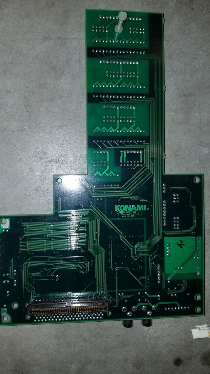

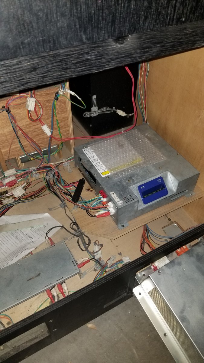

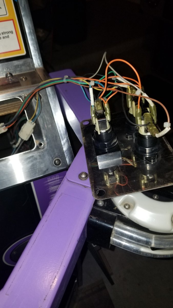

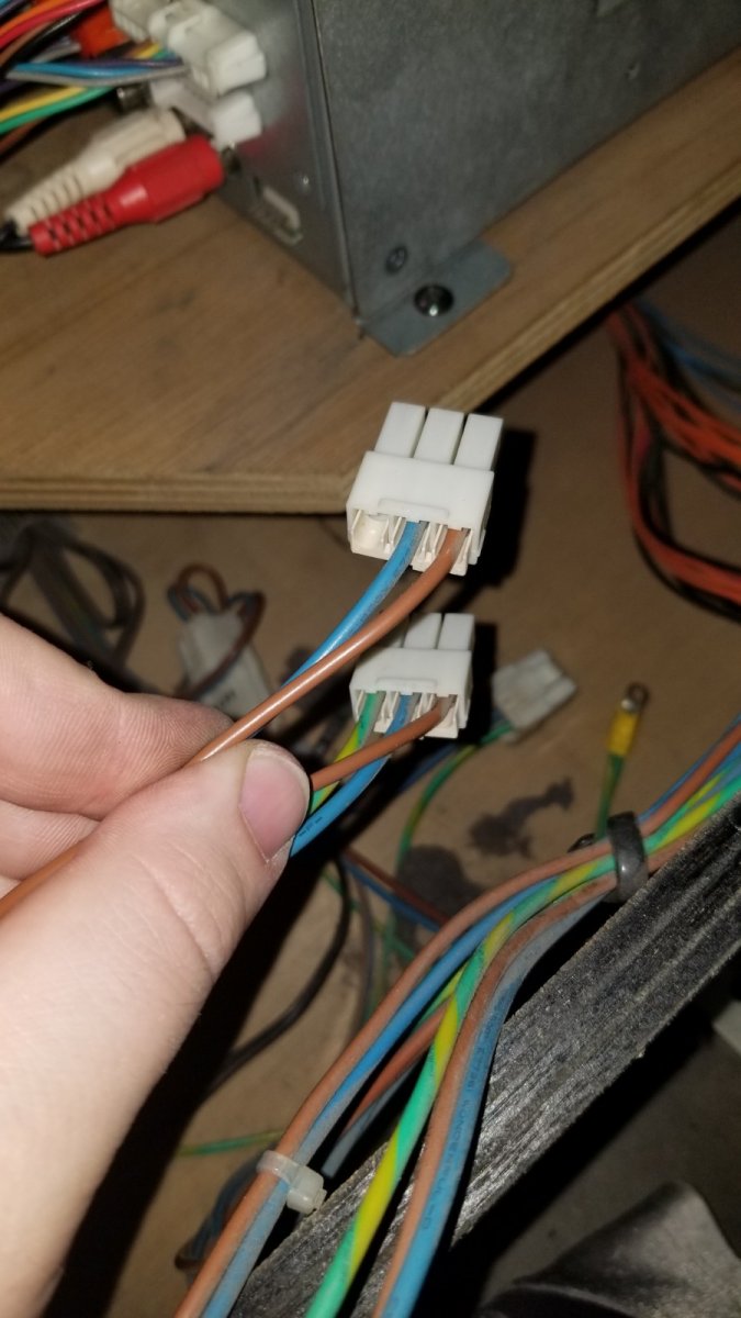

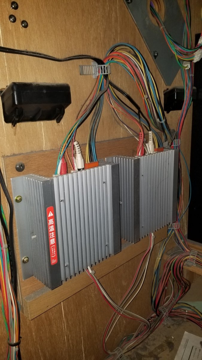

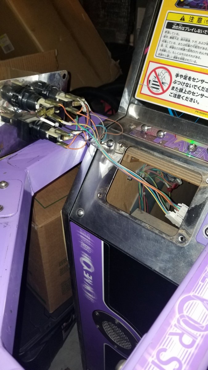

Okay, I took some photos, thanks for the early advice! I do have a multimeter, but when I busted it out last night it was dead on batteries and the stores were already closed so I couldn't buy more, fixed that.
I don't see any modifications to any of the wiring, it's all clean and organized and looks how I would expect it to look. The only thing I've noticed is that one of the connections going into the power supply did not have the green/yellow cable going into it like the other did, and that the opposite side of the connection did have that wire. I haven't done a deep dive yet, but I don't see a spare wire floating about like it had been disconnected. It looks like it just screwed into the side of the unit as a ground and then chained off to a bunch of other points in the cabinet.
The pictures represent the state of the machine after taking out the power supply last night. I've since dusted out most of what I can only assume is 20 years of accumulated particles. I'll put it back together once I can confirm that that wire isn't in fact missing, and break out the multimeter then.

it's a relief to see unmodified harnesses in there. I think the lack of the green/yellow wire is normal, that's earth ground and and usually it's left off of the last harness in the line on Japanese cabs. Not sure why.
@psychicdrive might be able to look these pics over to see if there are any less-obvious things out of place as I know he owns one of these cabs.
For the multi meter I'd start testing the DC output levels on the 5V and 12V lines to see if they're out of whack, most likely that's what leading to your failure to start/clicking.
looking at the photos the PSU board on the left is your DC power supply and it looks like there's a little yellow pot on it for adjustment. it's hard to say for sure though as I'm not familiar with this PSU and can't read the silk screen... take a close look to see if it's labeled and don't adjust it until you've confirmed and tested the output. it also looks like there there's manybe another DC PSU below it. The equipment on the right is likely for driving all of the lamps and/or audio amplification, I wouldn't worry too much about it right now.
you might also want to put your multimeter in continuity test mode (the one that beeps when you touch the leads together). and then with the cab off, or the control panel disconnected from the cab, test the leads of the buttons one by one to see if they're making contact when you push the button, this will confirm if the buttons working or if the issue is deeper in the cab.

for the continuity tester I mean testing the wires is fine but I was suggesting you test the buttons... buttons are a wear item, like the tires on your car, or a pair of sneakers they're only going to last so long before they wear out and stop doing their job properly. probing the leads of the button you should get no connectivity when the button is not pressed, and solid connectivity when it's pushed...
if the buttons test good you can take it a step further with the cab off you can probe between ground and the button pins of the JAMMA connector to see if you get connectivity when the button is pushed. that will test the harness.
if that proves out good then with the cab powered on and your multi meter in DC voltage mode you can probe between ground and the button pins on the JAMMA edge and you should read 5V when the button is NOT pressed and 0V when the button is pressed. that's usually a good indicator that the IO portion of the PCB is functioning properly.

All good on Pin 17, this particular cab apparently uses 18 and 19 for the left/right arrows on the cab front, all good there too -- 5.08 normally, 0V when the button is held down. Still no output from the start button on 17 though.
16 does close down to 0V when the switch is held down and today, for reasons I'm not sure of, the readings kept getting higher and higher seemingly the longer I left the machine running when it wasn't being held down, but seemed to stop around 4.5. Still no response there either.
when you say "Still no output from the start button on 17 though" does you mean it doesn't stay at 5V normally and drop to 0V when pushed... or it DOES do that and there is no response in-game?
on the coin switch, if you unplug the connectors from the switch itself, what does each wire read when compared to ground on the JAMMA edge?
if you the two wires together while they're unplugged from the switch what do you get for a reading on pin 16?
It does stay at 5.08 normally on Pin 17, and if the button is pushed/held it does drop to 0V. But there is no response from the game, it does not register the button press.
On the coin switch, there's two wires, the green wire going to Pin 16, and a black ground wire. The ground-to-ground connection reads 0.00, the green wire read .25 when I first turned the machine on after work today. Then maybe 2-3 minutes later was doing 3.2, then a few seconds later was doing 4.75. This was not something that I measured in real time, I would take the probes off, go to remeasure it, and the values had already changed, it was not an escalating number while the probes were checking the pins/wire. With the two wires unplugged, used a piece of solder to bridge them together (I think this is what you were asking for?) and the reading on 16 became 0, but the game did not register any coins from this. Also note there's a green/yellow earth ground wire in this bundle as well that screws into the inside of the coin door panel. This was not grounded during these tests due to cabling restrictions. Don't know if that makes an impact.
