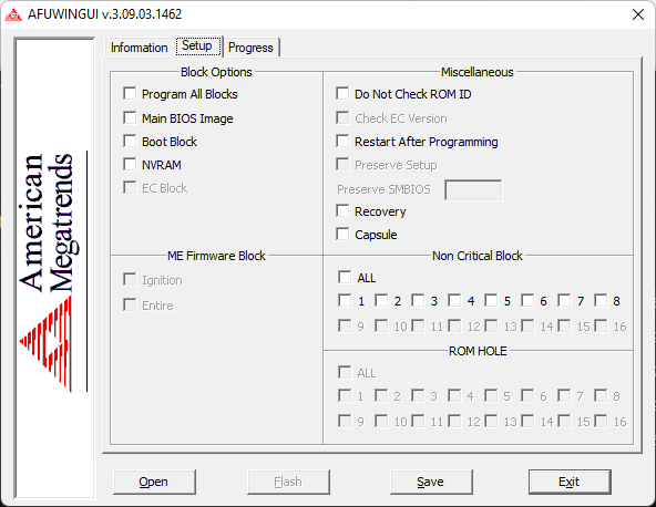

  • Launch the "AFUWINGUIx64.EXE" application. The Flash tool should open to the following window:
  • Fill in the four checkboxes under the Block Options heading, and click the Save button.
  • Name the file "oldbios" and save it to your Flash Drive.

  • Click the Open button and select the "TTX3-1.0b23-092614.bin" file on your Flash Drive.
    • Switch the File Type drop-down at the bottom to All Files to have the file appear in the file selection window.
  • Fill in the four checkboxes under the Block Options heading, and the "Restart after Programming" option under the Miscellaneous heading.
    • IMPORTANT: Make sure none of the checkboxes under the "ME Firmware Block" heading are checked. Updating this firmware block isn't necessary and it's caused side-effects with some systems.
  • Click the Flash button.

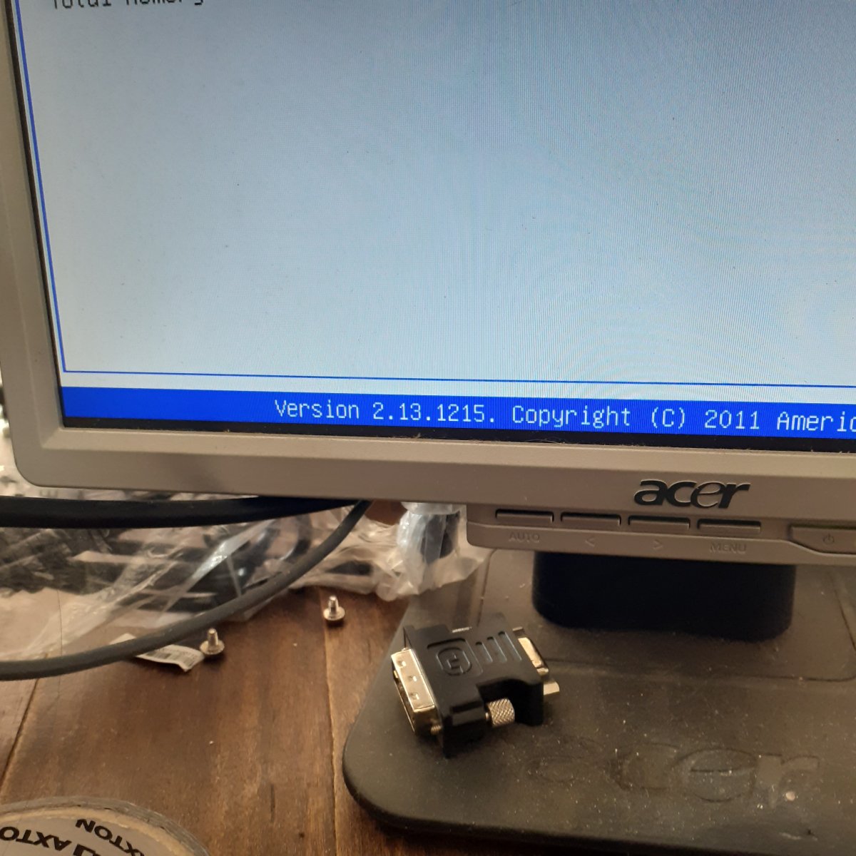

hi guys, i am trying to update the bios of my X3 but it doesn't work :/
i made it step by step, but all the time bios look like flashed, X3 restart, and lock on black screen with bip .... if i cut electricity and put it again the X3 start.
the actual version is 2.13.1215 . i want to put in a GTX 760, my 660 is dead :/
i am uploading video of it i post link when it's done :)
yep you are right @Murray . sorry but i didn't know where to see it, and when i looked on another post here i see a guy that look with cpu-z. :rolleyes:
i looked with cpu-z now and the flash is ok. sorry again for my incompetence :unsure:
it's ok, i updated the graphics drivers (card was not recognize) and it's good :thumbup:, next test this evening : put in the vewlix ;) . thanks again.
