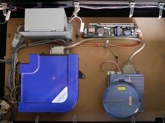

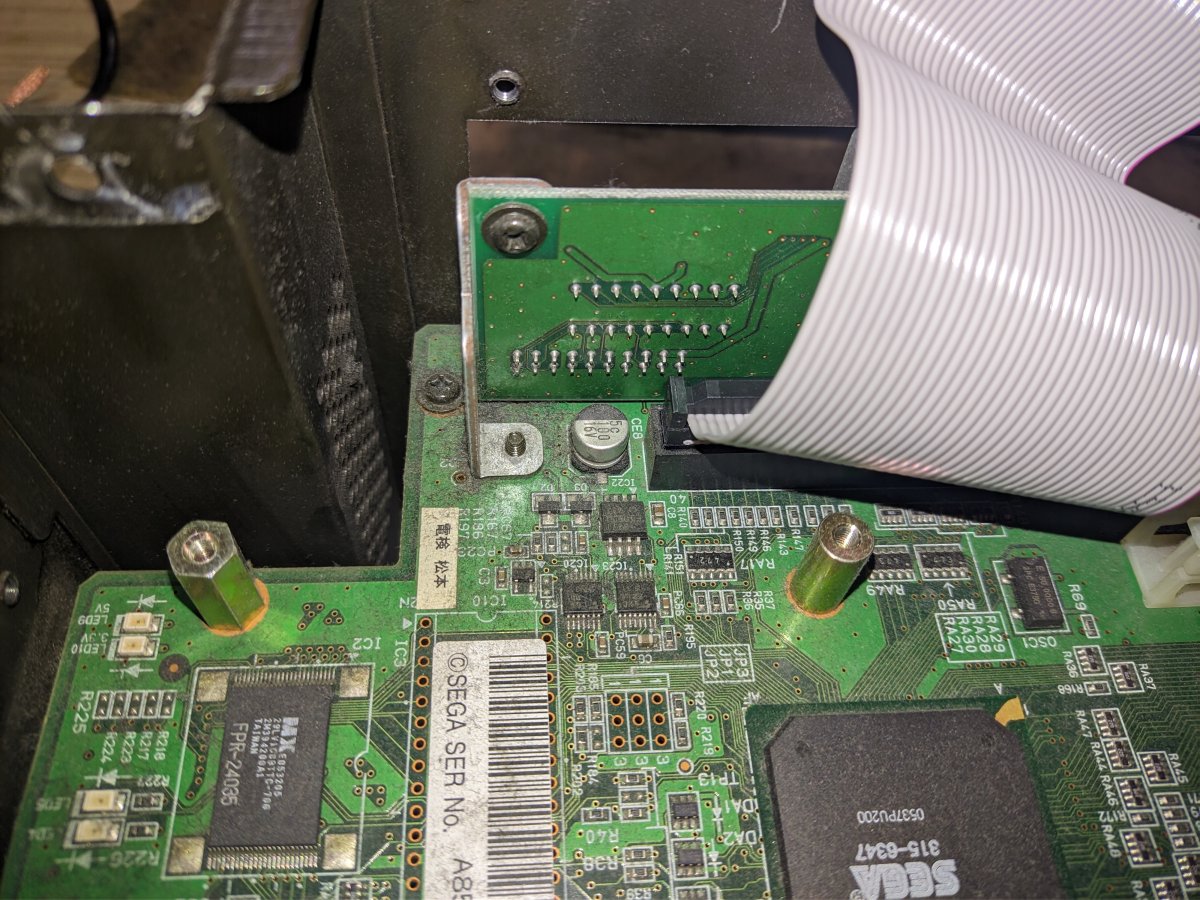

This the starting point. A Triforce with a GDROM drive attached. The Triforce firmware is old.

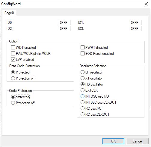

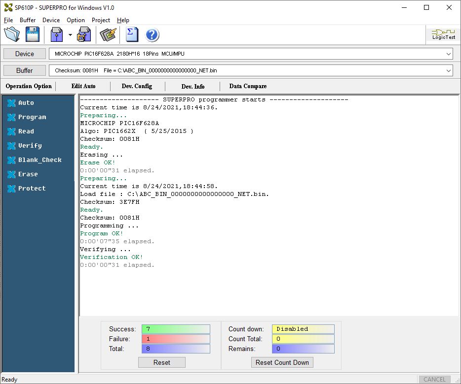

Take your programmer, set it to PIC16F628A. Put your chip in your programmer. Erase it. Load ABC_BIN_0000000000000000_NET.bin. Set your programmer settings as per the post above. The programmer I use is a Xeltek 610p. On this unit, the configuration screen will look like this
Write and then verify.

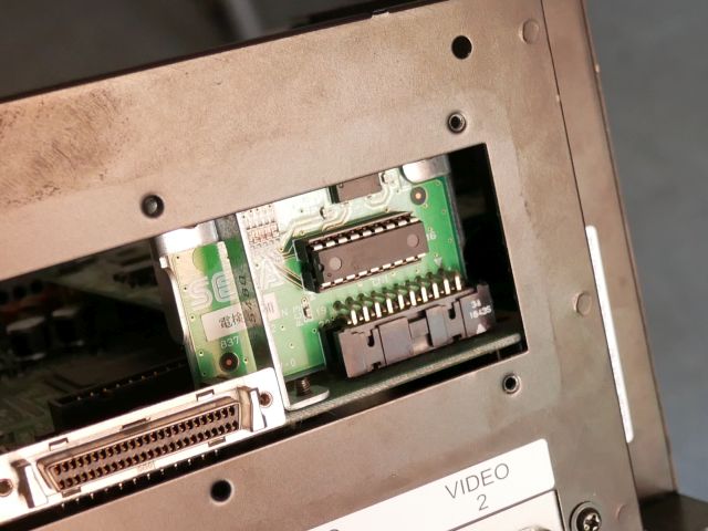

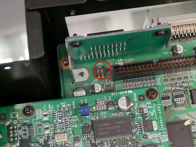

Take off the Triforce motherboard cover and flip the second dipswitch on SW1 to ON. The first dipswitch is there to control the memory 512MB/1024MB (ON/OFF), the second for NETWORK/DRIVE (ON/OFF). Remove the security key and insert your freshly burned zero pic key. Make sure it's correctly oriented. If you have a battery, unplug it. You can unplug the GDROM drive too.

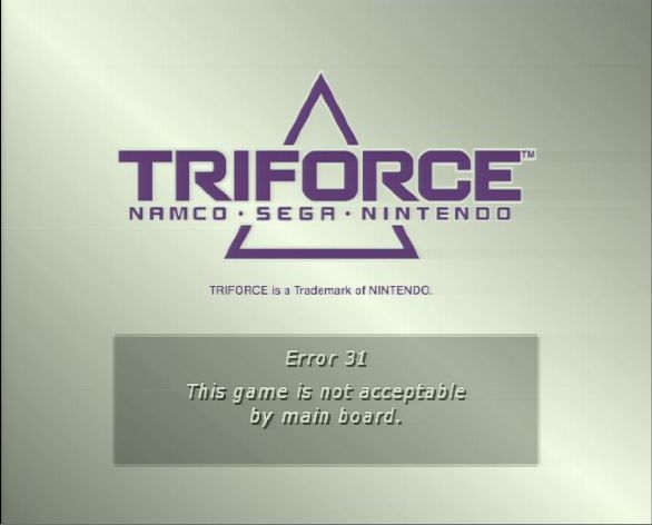

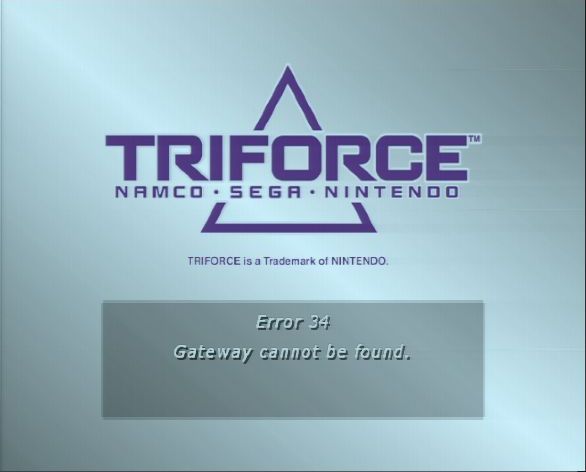

Turn on your cab. It should boot to 'Checking network' and then a Gateway error. However, if it boots straight to Error 31, don't worry about it, carry on with the tutorial.

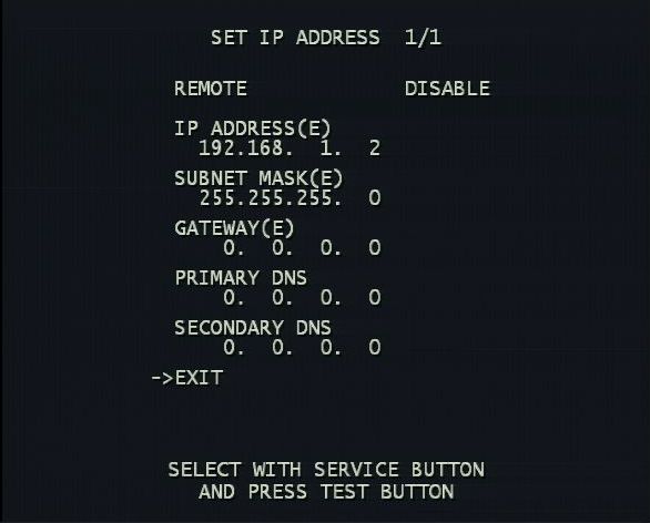

Press test to access the test menu. Go to NETWORK SETTING, set NETWORK TYPE to ETHER. Go to SET IP ADDRESS. Set REMOTE to DISABLE, IP to 192.168.1.2 and SUBNET MASK to 255.255.255.0.
Exit out of the test menu. Power cycle the cab. If it still returns to Error 31, that's fine, don't worry about it. It can now sit there while we configure the computer side.

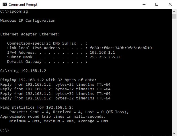

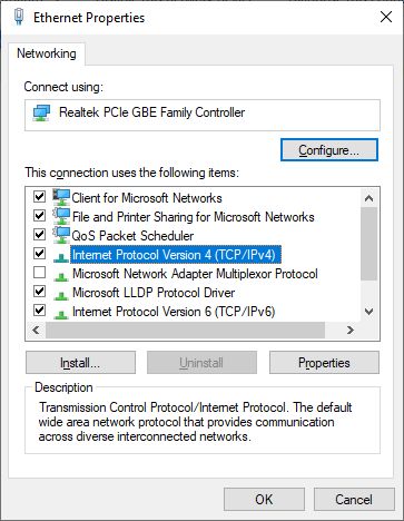

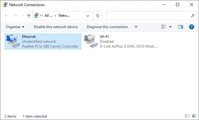

Boot up your computer. On Windows 10, open 'Network & Internet settings'. Press 'Change adapter options'. You should see an ethernet connection

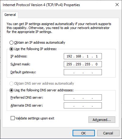

If you don't see one, I don't know, make sure the network adapter is enabled in the BIOS? Anyway, right-click Properties, then choose 'Internet Protocol Version 4 (TCP/IPv4)' and click Properties. Then punch in 192.168.1.1 as the IP and 255.255.255.0 as the Subnet mask
Press OK and Close. Open command prompt. Type 'ipconfig'. IP checks out? Cool. Then type 'ping 192.168.1.2'. You should get a ping back.
If you don't get a ping back, power cycle the cab if you didn't before. Then double check settings on both cab and PC. If they're OK, swap your ethernet cable and make sure it's crossover. If still no success, try a different computer. If you can't get a ping, there's no point in continuing with the tutorial. No ping, no connection.

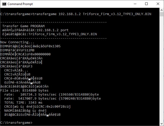

Open command, navigate to whatever directory you put the files in, and type 'transfergame 192.168.1.2 Triforce_Firm_v3.12_TYPE3_ONLY.BIN'. You will get a load of gibberish, don't worry.

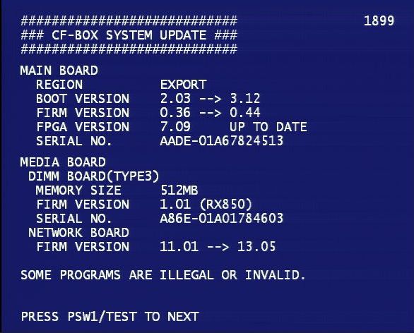

On the cab it should boot to the following screen

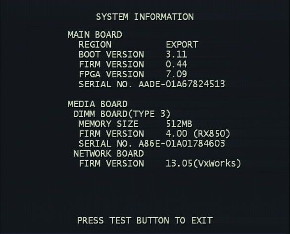

Press test as many times as needed. It will update up to four different things. When it's ready, it will tell you to power off. Powercycle the cab.

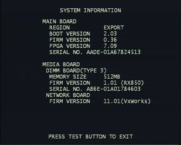

The system will boot to a 'Checking network' screen. System Information should now show the updated version numbers

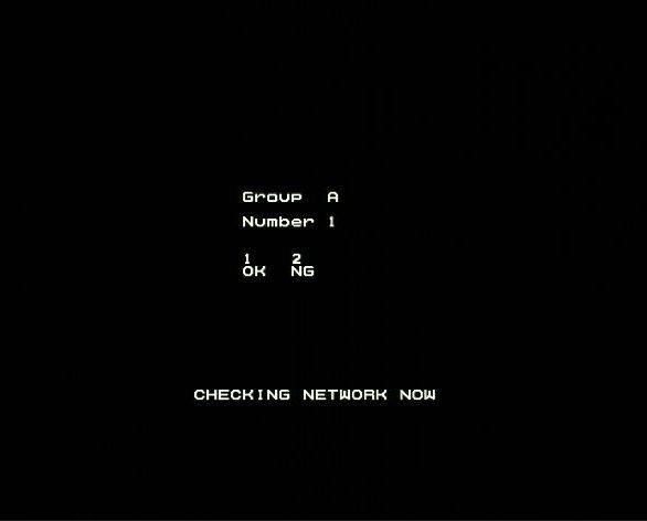

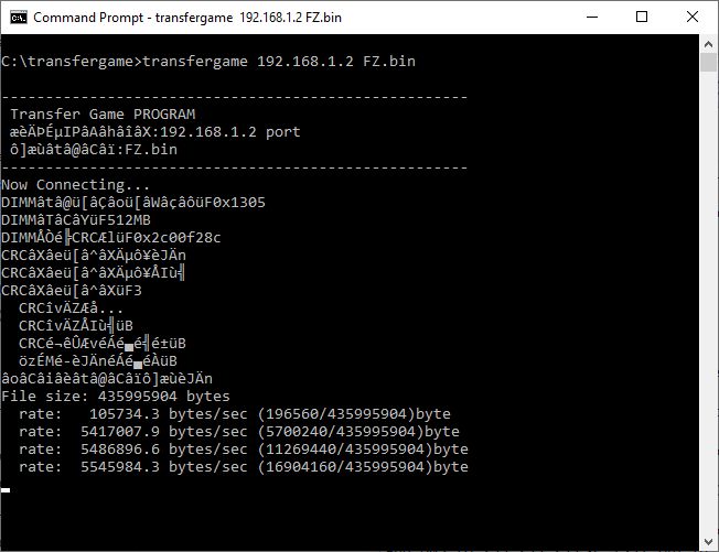

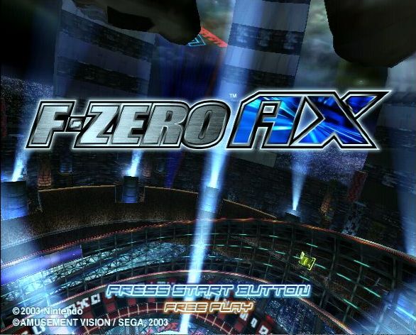

Let's try netbooting a game. Download a Triforce game from the Mega resource posted above. Since I'm going to be running F-Zero, that's what I downloaded (FZeroAx.rar). Extract, then put in the same folder as transfergame. Type 'transfergame.exe 192.168.1.2 FZ.bin', where FZ.bin is the name of the game image you're uploading.
After loading, the game will boot up. For me, F-Zero booted up to a network check. That's good enough for me!

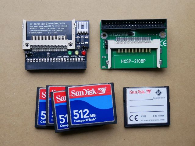

You need a compatible CF card, an IDE to CF adapter and a USB CF adapter. Pictured are the IDE to CF adapters and the cards I have tested working.

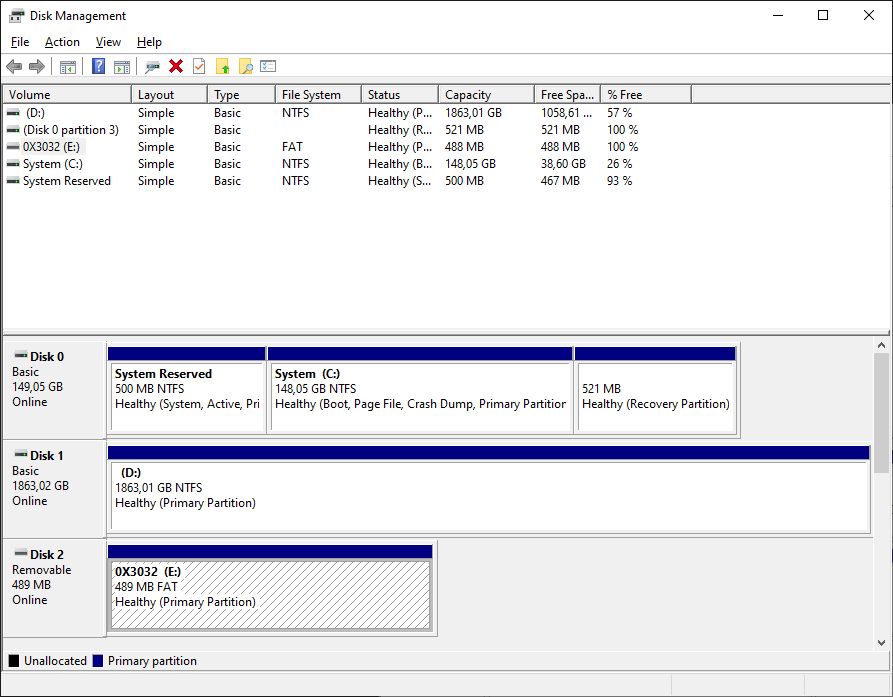

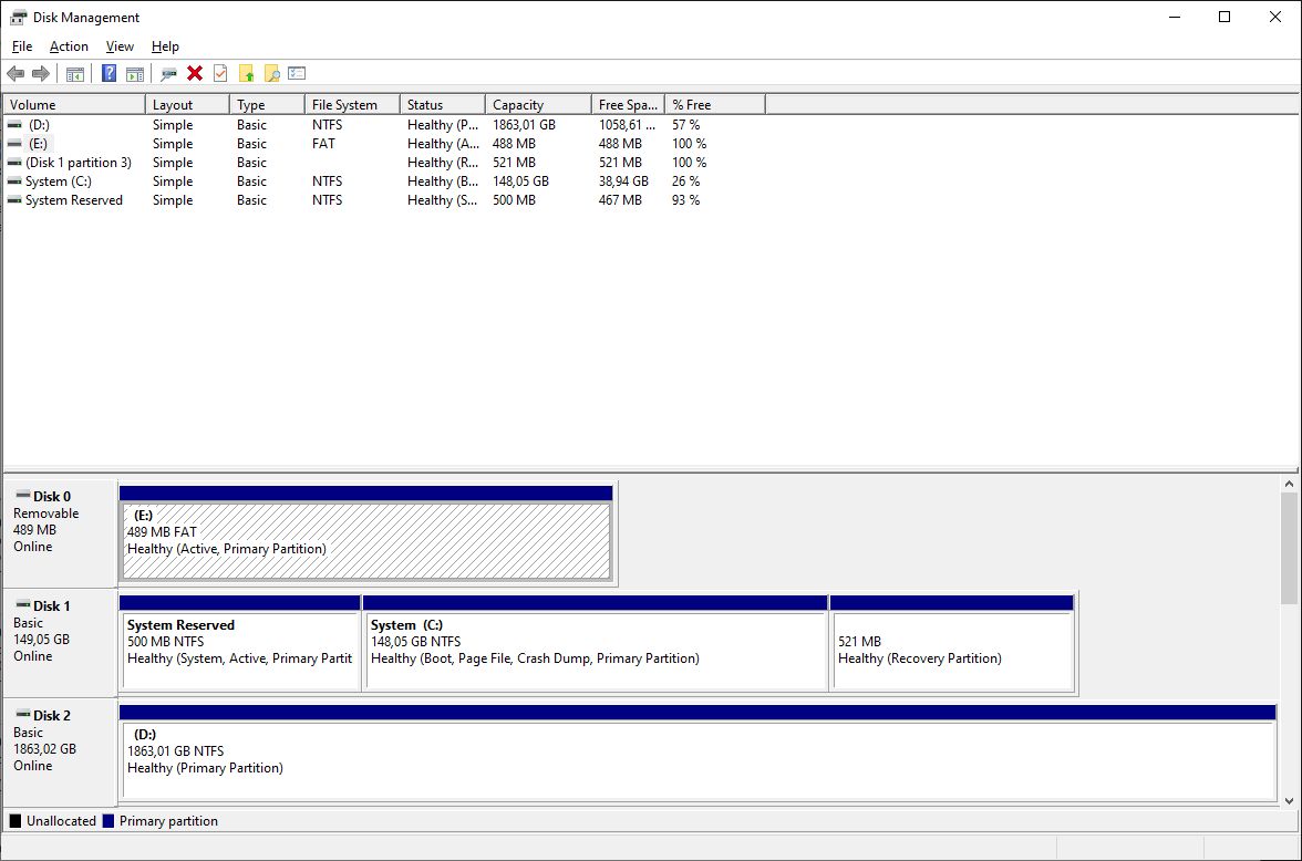

Open up disk management (diskmgmt). For me, disk management will show the CF card as a removable drive as Disk 0.

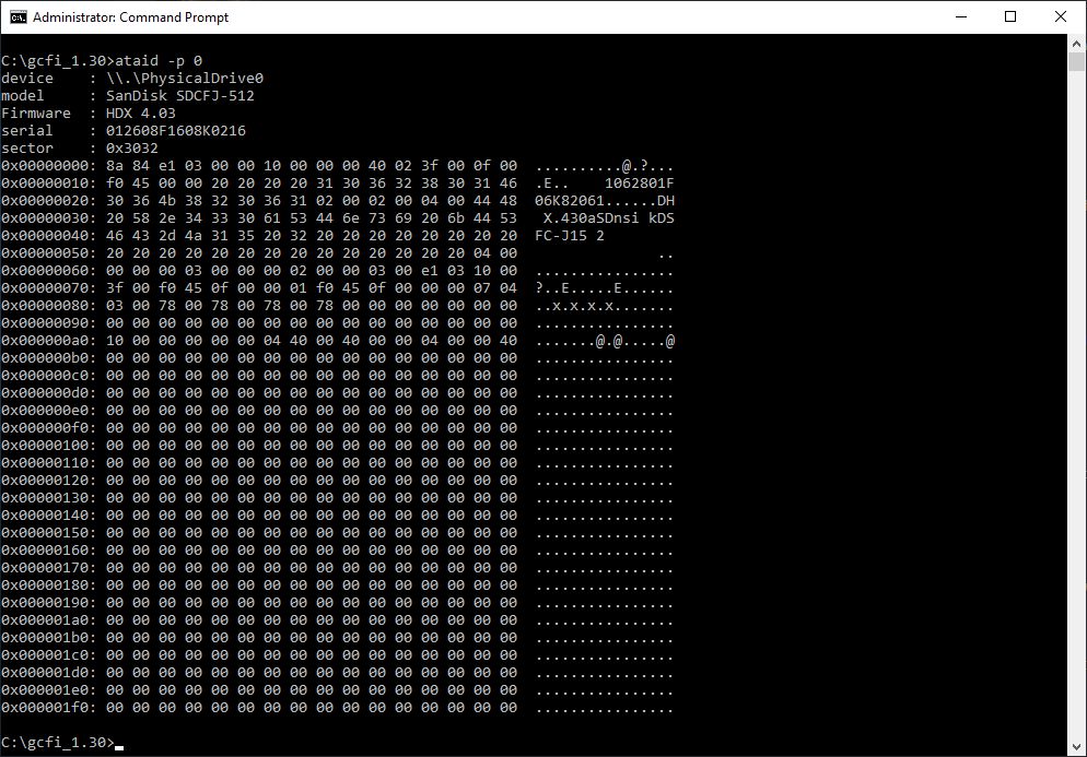

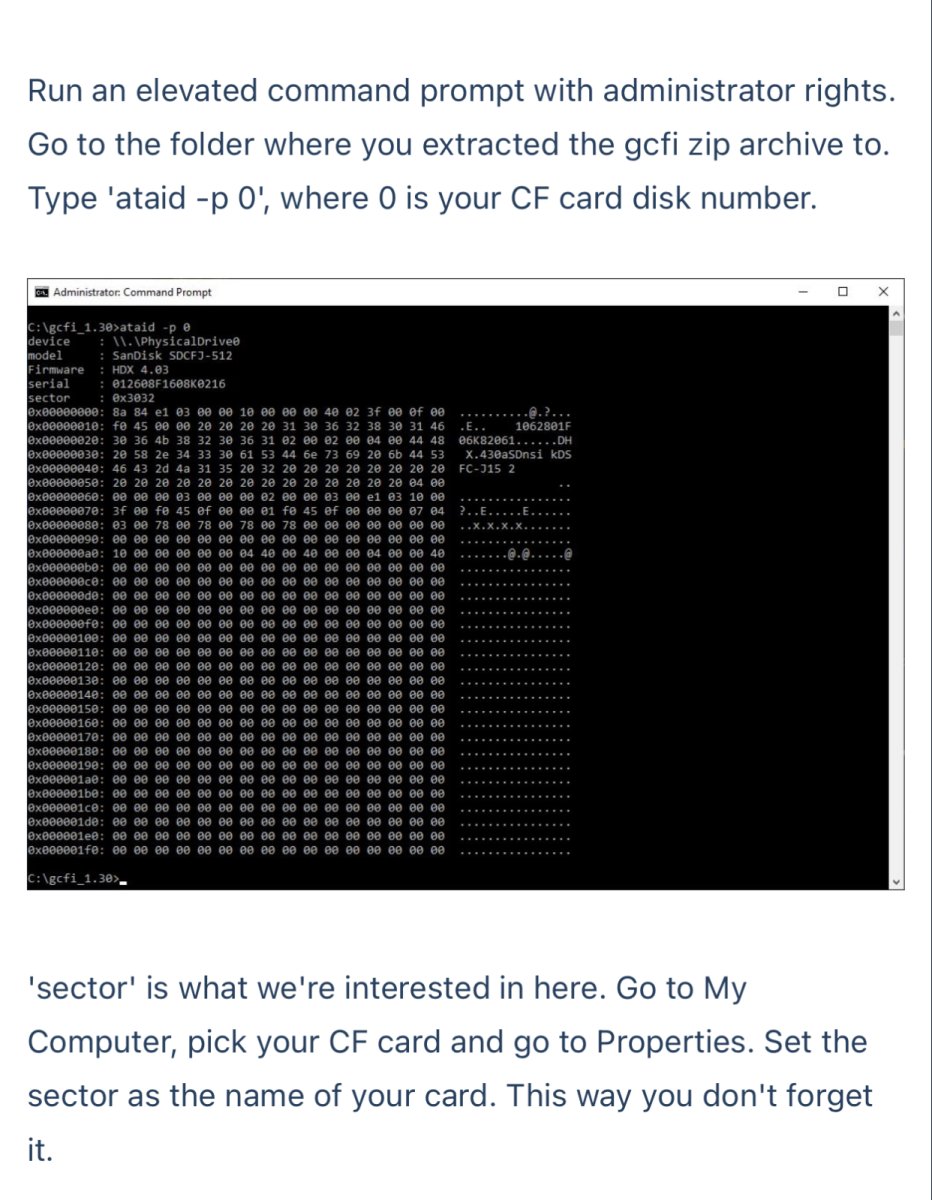

Run an elevated command prompt with administrator rights. Go to the folder where you extracted the gcfi zip archive to. Type 'ataid -p 0', where 0 is your CF card disk number.

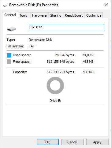

'sector' is what we're interested in here. Go to My Computer, pick your CF card and go to Properties. Set the sector as the name of your card. This way you don't forget it.

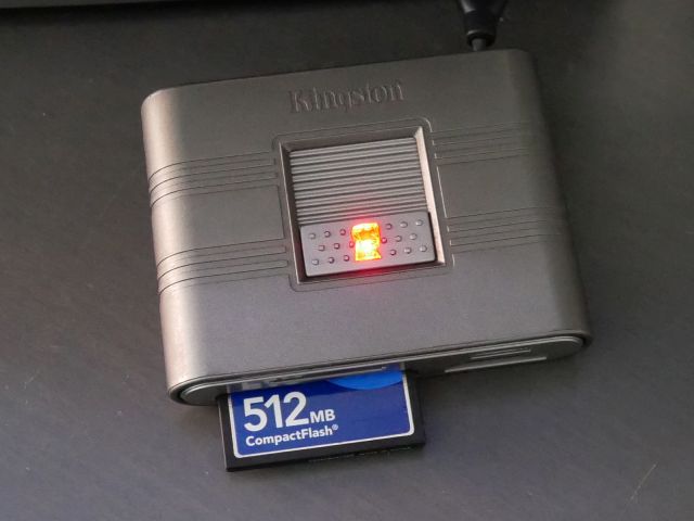

On Windows 10 I couldn't write the Triforce game image to the card with the IDE to CF adapter. It would throw an error. It's some Windows security thing. This is where you will need an USB adapter. Remove the CF card from the IDE adapter. Reboot your computer (I had issues when I didn't). Put the CF in the USB adapter
Open up Disk Management again. For me, the CF card is mounted as E:

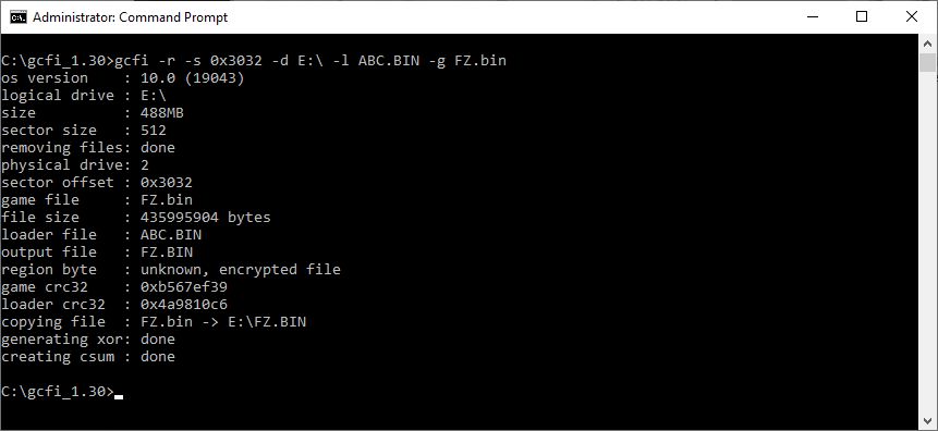

Move your Triforce game image to the gcfi folder. Type 'gcfi -r -s 0x3032 -d E:\ -l ABC.BIN -g FZ.bin', where 0x3032 is the offset sector of your card, E:\ is your drive and FZ.bin is the name of your game image.
If it throws an error about it not containing a valid F16 boot sector, type the same thing as before and put a '-W' modifier at the end. Format your card to FAT. Then try again without '-W'.

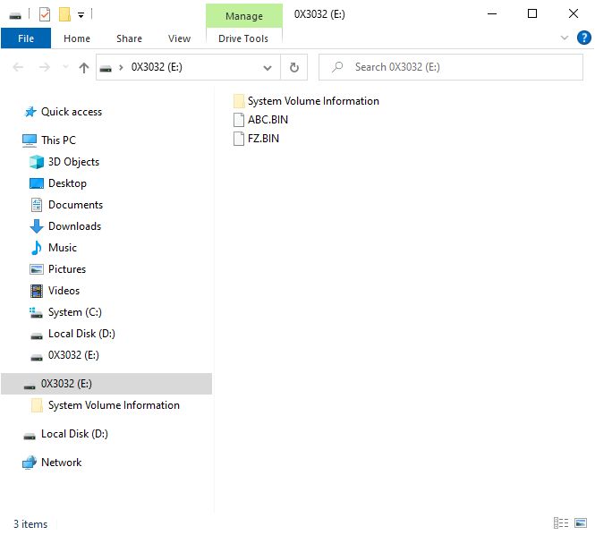

After it's done, your drive should look like this

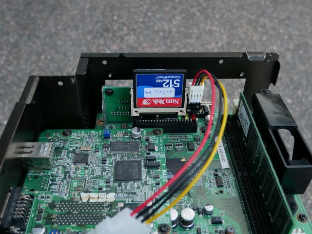

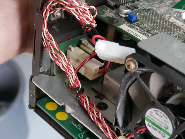

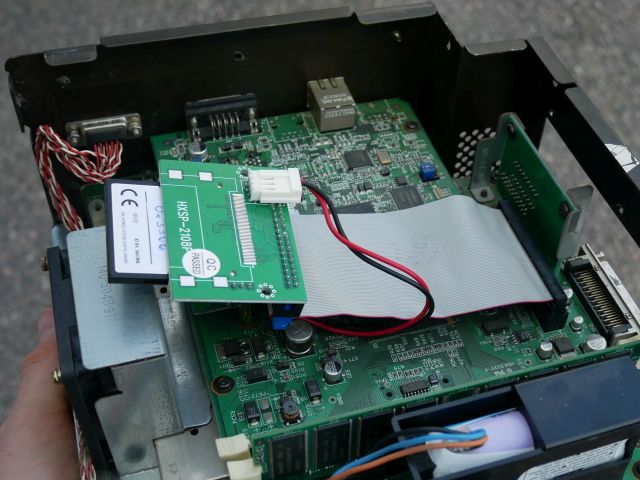

Take your IDE to CF adapter and plug it in your Triforce. You will need to power it. There's an unused header that you can use for this. It's next to where you plug in the fan. The connector series is Mini-Universal MATE-N-LOK. The exact connector you need is a 172167-1, and you also need two female pins, 794137-1.
Pinout is as follows
1 - +12V
2 - GND
3 - GND
4 - +5V
Here's the adapter I made plugged in
Flip the second dip on dipswitch SW1 back to OFF (for DRIVE). Boot up your cab.
It should start loading your game into memory. If not, double check the wiring you made for the power, try a different card, then a different adapter and finally get a new PIC. If it's throwing an error after loading, try a different game image.
The problem with the IDE to CF adapter that has the female IDE header on it is that the card sticks out, you can't get the top cover back on anymore
So I switched to a different adapter that has a male IDE connector and used a 10cm IDE cable
It's perfect. Put some tape over the back side so it doesn't short on the underside of the cover.
Job done.

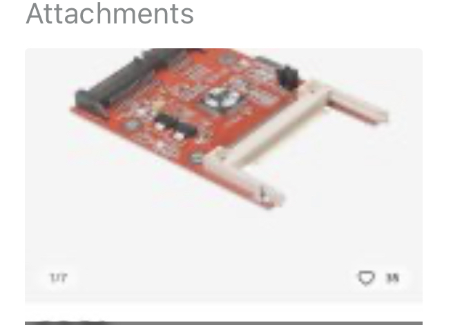

Has anyone tested other devices like DOMs, IDE to SD/SATA/mSATA adapters in their Triforce systems?
I received cf/sata but win7 dont sea this device (((
