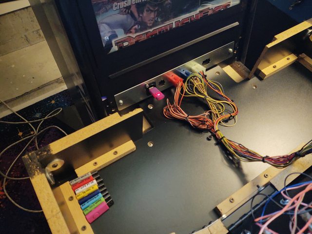

I made some modifications / updates to the button and stick atomiswave cab and I figured I would share them with everyone.

Lastly, I was getting tired of having to fidget with the WiFi every time I wanted to play a game so I swapped from the NetBoot to a USB Boot set up.
This uses an Orange Pi (a cousin to a Raspberry Pi) to boot off an USB stick similiar to how the compact flash works.
It skips all the hassle of logging onto the wifi built into the pi, choosing a game, and then booting a game. All you have to do is stick a thumb drive with a single game loaded on it and boot. No muss no fuss.
I drilled a hole big enough for the USB connector fitting in the control panel. I think it looks pretty clean and it's also pretty convienient. I bought a whole bunch of 512mb USB thumb drives for cheap and I am working on loading the games onto them that I would play. I am leaving a couple blank to change to use as swap drives for those games I don't play as much.
