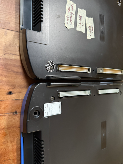

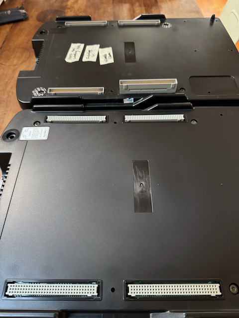

Asia connectors are exactly inverted from usa.
So a board connectors on b and b on a with one oddball length one.

Can confirm - one oddball length one AND the other three exactly inverted
Asia = top, USA = bottom in these photos
That being the case, you DO have to change all the connectors, 400 pins + 400 more pins for donors, + 400 pins to solder back on.
