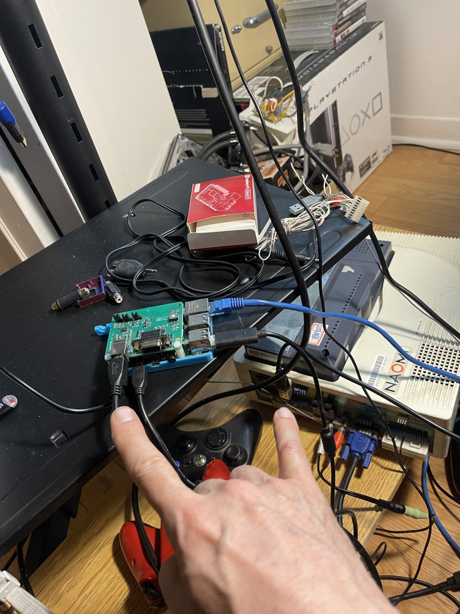

I still don't understand. Maybe my translation is wrong and interfered by hat. I don't know if hat is openjvs hat? In addition, I don’t know which interface USB tube B is.
I think what you said is very detailed, but my translation is not accurate, and I don’t dare to connect the wires at will. I once repaired the PS2 network card and burned out the network card function on the PS2 motherboard. I changed the PS1 to a 213 optical drive and burned the motherboard. Now I am afraid that something will burn out again.

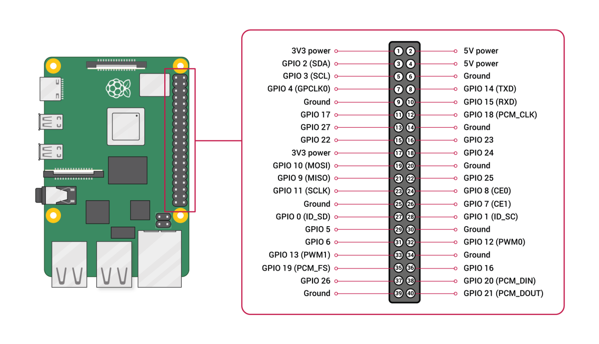

Please help me teach me the wiring diagram based on this picture.

I understand, a picture is worth a thousand words.
1. Insert the 40-pin female port of OpenJVS into the 40-pin male port of Raspberry Pi 4, and overlap the two boards.
2. The 4 USB ports on the Raspberry Pi can be plugged into wired controllers, joysticks, and racing steering wheel hardware devices.
3. The hat interface on OpenJVS is connected to the USB interface of namco system 256 arcade for wireless Bluetooth control of namco system 256 arcade.

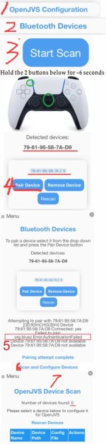

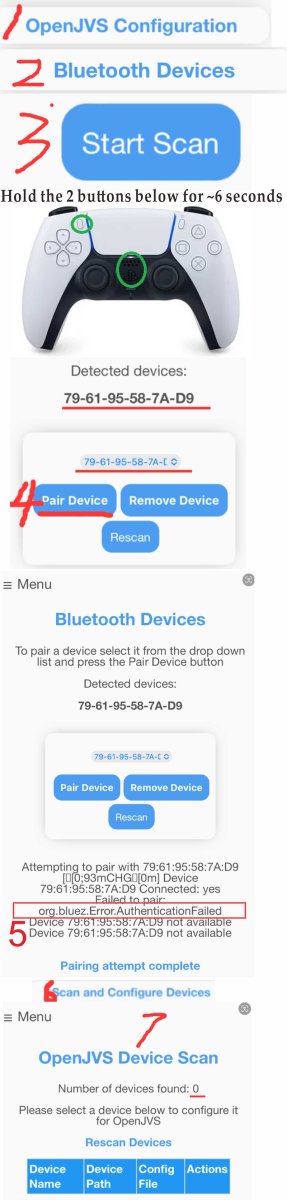

Although I understood this step, starting from step 5, I couldn't connect to Bluetooth and couldn't detect or recognize my Bluetooth controller.

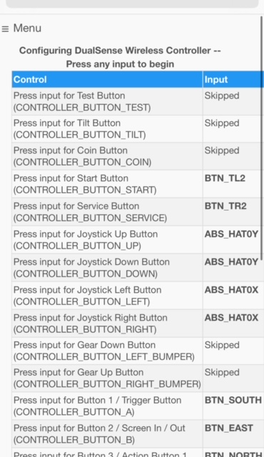

Looks like your dualsense was not in discovery mode.
Try again.
Or perhaps you have a wired controller to try? it's a little easier for a first try ;)

Is it because I didn’t pair successfully because I need to do the above operations?
You just pasted the quick start from https://github.com/OpenJVS/OpenJVS/blob/master/docs/hat-quickstart.md
You do not need to play with that with the wipi image, it's already configured for you.

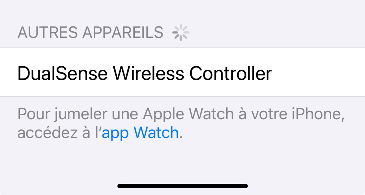

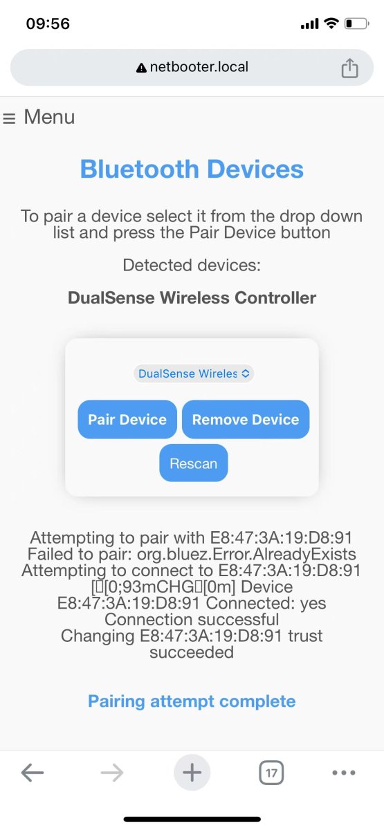

Did you try again to put the dual sense in discovery mode? with the dual sense off, press both buttons and it should flash blue like this:
When in discovery mode, you should be able to see it with any bluetooth device, exemple my iphone sees it :
Can your phone see it?!

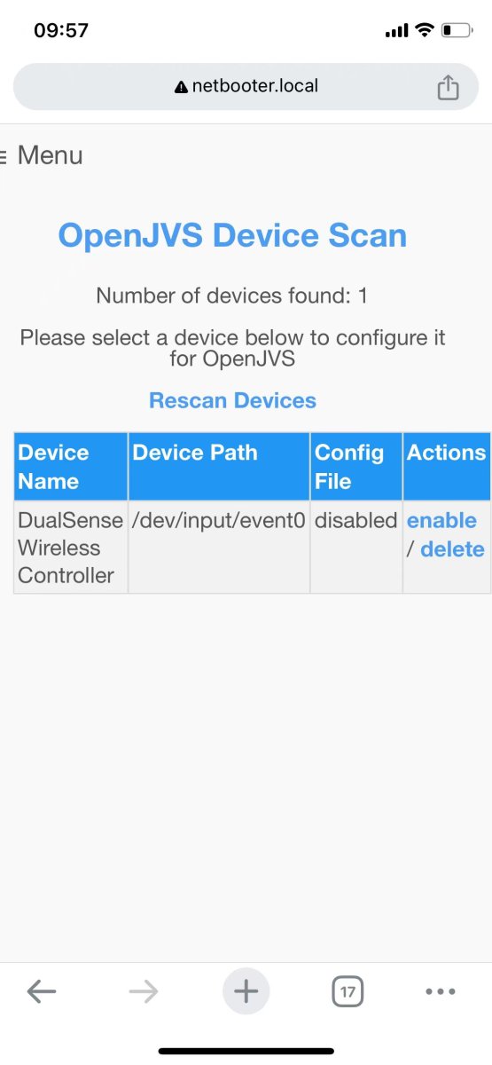

My ps5 controller has been recognized and connected, and it is displayed, but I don’t know how to set the key mapping.Steps 6 and 7 above cannot be performed

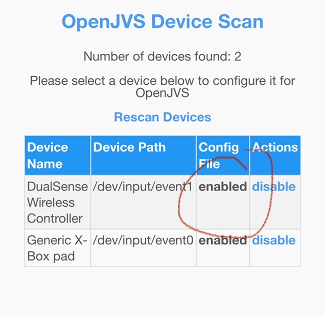

hey congratulations on getting it recognized! :)

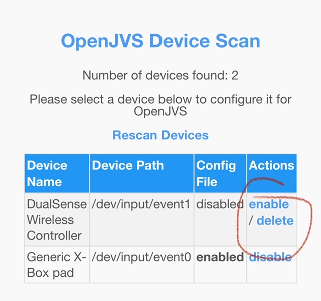

You are almost there but you have disabled the config file.
Let's try again:

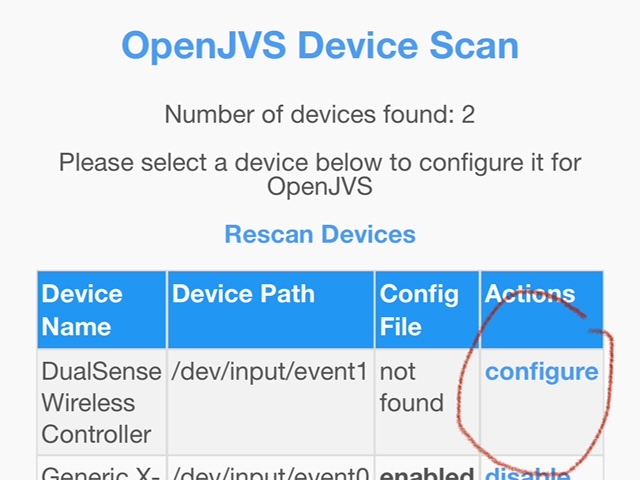

Go here and hit DELETE

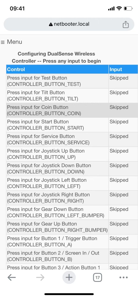

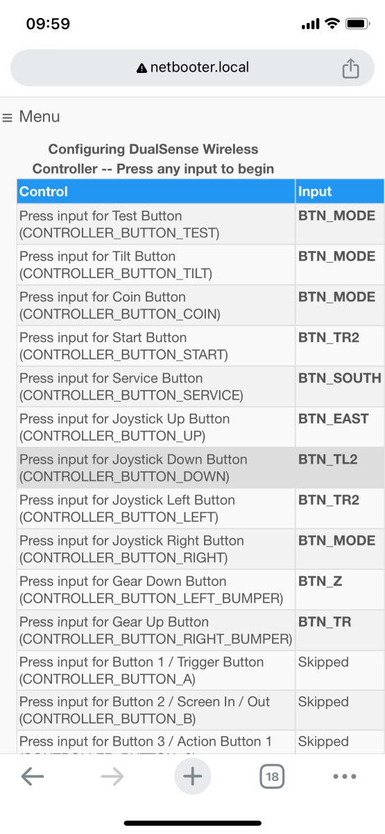

You should now have this. Go and hit configure. now the second you do, the input assignment starts (with the test button first)
here I missed the input for test since the screen is not displayed before it times out and skips it ... and goes to the next input.
when it does, hit the proper button and it should assign it
and finally you should have this
Give it a try !

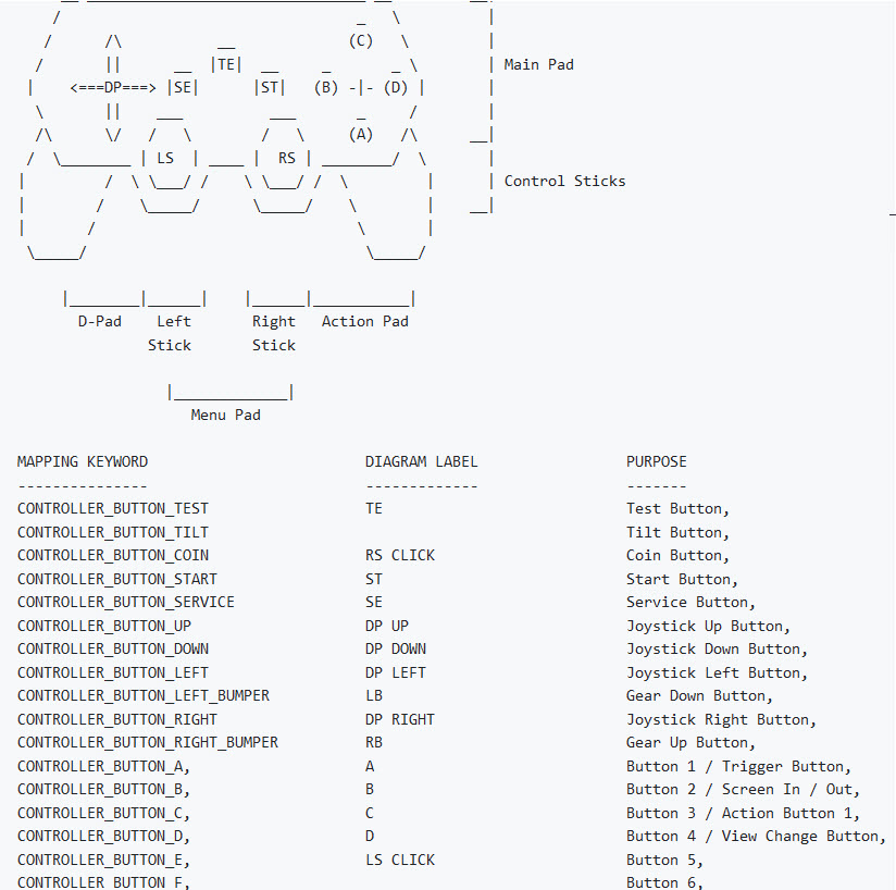

This is the key mapping I set up, but there are a few issues
1. It is easy to miss when setting the key mapping or the same key is repeated to the next key.
2. How should I save or operate it after setting it up? Because after I set it up, there is still no response, that is, I still cannot use the key positions I just set.
@Mrhide

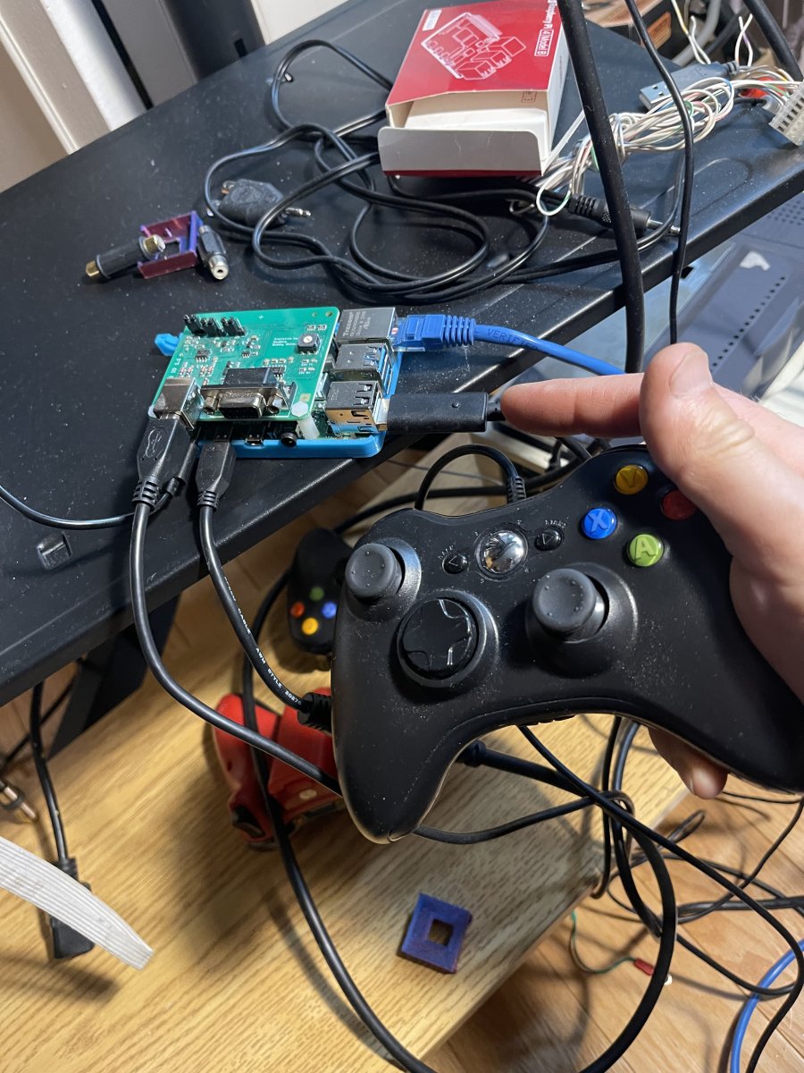

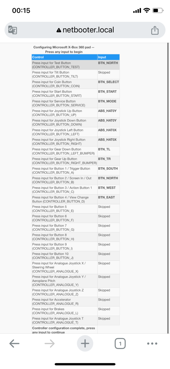

I am now using an XBOX360 wired controller to connect. There is no problem with the direction buttons, coin insertion, start, and test. The only problem is that the button mapping is wrong.
X=Button2
Y=Button5(----)
A=Button1
B=Button3
I hope to adjust:
X=Button1
Y=Button2
A=Button3
B=Button4
@andymage : you need to go in openjvs and hit configure for that device and do your mapping keeping in mind this order:
The order is A,X,Y,B for button 1,2,3,4
How do I save the settings after mapping?
My current situation is that after setting up, the key mapping is in the same order as before setting up. I have mapped A, X, Y, B to 1, 2, 3, 4.
