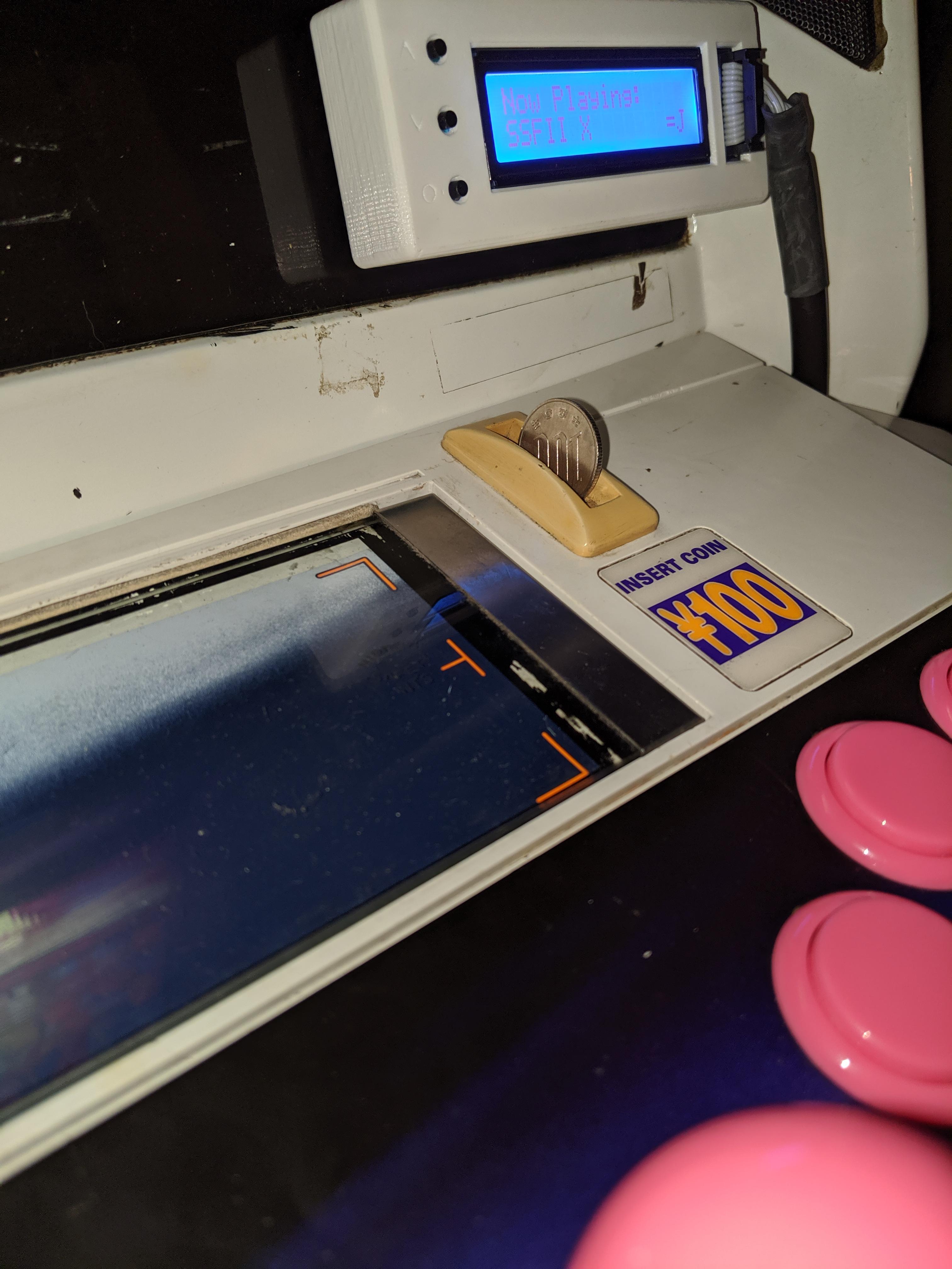

Has anyone ever tried to extend the inside lcd connector to the exterior of the case for a breakaway cable? I run my lcd cable through a keyhole in my cab to I can mount it to the bezel of my machine like in the image I've attached.
Looking at this image above, has anyone tried to run an extension from inside the case to the coin counter slot his ribbon cable comes out of so they could use it as a breaking point to swap cables? I'm planning on using my board at tournaments soon and was looking for an easier option that doesn't involve running the cable in and out of my cab every time I move it.
