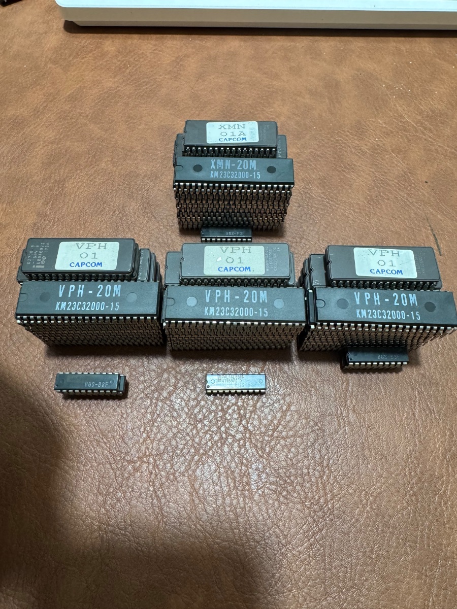

If you need original ROMs, I can sell them. I’ve tested them and they all work. I have several B boards with DL1927 and DL1827 that are broken.
