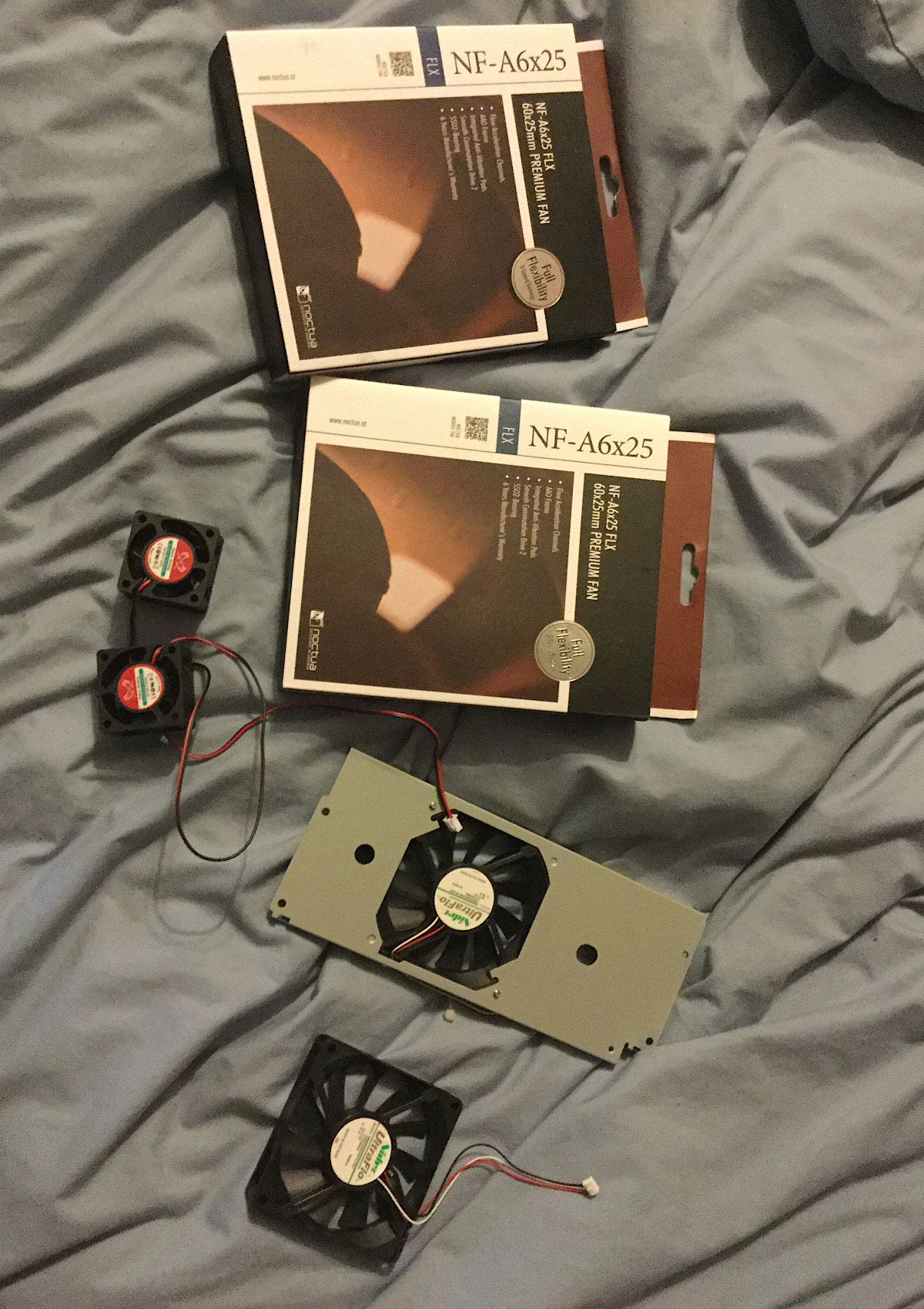

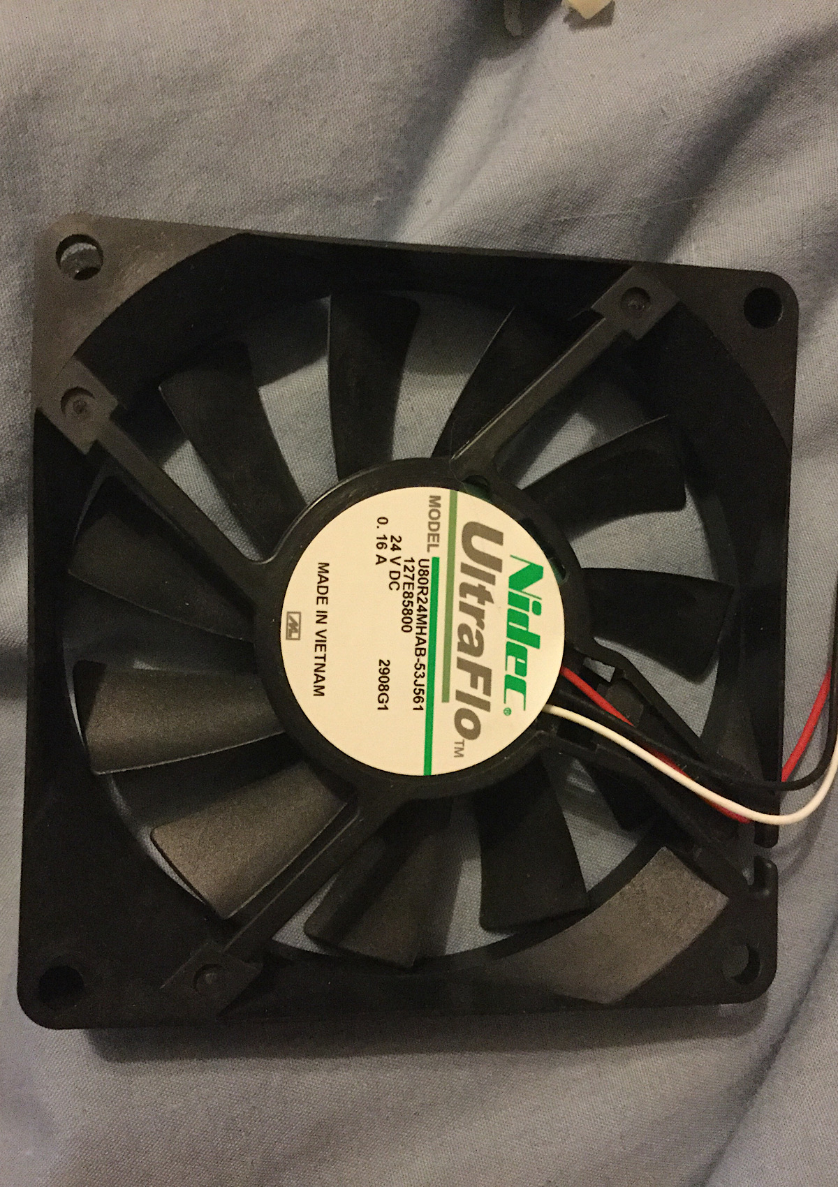

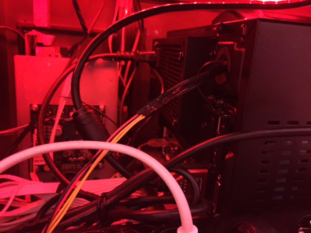

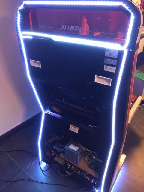

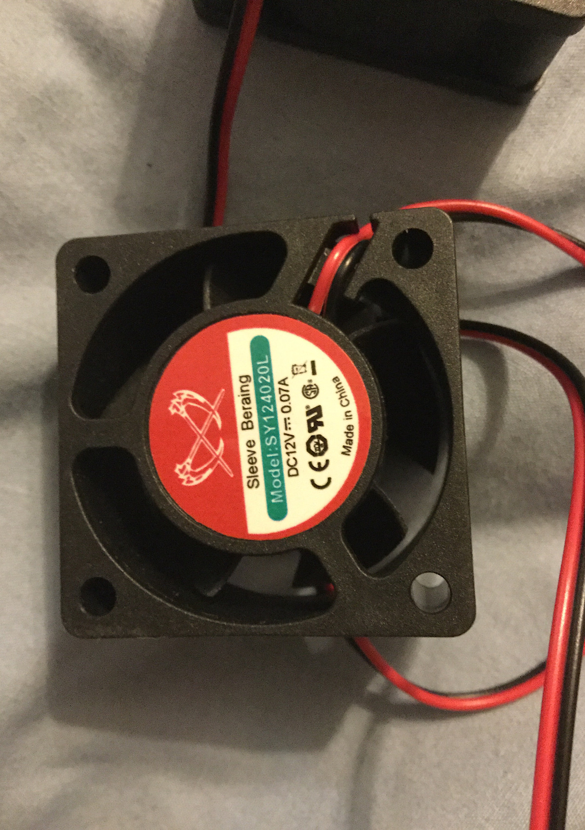

I’m going forward today with project shut up vewlix. My cab needs 2x 12v 60mm and 2x 24v 80mm. The 80mm are from some printer so a total crapshoot, but they were cheap as far as fans of this type go. The small fans are for the Taito x2 psu fans. I will report back once I install these things. I already did the cpu and case fan on the Taito x2.
Following up. On my cab those 60mm fans are the culprit. I replaced those with the noctua ones and I put one of their little adapters in line to slow it down some. I probably didn’t even need to do that because I can’t even hear them, but they seem to be pushing a decent amount of air. Now the loudest fans in the back are the monitor fans, but they really are not that bad with the back on. So I don’t think I’ll bother replacing them.
So I have 2 spare 24v 80mm fans. I found a 24v power supply and plugged one in and it was not too bad but I think it is equivalent to what I would be replacing. I tried with one of those noctua Low noise adapters in line and that made it really quiet, but I’m assuming it would trip the warning. I might mess with the monitor fans if I need to take the monitor out for anything but for now i am perfectly fine with the noise of the cab and the Taito x2. Still louder than my other cabs but it is negligible.
For the x2 the main culprit was the case fan. I replaced with a better one and slowed it down. I also replaced the cpu and psu fans but I don’t think that made a huge difference.
after leaving the cab on for a few hours the left fan is blowing cold, so i'll leave that alone, the right fan is blowing warm, not crazy or anything but I think those monitor fans do need more air pushed out of the cab, so i'll remove the fan slow down thing from that one and I think I'm done.
