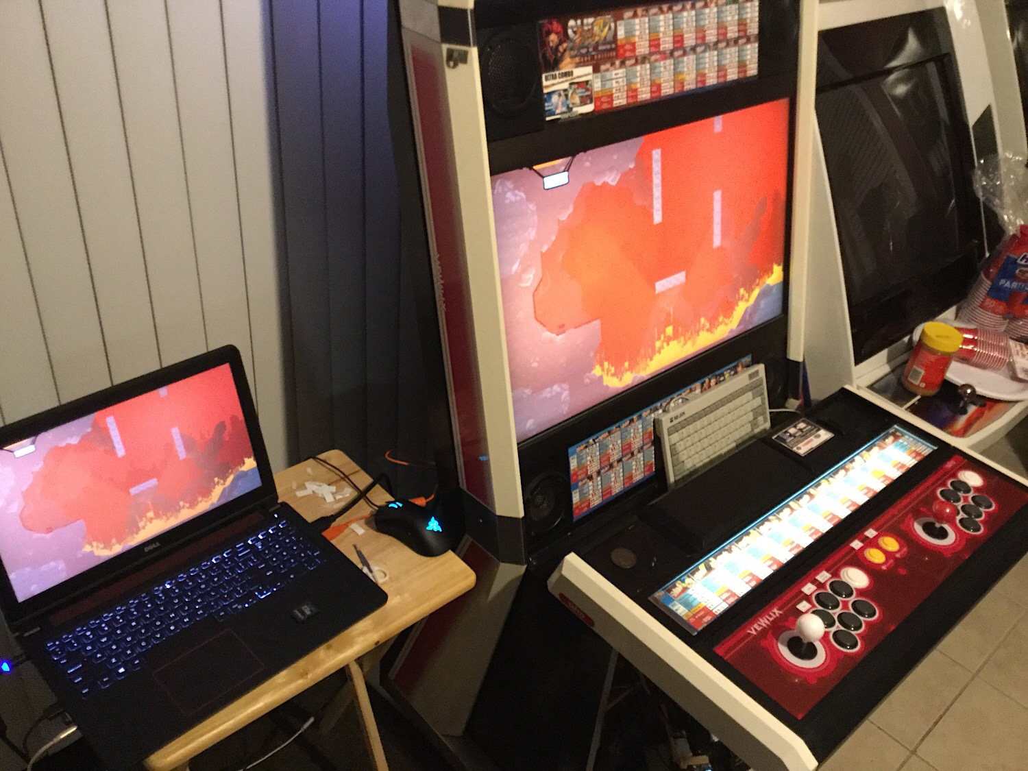

No problem. Got the javpac2 hooked up today. Works great. I like how the config is on a sd card. Would be cool to be able to change between config files but I’ll probably only have a few so can just have a few cards. Meat boy works great. Does anyone know if button 7 on a vewlix cab is available somehow? I think my cab came with it not wired. I haven’t opened the panel in a while.
One minor annoyance is the JVS error when I switch usb from the tx2 to my laptop and the x2 keeps rebooting. To solve that I plan to put a power switch in the cab Just on the x2 and just leave that off if I plan to use my laptop with the cab.

Javpac basically turns the controls into keypresses. I have a usb switch, minijack audio switch, and a dvi switch in the cab to switch everything from x2 to cables I have coming out the back to connect the laptop. I suppose I could use another interface to get the 2 extra buttons out to the laptop. Not sure if I’ll bother. 6 buttons per player is probably get enough for what I’ll play on the cab.
One thing I noticed using the headphone out on my laptop for audio was it sounded pretty bad through the vewlix speakers. I put a small graphic eq unit before the speakers and that helped quite a bit. I had to cut some bass frequencies. The super meat boy soundtrack is bass heavy so might not be a problem for other games. I’d prefer some sort of eq unit with simple bass and treble knobs but I don’t know of anything cheap like that. I also noticed some noise that sounded like interference. I might use a usb audio interface instead of the headphone out which should clean up the audio. I could eq in Windows somehow but I generally prefer hardware audio adjustments and like the idea of the extra control for the x2 audio also.
