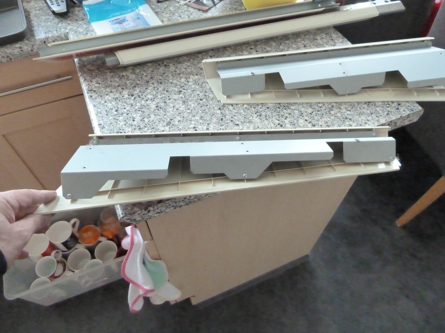

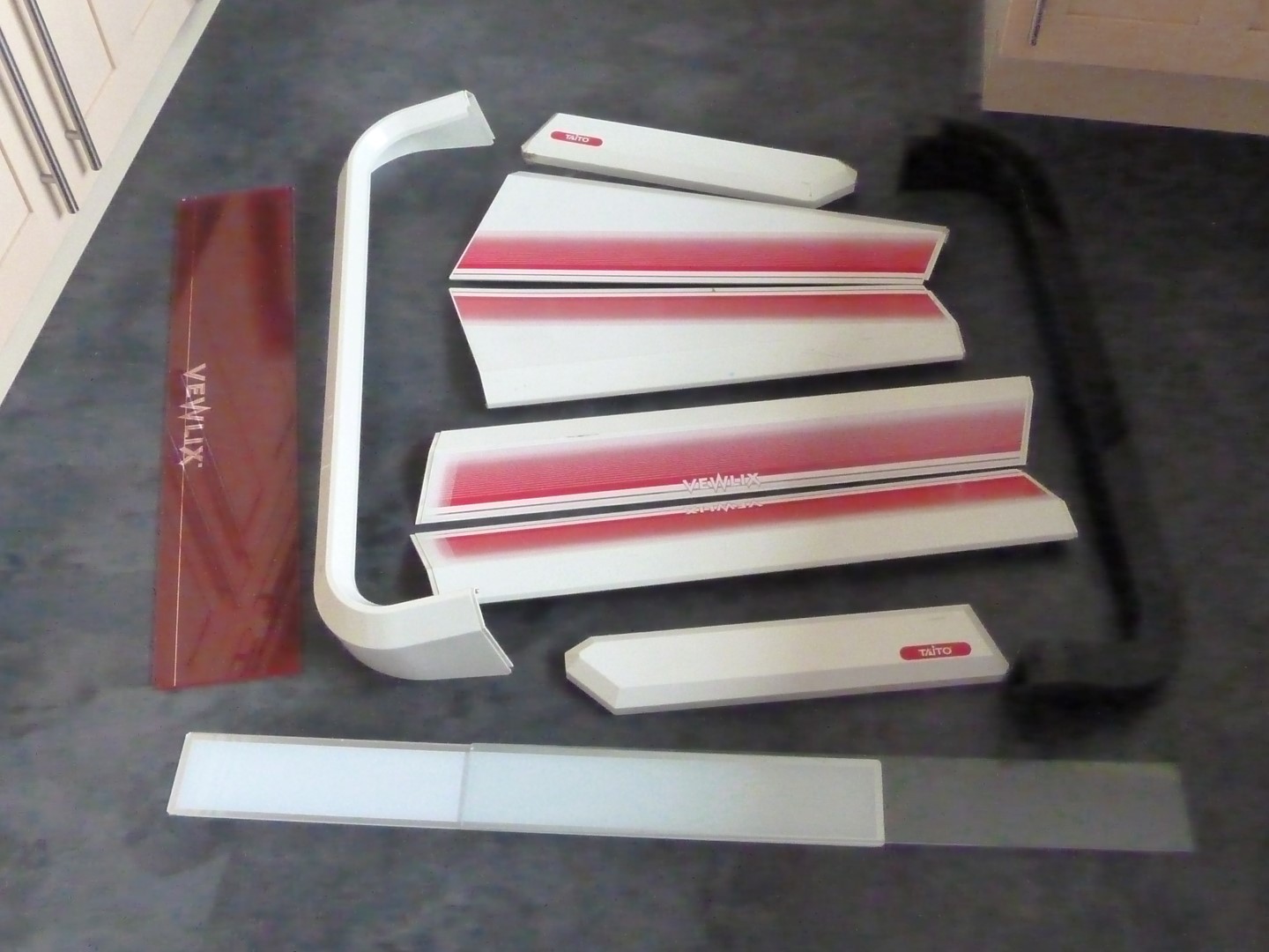

Cleaning...
The side-trim has metal brackets fastened inside, carefully undo the screws and scrub the panels & brackets clean with plenty of hot soapy water. remove any marks with magic eraser (you will need to re-polish the panels if you do). when you refit the screws DO NOT OVER-TIGHTEN them as the plastic pillars they fasten into will break!
