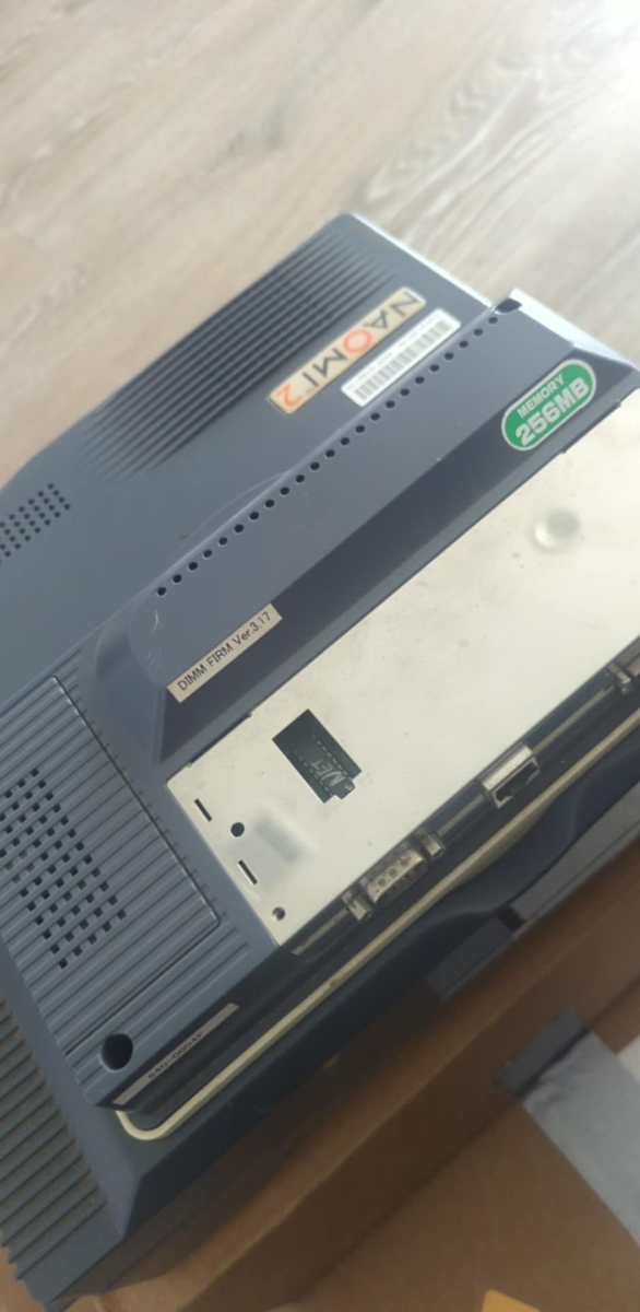

Greetings from TX, recently acquired a Naomi 2 motherboard with netdimm set-up. Wanted to throw this setup into my Sega blast city but I've read the Naomi 2 needs own power supply. If someone could point me in the right direction to get this project going please. I need PSU, Sega IO board, any cables to connect to JVS cab. Thanks peeps ✊🏼

If your blast has a 001 loom then you don’t need a dedicated psu. If you don’t then you could use a Sun psu, or an Atx psu with an adapter. You’ll need ether a Sega I/o or capcom I/o. People say the capcom I/o adds 1 frame of lag although I run it and never noticed. You’ll need a printer style usb cable for the controls. Crossover cable for the net dimm to pi. Do you have a pi for your NetBoot setup? Zero pic?
Thank you for your reply! I'll have to check if it's the 001 loom. I've been seeing that the Sun psu is your safest bet but I've seen a lot of people use atx/adaptor. I do have a printer style USB cable , crossover cable, Sega JVS jamma adaptor and the pi ready to go. I have seen the Sega IO floating around here. 🫡
