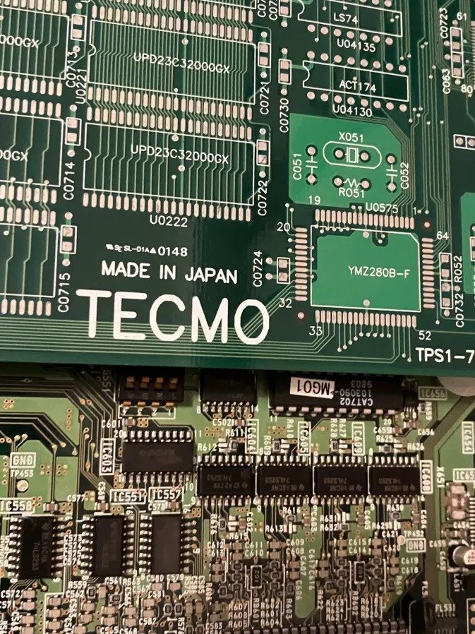

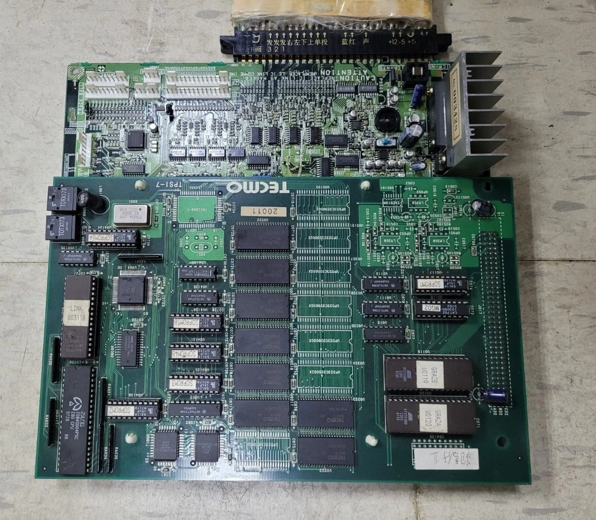

@Psyko-M1 pointed me to this listing:
https://www.ebay.com/itm/147076776973
It's a ZN1 bootleg...
The font / logo is wrong, silkscreen is off (see YMZ unpopulated socket)
Also no bypass capacitors fitted on the roms/chips that are fitted , and no trace of filter caps where they should be.
looks like it was printed last week or something!
Don't fall for this. Hopefully it's not one of my cracked versions
Attached picture of real game, and the bootleg logo
