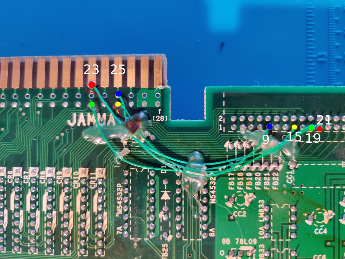

Hi guys, I'm looking at the underside of a CPS2 A board with some work done on it which I don't understand:
As far as I can tell the board works but for one thing: P1 B2 isn't working which isn't shocking at all considering the trace to JAMMA 23 is cut. Does anyone know what this was trying to achieve? Can I break something really bad by reverting it?
EDIT: Was it trying to fix P1 B2 not working? Was it trying to adapt to a broken JAMMA plug through replacing kick-harness buttons?
ugh... that's not a repair. they're remapping buttons 4 and 2 off of the JAMMA edge to the kick connector.
looks like they've also shaved down the side of the Edge Connector too :(
