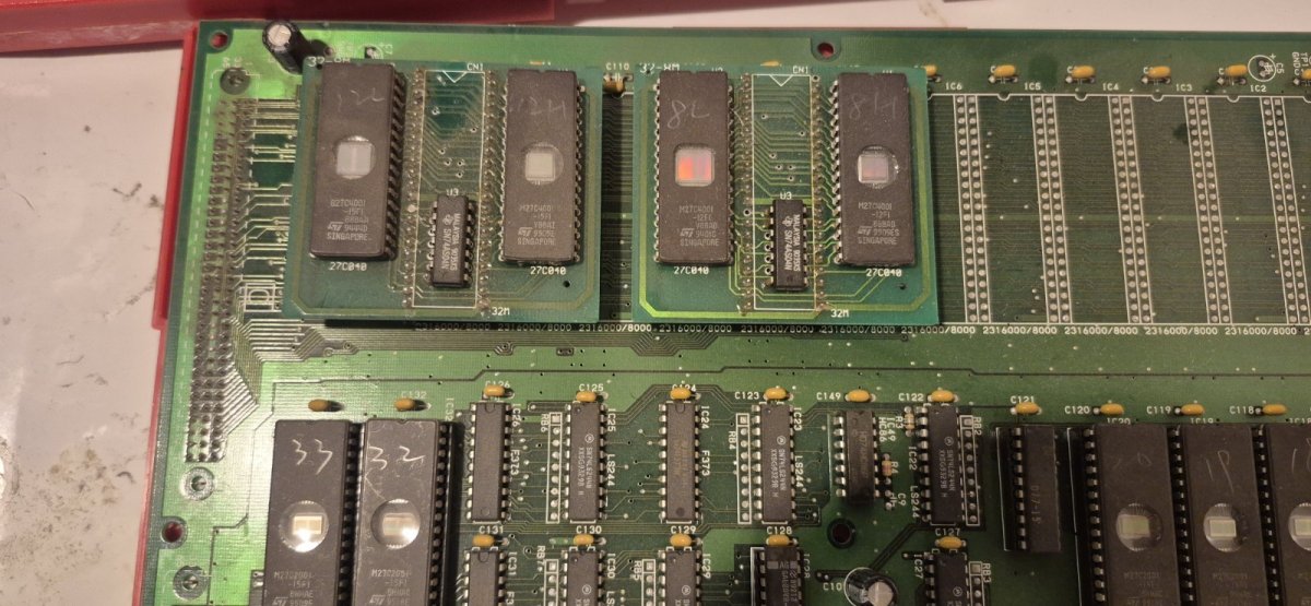

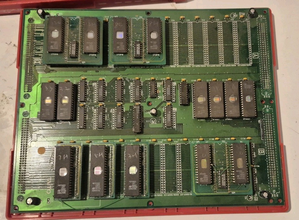

However, I just picked up another cart and, to me, it's just crazy. The amount of effort that went into creating three dual-DIP32 sub-boards (two of which are for dual 27C4001 512kb chips and the other is for dual M27C801 1mb chips) as well as 3 DIP40 sub-boards (all for 27C4002 512KB chips) ,in place of the 27C160 2mb chips that you'd usually expect to find, is INSANE to me.
And all of this, and it's just a bitrotten Puzzle Bobble 2 (which isn't bad, but I wouldn't think it would be all that desirable for this level of effort... it's no Elevator Action II).
I'm thinking this is a vintage bootleg and perhaps 27C160's were cost prohibitive at the time (???), otherwise, I can't fathom the investment into all of the sub-boards.
Anyone else have thoughts on this?
