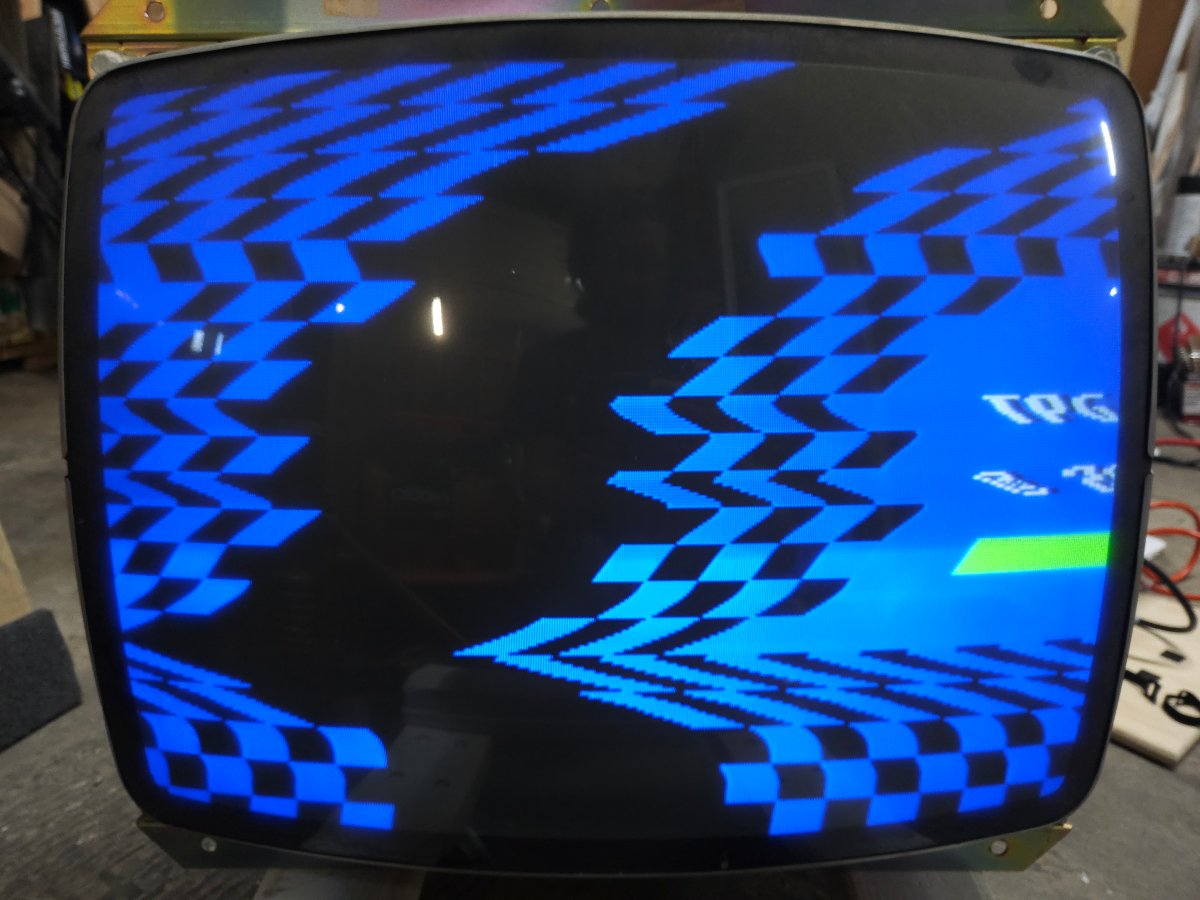

I received this monitor non-working. I finally got it to produce an image, but the image is all wonky. It looks like the whole image is shifted left 50%. Left is on the right, right is on the left, and a black space in the middle.
It's not scrolling, it's all locked in place. Fiddling with the hold pots results in the image attached, at best.
This chassis has one of the weird wafer remote boards with only size and brightness controls. Adjusting horizontal size throws the h-hold out of wack, or flips the image at it's max/min.
Sync is on pin 10, and tying 9 and 10 together changes it a bit, but not much better.
Any ideas?
Any ideas?
