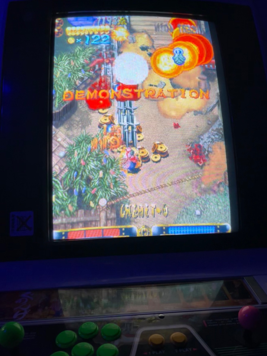

Thank you to everyone who gave advice. I rotated the Astro last night. I put a moving blanket on the ground and set it on its back. I might need to figure out one of the other cabs later to have more than one vertical game in rotation but this is good for trying things out.
