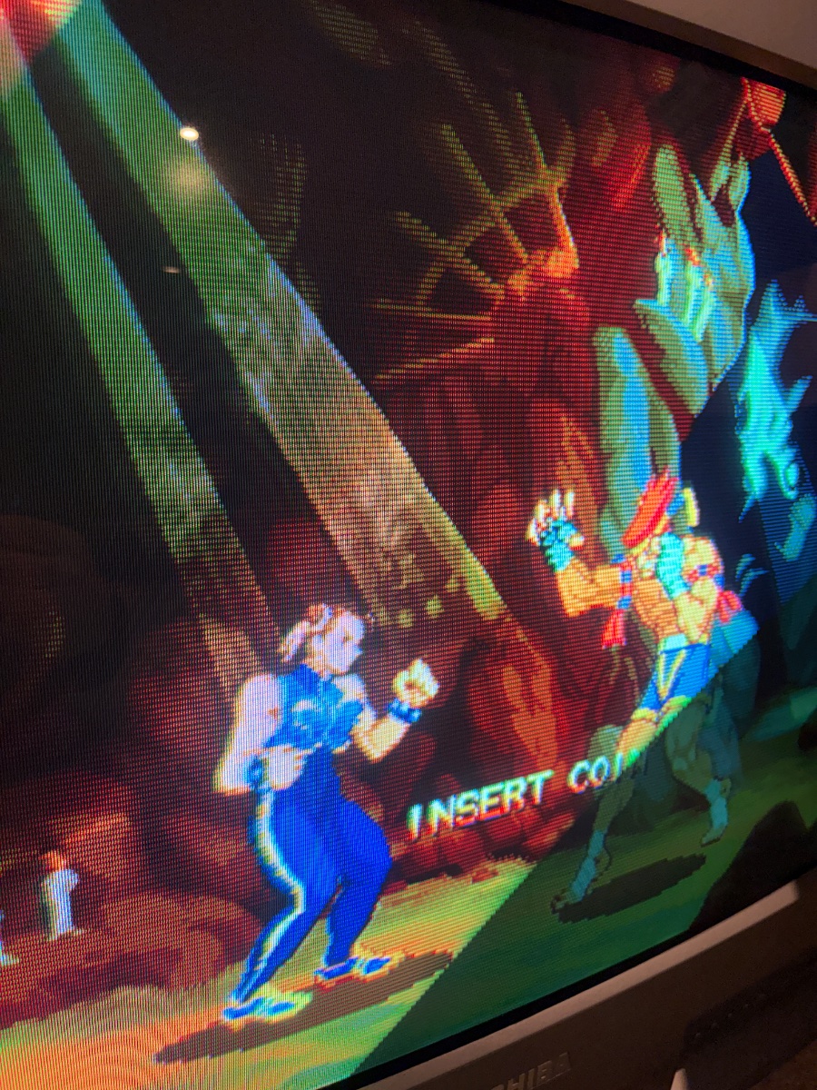

After solving my graphical issue I decided to change the battery. Took all of 3 minutes to change and test voltage but am now greeting with a full white screen on boot.
Boards are de-cased connections are tight just a white screen, no sound.
A quick search suggest white screen is A-B board contact but this isn’t the case here.
Did I wipe the encryption somehow in the 3 minutes it took to replace batter.. time for a infinikey?
Any advice appreciated cheers!

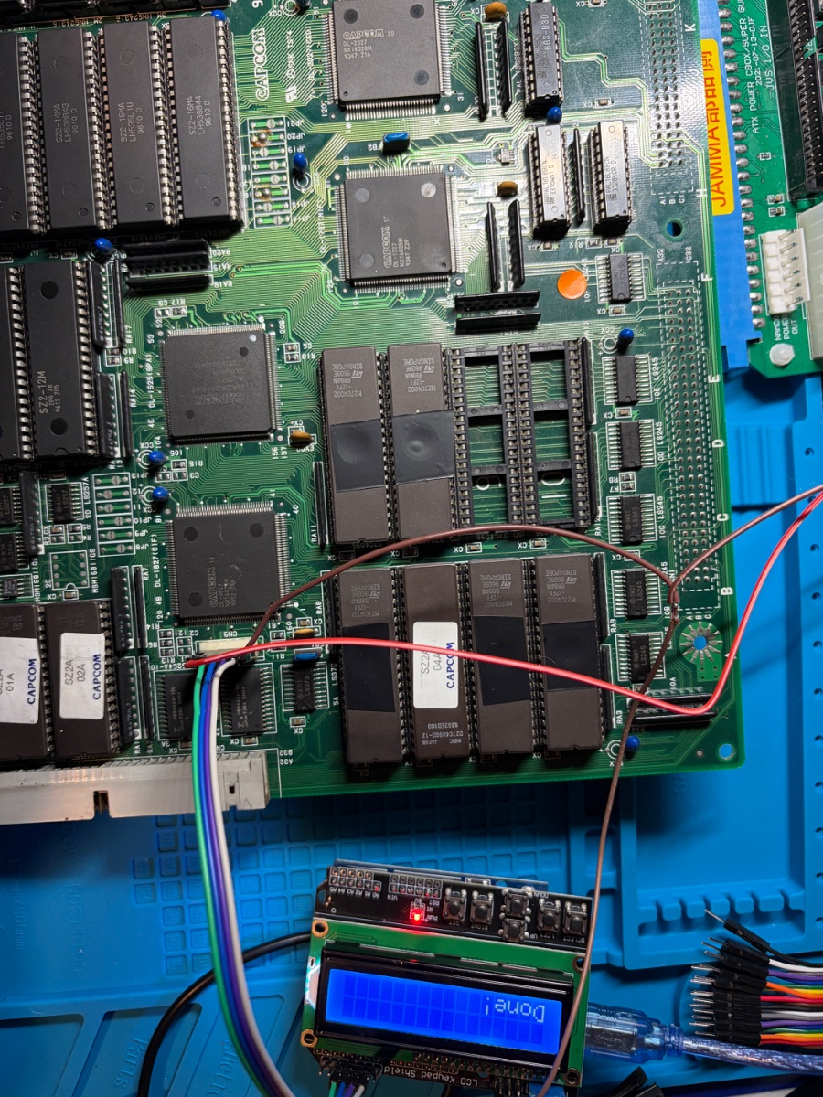

This happened to me once, I had inadvertently shorted the battery contacts by dropping a bit of solder on my board!!
Perhaps something similar may of happened.
$10 on a Arduino and we are back 👍
