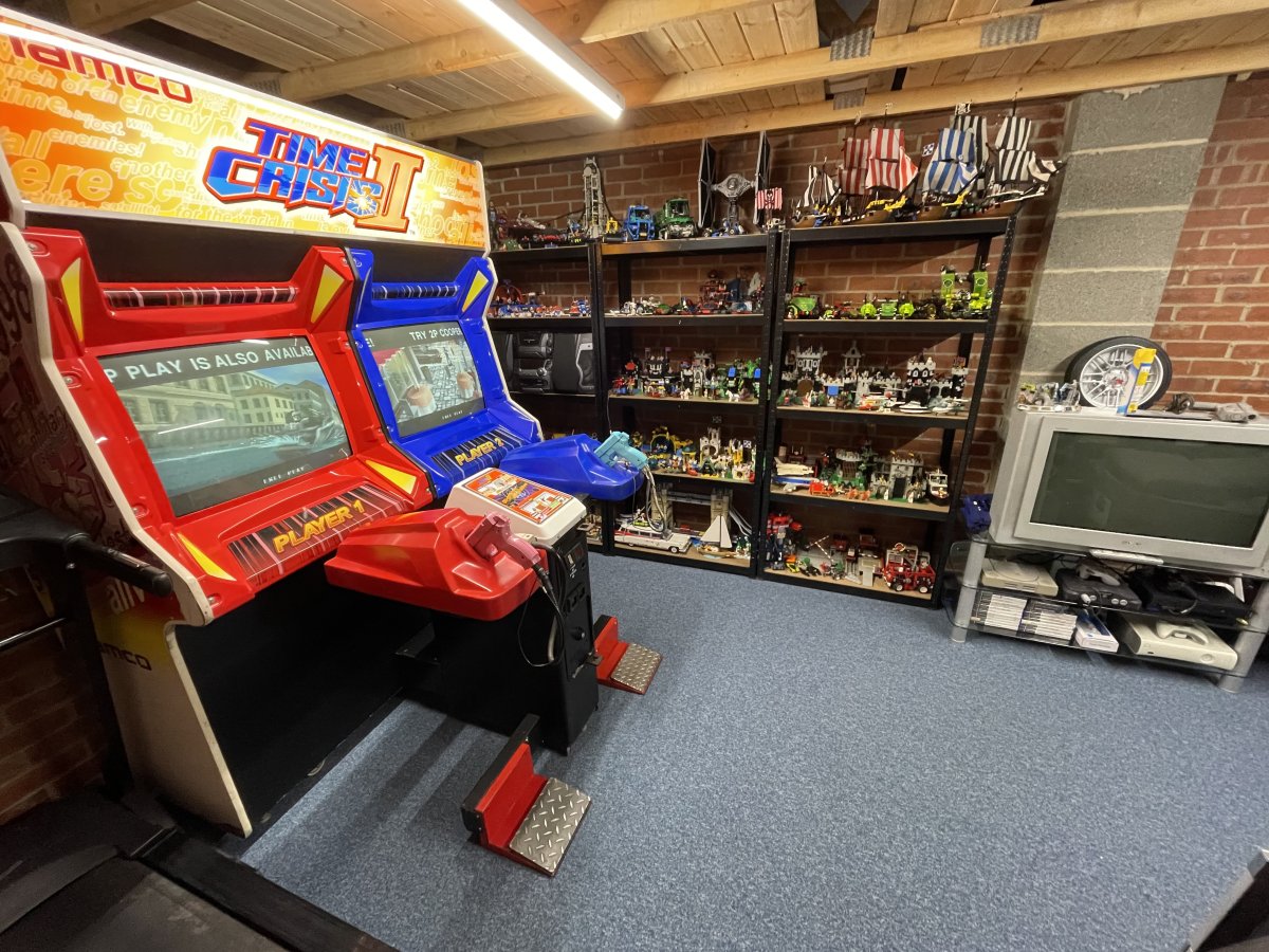

I hope you are well? I recently had an issue with my Time Crisis II dual arcade cabinet and I wondered if anyone had any ideas.
So when I play link play it works absolutely fine no issues at all, solo play on player 2 works perfectly fine again no issues. But if I play solo on player one it gets to the 2nd stage area two and crashes every single time at the same point, it then resets itself, goes back through the checks and boots back up again.
What’s wierd is that when I play linked play using player 1 it gets past that point no issues at all.
Super wierd, can anyone help or have any ideas!
