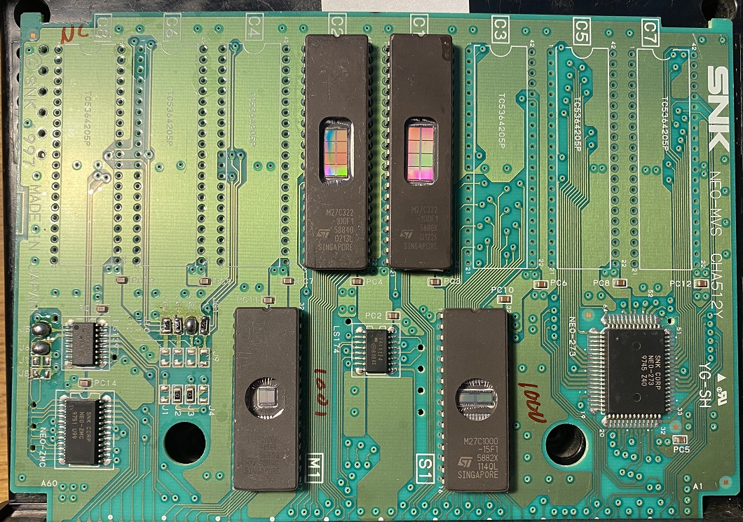

Do I need to do any other wizardry to the windjammers roms when using a PROG BK1 / CHA 512 combo?
The original boards are PROG42G-1 / CHA42G-1.. no interleaving or bitswapparoos?

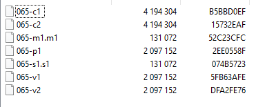

I was thinking just combining the V and C roms like this:
V1 + V2 = V1
V3 + V4 = V2
C1 + C3 = C1
C2 + C4 = C2
