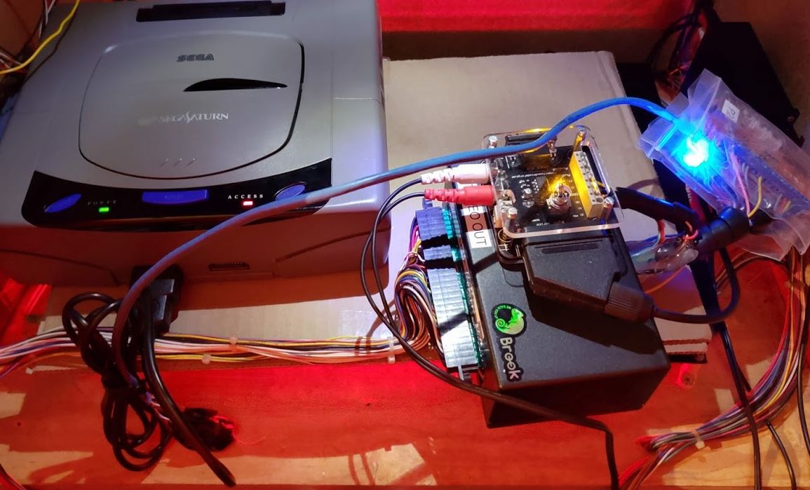

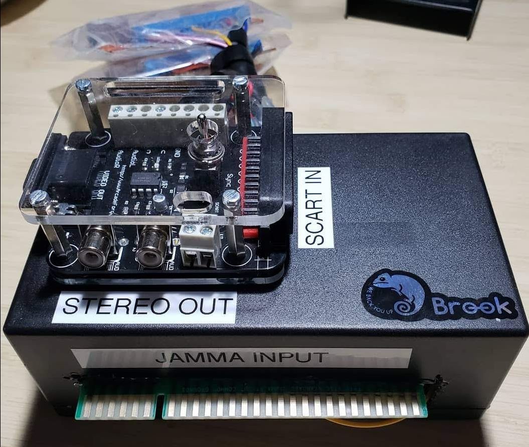

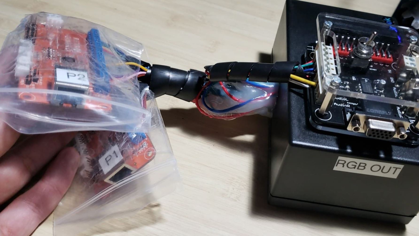

Well, I finally boxed everything up.
Pretty much it's going to stay like this so I can find a better design.
As it stands, I've made it so I can pretty much dismantle it when I need to, but it's cinched together so nothing shorts, or moves.
The Brook retro boards are literally wrapped in plastic bags, and celophane taped over the bags for strength.
Yes I used a ton of glue, it's all locked down. #YOLO
I get it, the thing is completely ugly.
Audio output was left alone.
The output of the Sync-strike is more than adequate for reference audio.

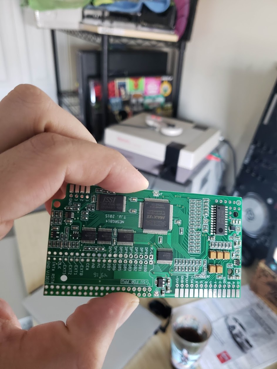

The Nintendo Entertainment System RGB is NEXT! (before this weekend) :)
The only thing I'm trying to solve is the crimping of Saturn cables.
I think my Paladin crimper needs a new die.
Gotta hate it when the most needed tool has a "business end" issue.
For now it's all hand wired and taped like a boss.

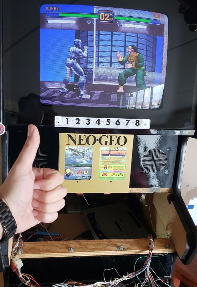

Tested the Jammacon today with Saturn and it works perfect! Only way I can even tell that it's Saturn game is the 2sec loading pause between the stages, other than that it could be my Dai Ou Jou from IGS PGM (playability vice). Looks stunning, sounds awesome, no inputlag or anything bad to say about this product. I took PS1/PS2 adapter on this too, that I have not tested yet.
SEEHAAA
My setup now with: Saturn + Jammacon + HAS + OSSC
Some DDP pictures
