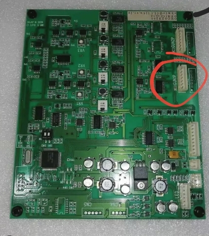

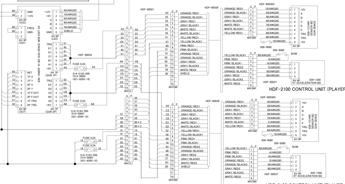

Hi all. Other threads on the site have helped me with my Lost World and HotD2 setups, now I'm stuck with my Lindbergh. I have a Lindbergh multi and a HotD4 to work with. Using my "knowledge" from those and my Driving Lindbergh setup I have most of my problems solved.
The connection from the Hotd4/Rambo uzi light gun (18 pin) does not go directly into the gun sense board (9 pin), so what am I missing? The 200+ page manual has no pics of the cables for reference. The wiring diagram shows the gun hose (Sega part # HDF-60038). I see part #s HDF-60021 and HDF-60033 leading into the gun sense board but nothing online matches those #s. Help if you can, thanks as always!

the connector on the gun sens board is just for the trigger and the IR sensor. the second button, and accelerometer pins on the gun go directly to the JVS IO board, and the pins for the rumble motor will likely go to a separate motor drive board that is controlled by the JVS IO.
so basically you're missing the rumble drive board, and the harness that distributes the connector on the gun to all of the other boards that it needs to connect to.
I have no idea what the pinout on that gun connector is maybe someone else will have some info, or worst case you'll have to take the gun apart and figure it out yourself.

You have to add the wires to the JVS I/O
The RAMBO stock gun (from a RAMBO cabinet) will not have sufficient wiring to the JVS I/O.
Thx, but it's the HDF-60021 i need to find it or to rebuild it ;(;(;(
