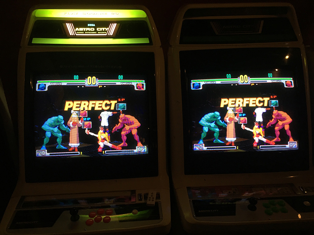

HAd no idea that the pcb also supported 4 players! cool, thanks for the info. Would love to see a pic of bomberman running in 4 player mode with 2 cabs.
It looks like this:
It's a really fun game! Naturally there's the regular four player tournament mode (what you would expect), however, what caught me by surprise is that the 'story mode' supports four players as well.
That looks glorious. Cool that the normal mode also supports 4 players!
