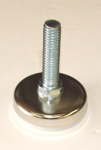

Well, you're not supposed to put regular bolts there. You need these:
