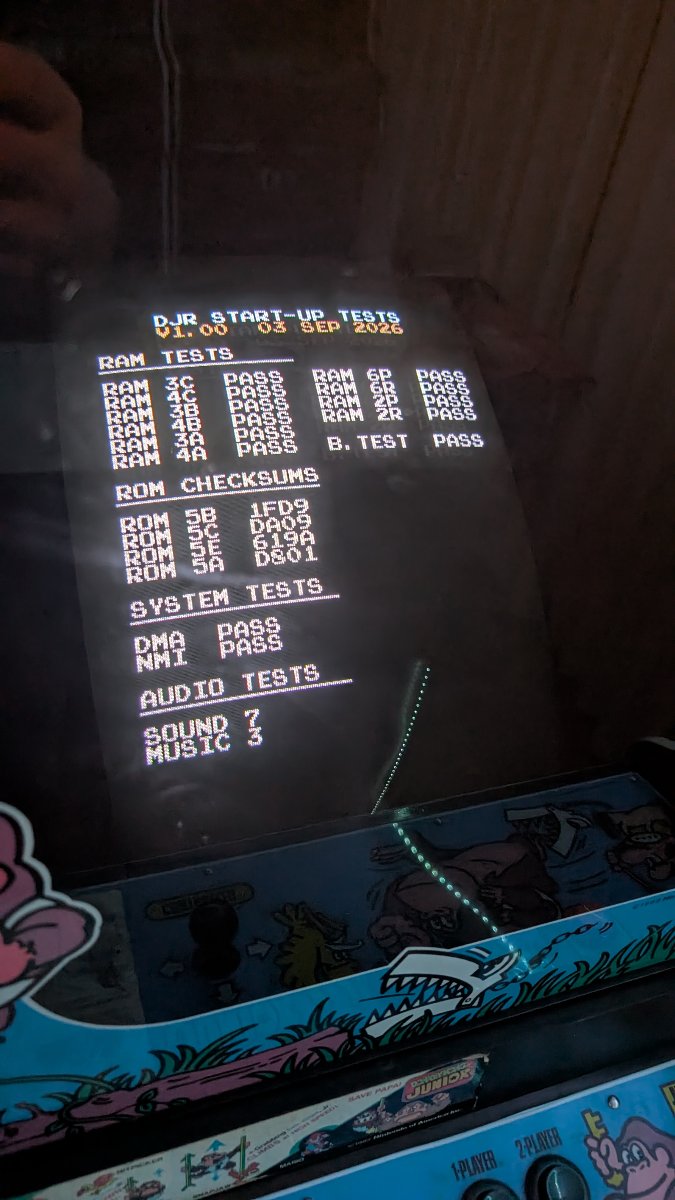

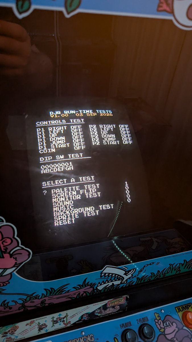

I've written quite a few freeplay mods at this point but I had never written anything from scratch. I decided it would be fun to write a diagnostic ROM for Donkey Kong hardware. It runs RAM, ROM (just prints checksums), NMI, DMA, and audio tests on startup. It also provides controls, dip switch, and basic video function tests as well as some crude monitor test patterns in the run time menu.

Test menus (same on both DK and DK Jr for the most part)

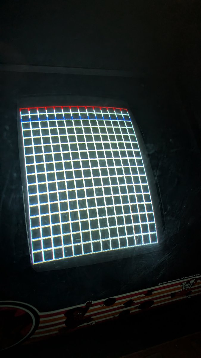

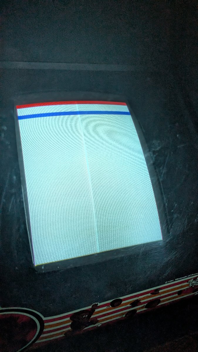

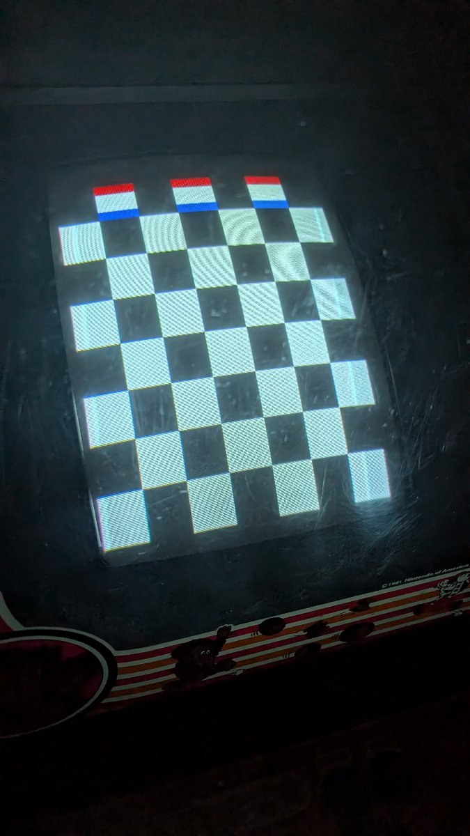

Monitor test patters (as they appear in DK)
