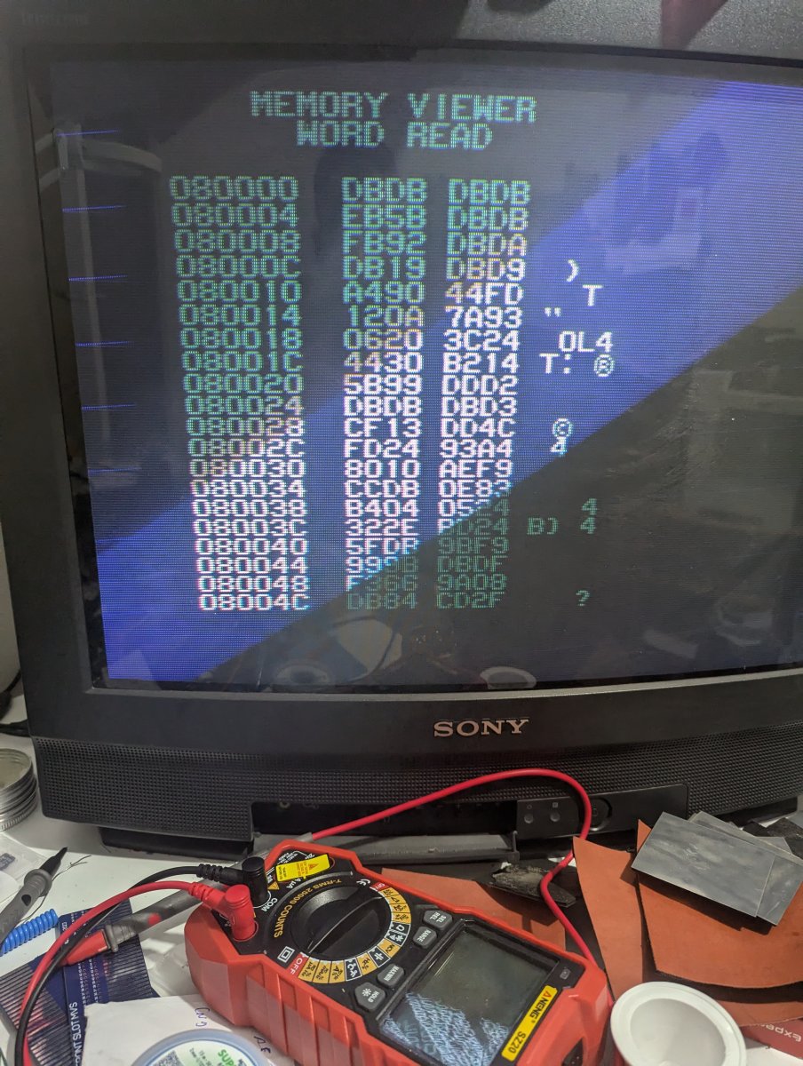

Indeed only video dac test actually triggers watchdog. BG1 Ram in memory viewer is total garbage. (Not 0 at all !). Same for BG2.
What to conclude ?
That kinda implies writes aren't happening and ram is just filled with gibberish since its never been initialized. Give this a try

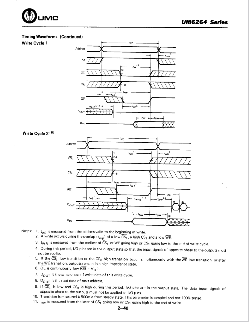

OE will pulse high for me when doing the BG write test in the memory viewer. My BG ram chips are UM6264AK-10L and the datasheet says
Its not clear to me if the high pulse is needed or not. Write Cycle 1 shows OE should be high, but write cycle 2 says low. The sony chips you listed seem to completely ignore OE when WE is low. So dunno.
