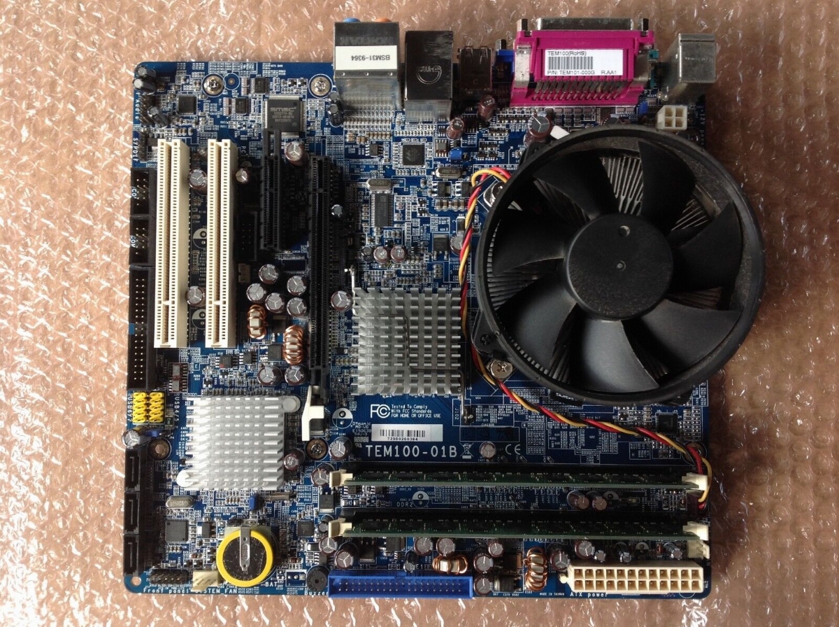

I've noticed that some models of Konami PCs have the same TEM100-01B that the TTX2 uses. I replaced the BIOS but no luck, it won't boot, just black screen. I had to write the original Konami BIOS back so it would boot again.
So question is.....has anyone successfully converted a Konami PC or a TEM100-01B to a TTX2?
I know there are some TTX2 models that have a regular TEM100-01B mobo. How do these work? Maybe the BIOS is different on those TTX2 with refilar TEM100-01B mobo. Has anyone dumped the BIOS and NVRAM from these?
