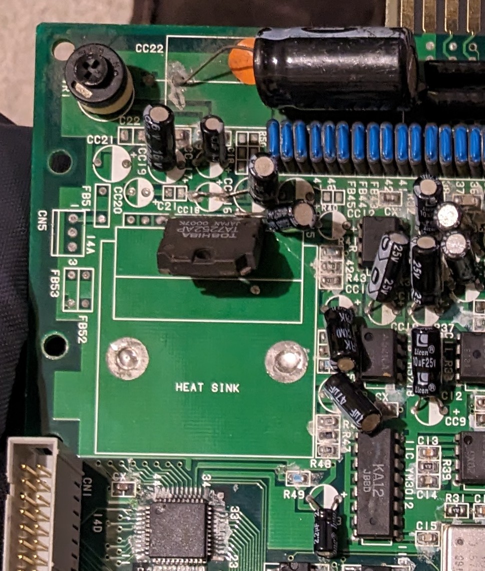

The A board, looks like it could be a CPS 1.5 board, it's missing the audio amp and has had one added, sound is a bit off but can't quite put my finger on what's wrong with it.

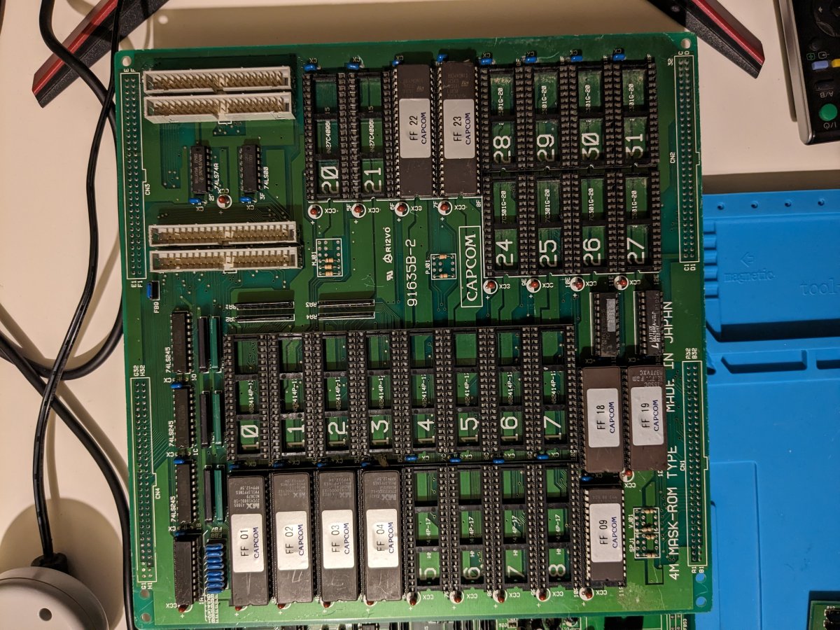

The B board seems to be from a different game, like Cadillacs and dinosaurs, I thought that the final fight board should be 89625B-1? Is it common for these boards to be repurposed?

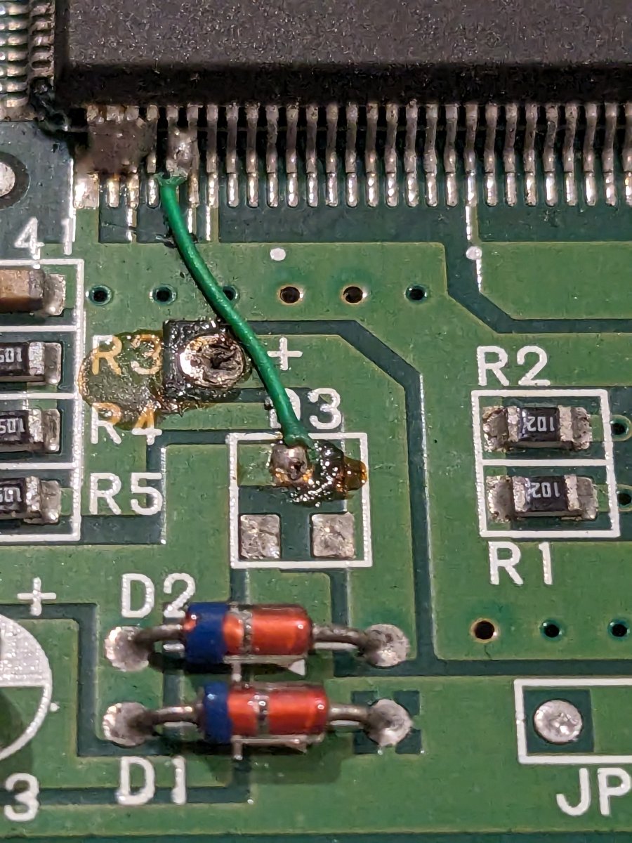

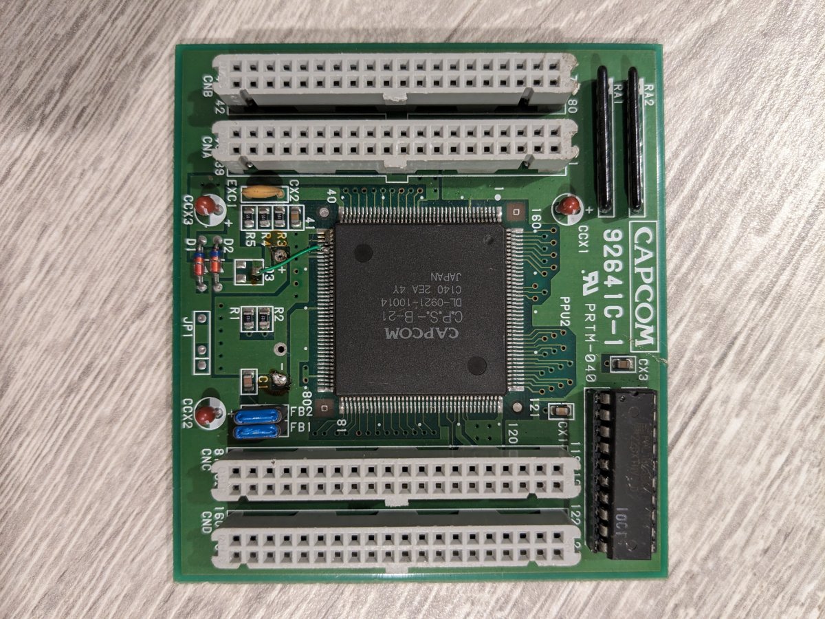

The C board looks like it previously had a battery, it's been removed and hacked to bypass it. It has the CPS-B-21 chip. I understand why pins 45 and 46 are cut/wired to +5v as part of this mod but does anyone know why pins 41-44 are soldered together?

You have a repurposed CPS1.5 A board, repopulated with cheap parts to enable jamma audio.
You have a converted B board from who-knows-what game but it doesn't matter really.
You have a C board that has had a battery removal and a key bypass, so that the converted B board code runs without the normal Final Fight security key.
The pins 42,43,44 are for security, and 41 is ground. There's probably a trace cut there too.
