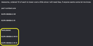

@Darksoft can you share the part number of the yellow rca connectors you used to see if we can source red/white, please!!!!!!!!!!!!!! :D
Awesome, ordered 10 of each to lower-cost a little since I will need 5ea, if anyone wants some let me know.
part numbers are
KLPX-0848A-2-W
KLPX-0848A-2-R
Gold plated:
KLPX-0848A-2-W-G
KLPX-0848A-2-R-G
