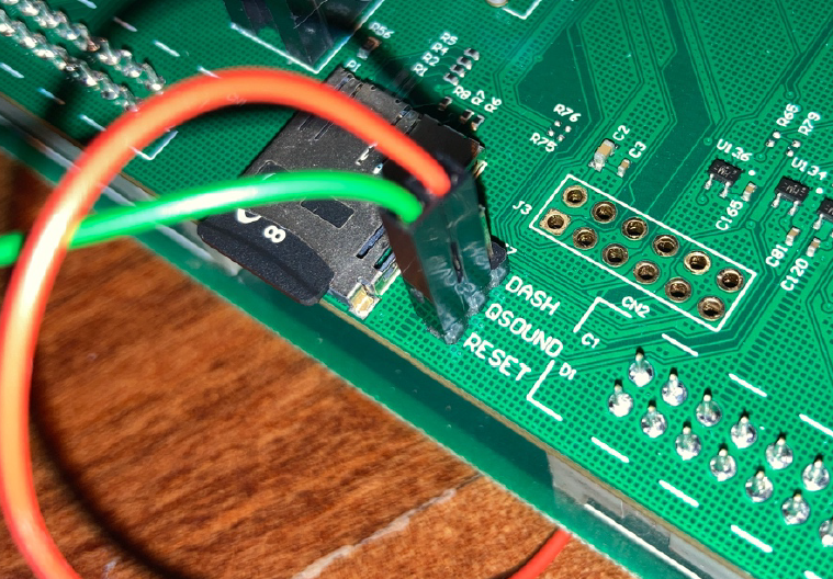

^ The reason they’re reversed have been addressed in some posts in the “Official”CPS-1 Thread.
FWIW, there is no universally right or wrong colour to use for each point, and future kits may even have different colored wires.
Users should explicitly follow the guide they’re using for the install be it the pdf, YouTube or otherwise. That’s the best way.
It don't matter what color wire you use, however if you look at the solder points AND you look at the length of wires included its pretty clear which should go where.
ie Manual is correct, video is wrong (technically speaking nothing is wrong, but based on wire length).
fwiw the wire setup was a lot more obvious to me given the length differences than the C board battery removal requirement. In any case, it's good to have all of this spelled out clearly in the manual for people who arent doing this right now but maybe years later when it's no longer a fresh forum topic. And if it's followed the same way in a video guide, all the better.
I just added a notice onto the video indicating that I installed the wires backwards, and that owners should use the longer wire for Reset.
Maybe add some notes to the video. I think that can be done pretty easily, right?
I added the notice to the top of the show notes, but I can't modify the video itself without reposting the video with a new URL and losing the existing comments and view count. YouTube used to allow you to add "pop up messages" to an existing video but they took that feature away a little while back.
This is what viewers will see underneath the video player now:
