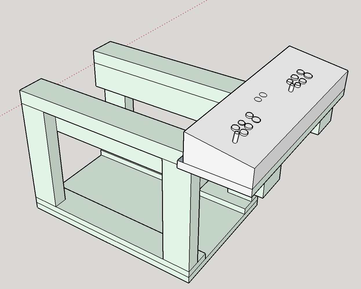

I did some more planning, thinking, measuring, and drafting, leading to a tweaked design. (pics attached)

So for the cab it self so far its looking like:
A) wood for frame - $60
B) wheels - $22
C) wood glue and screws - $10
$92 + ??
D) I think the only cost left is the mdf shell and paint, but that is later added functionality. ?($20-30ish)?

I am trying to build everything into my model and I have already thwarted many problems, and had to move things around. I have prototyped models to include room for speakers and subwoofter, stepdown transformer, shelf, surge strip.
@ekorz you are right in that no matter how much I try this will not go 100% smooth. But I feel like I have given this enough thought to get me something I will be happy with.
I using pretty much all butt joints, but if I ever get access to a legit shop v2 will utilize some of the more advanced joining techniques. I may drop $20 for a pocket hole set up

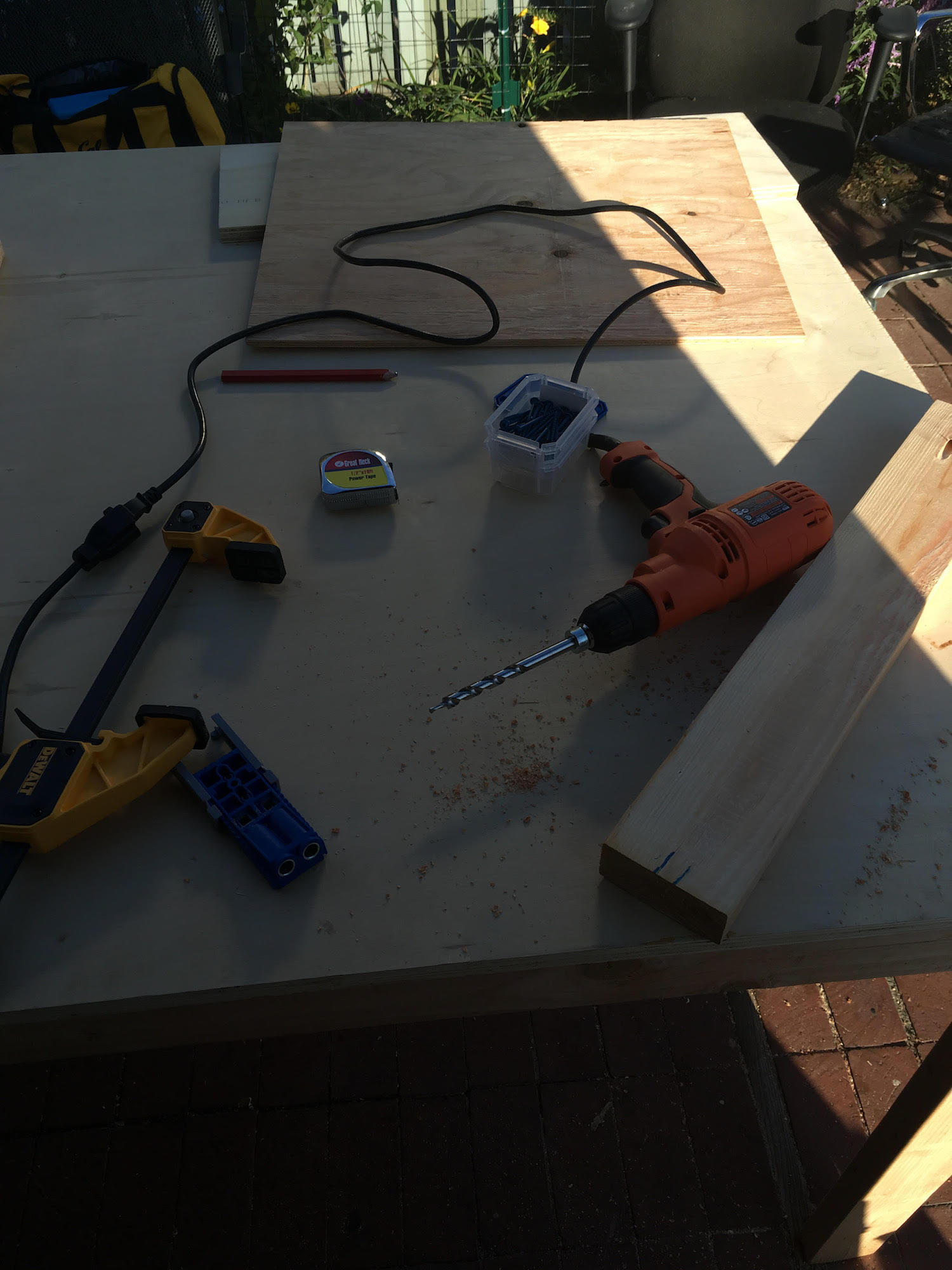

I decided while I was at it with this arcade cab build, I would take on another project, because why not? It will provide a good practice run for the cab. The other project given to me by my friend was a table for drinking games (beer pong, beer dice, snappa).
So, yesterday I went to lumber yard, I was there around lunch time, so that was a bit of an extra delay. I collected the cut lumber for table and cab went over to homies house to build. Please excuse me being shirtless, it was hot and that is the only pic taken during assembly. The only power tool needed was a drill/driver. Other hand tools supplies used: a couple of clamps, wood glue, tape measure, pencil, corner square, sand paper.
I ended up getting a pocket hole jig kit, and damnnn that made the build go super smooth. I got the R3 model for $39, a clamp to use it with is like $10.
https://www.amazon.com/Kreg-R3-Pocket-Hole-System/dp/B000J43A7W/
Here is a good video on the device
The table for the drunk kids was a good practice before I attempt the frame for the cabinet later today ;)
