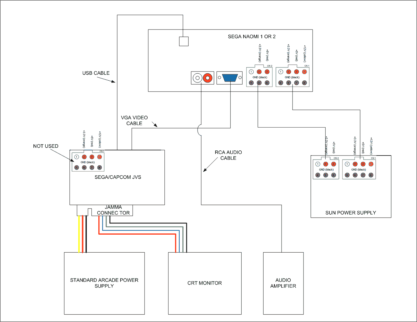

What do you mean power using a second power supply ? Can you show a diagram / picture ?Ok cool .. so thats for the JVS. Which i power using a second power supply that doesnt have 3.3vdc.
What about requirements for power for the Naomi itself?
Yep I can do that .. but later. Basically I am powering the JVS through the JAMMA harness from a standard power supply and I am using the Sun power supply as a dedicated power supply to the Naomi. Not using the power connector from the JVS to the Naomi at all.What do you mean power using a second power supply ? Can you show a diagram / picture ?
The NAOMI adheres to the JVS spec so the JVS spec gives the numbers.
