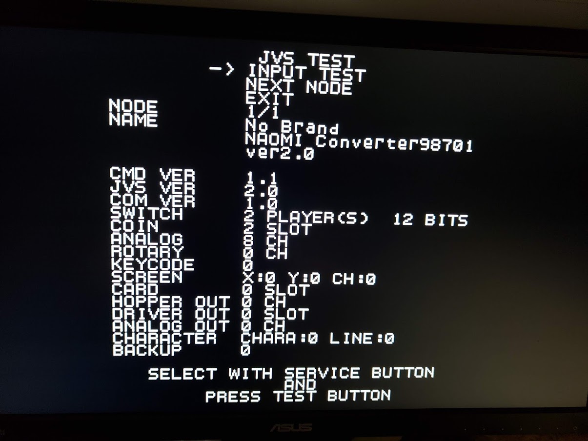

what JVS is that @psykom1? Most of the issues that I found were always related to the version of the BIOS and the JVS used. AW conversions dont like the Capcom JVS.
I disagree. Currently I am using a US Sega/Capcom JVS (v2 I believe) and it runs all the AW conversions I have thrown at it! My Japanese Sega/Capcom JVS' do not like them however.
I think mine is the same version as his. I will check when I get home.
That was my experience. If it's not that, maybe you can narrow it to something else in this case.

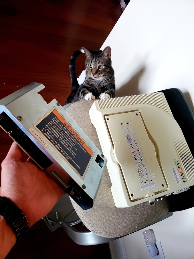

@Darksoft It's one that came with an American Marvel Vs Capcom 2 Naomi kit.
My current setup is a Naomi 2 with this IO and everything else I listed on the other page.
I can play almost any AW game I can throw at it providing I give it beefy power supply as noted.
I'll pull more info when I get home later and I'll be happy to test what I have to certify what works and what doesn't
The only picture I have of the IO is the one here...
It's the US variant that I sent a screen cap of in my last post as well.
OK took pictures of everything..
Yup same make and model
It's the US version
