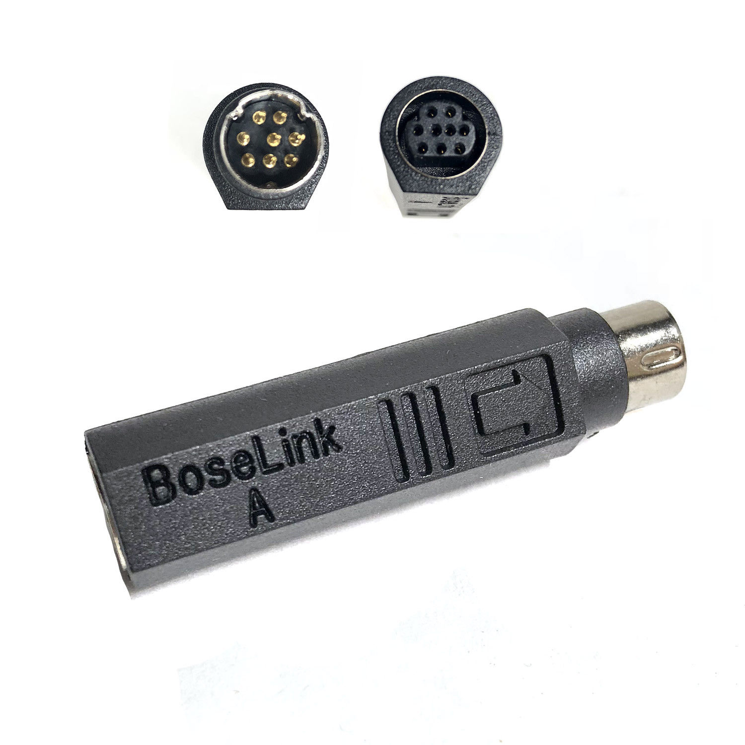

Basically, I really want to be able to plug this into my gcompsw v5.2 so I can get it to output to both my pvm and ossc at the same time. would something like the Bose 9 Pin to 8 Pin Mini DIN Adapter work?

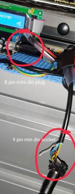

I just soldered it all up by hand, an 8 pin mini din male to a 9 pin mini din female.

The cable I made for Minigun to Sega hd retro cables is just passive , just wire to wire, nothing special. I am making a few more of them, if anyone wants one msg me.

Just a passive wired converter works well with the hd cables for me, just remember to wire csync from the din8 to composite on the din9. I didn't bother wiring audio on mine and just used the CPS2 stereo RCA into the HD cable 1/4 input.

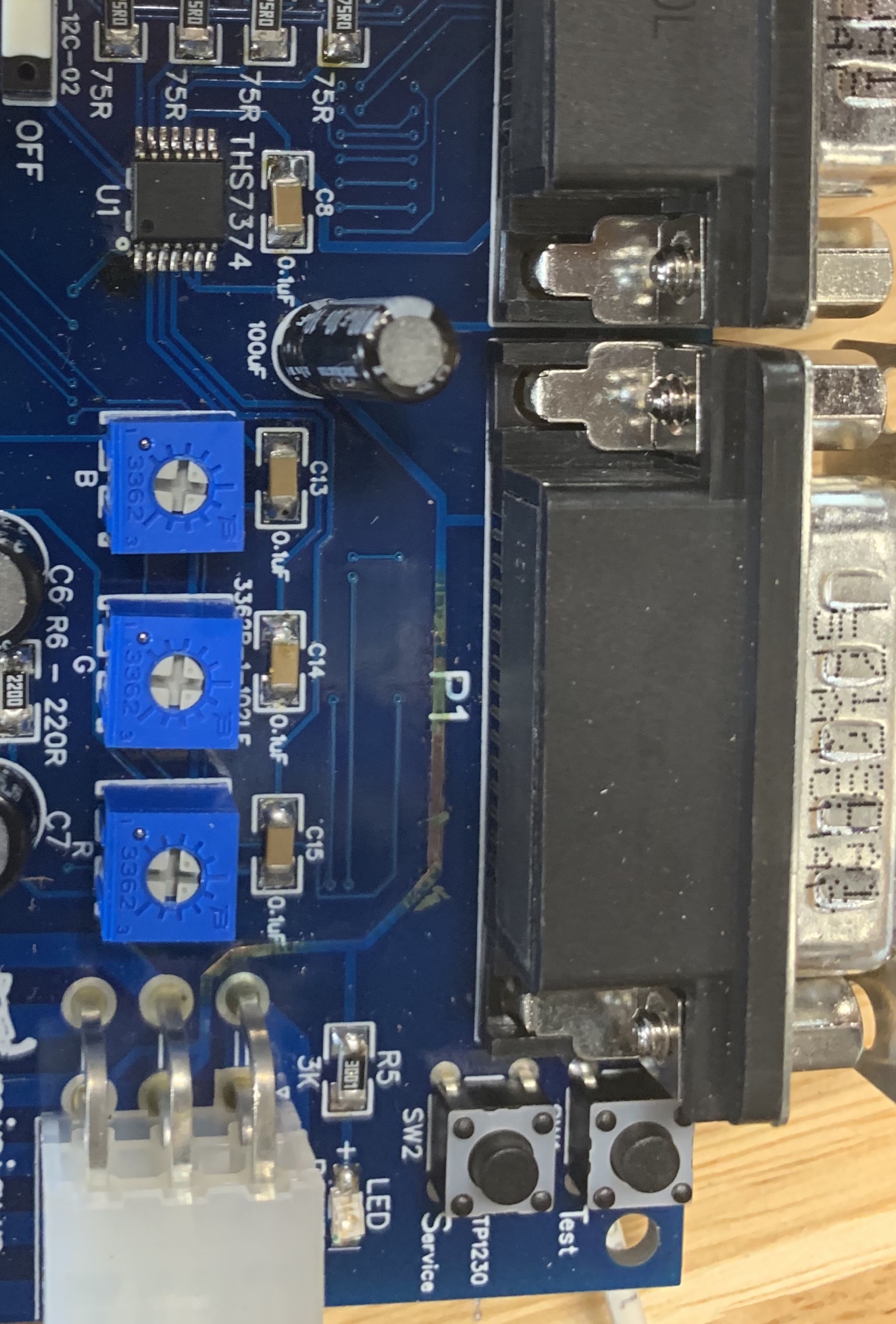

I have a stupid question. I’m putting together a custom fight stick and I accidentally shorted +5v to GND through wires to/from the P1 dB15 connector (pin8 to pin 1) which resulted in the pcb emitting a good amount of smoke along the trace back to the power connector. The board is still operable but I wouldn’t expect that to happen?
V1.7
Edit: after looking more closely I can see why that would happen.
V1.7
I mean... if you short +5V and GND, what would you expect to happen :)
Don't do that :P
I think subconsciously I'm just looking for a reason to upgrade to the latest version..
I accidentally shorted my supergun too when connecting a joystick... fortunately my 42PP0606 PSU stopped quickly and there was no smoke or damaged tracks (but a broken THS7374), the board was apparently not damaged and it works fine.
Since then I don't connect the DB15 metallic case to ground in the supergun. I'd recommend you to connect or disconnect joystick only when the power is off.
