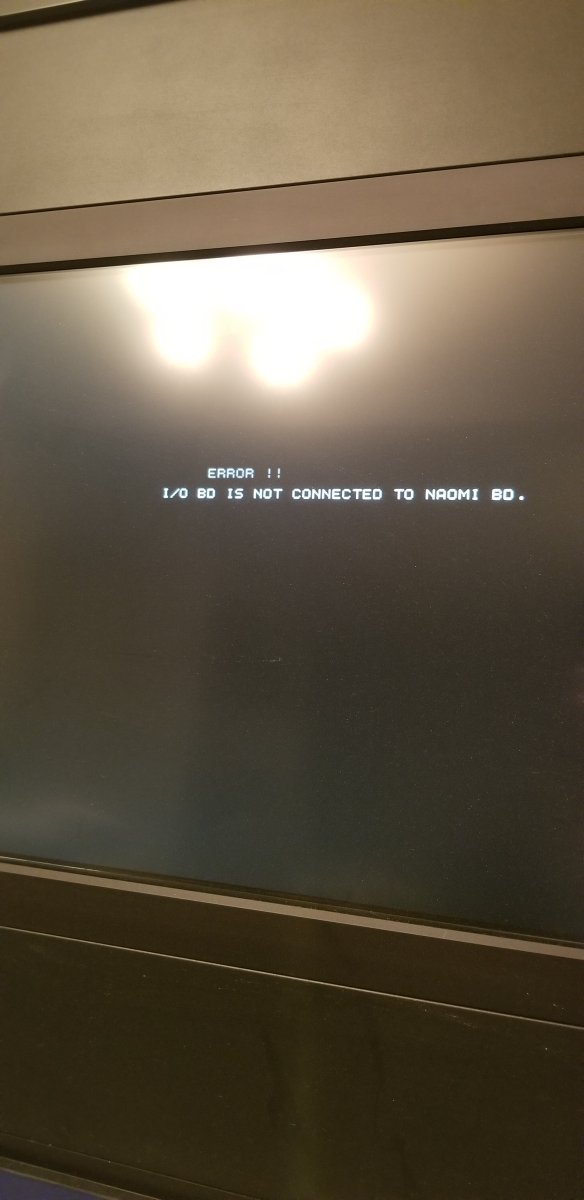

Just got my Iona, plugged it in so I can play GG, and when it got past boot, all it said was this:
I connected the device to my PC via firmware mode to see if it needed to be updated. Made sure my gamepad was unplugged. WinUSB and even device manager don't recognize it. In the times I've plugged it in, I heard the windows connected noise once. What am I supposed to do? I believe the version I have is 2.00.
I don't see you make mention of bringing the jumpers on the board. Save yourself some headache and use a USB a to USB a cable or a to type c if you have type c ports on your PC. Using Zadig was the only way I could get the driver to install.

In case it helps anyone else, I got an adapter today and ran into a few issues so thought I would post the solutions I figured out that I couldn't find in this thread already or elsewhere -
USB device giving an error when setting up drivers:
For getting the device connected to a PC the info about holding down SERVICE while connecting both power and JVS was very helpful, but I was still having trouble getting the device to successfully work with WinUSB. I tried multiple cables (power and A cables), 2 PCs and USB 2 and USB 3 ports but had no success. The solution is that the connection just seems finnicky, but once you get the device recognized, and even if WinUSB fails, you can keep right clicking on the device and going through the steps to install the driver over and over again until it just randomly works. Sometimes it worked on the second try, sometimes it was 5-10, but it did always work if I just kept trying. That being said I had the most success getting a connection with USB 2, otherwise cables made no difference.
Naomi I/O connection error:
This one kept happening for me after 1-2 minutes of gameplay. Connection to the board seemed intermittent. Was able to solve this by updating to the latest version of 2.XX (2.14a as of this post). Had no issues since then and everything has been stable.
