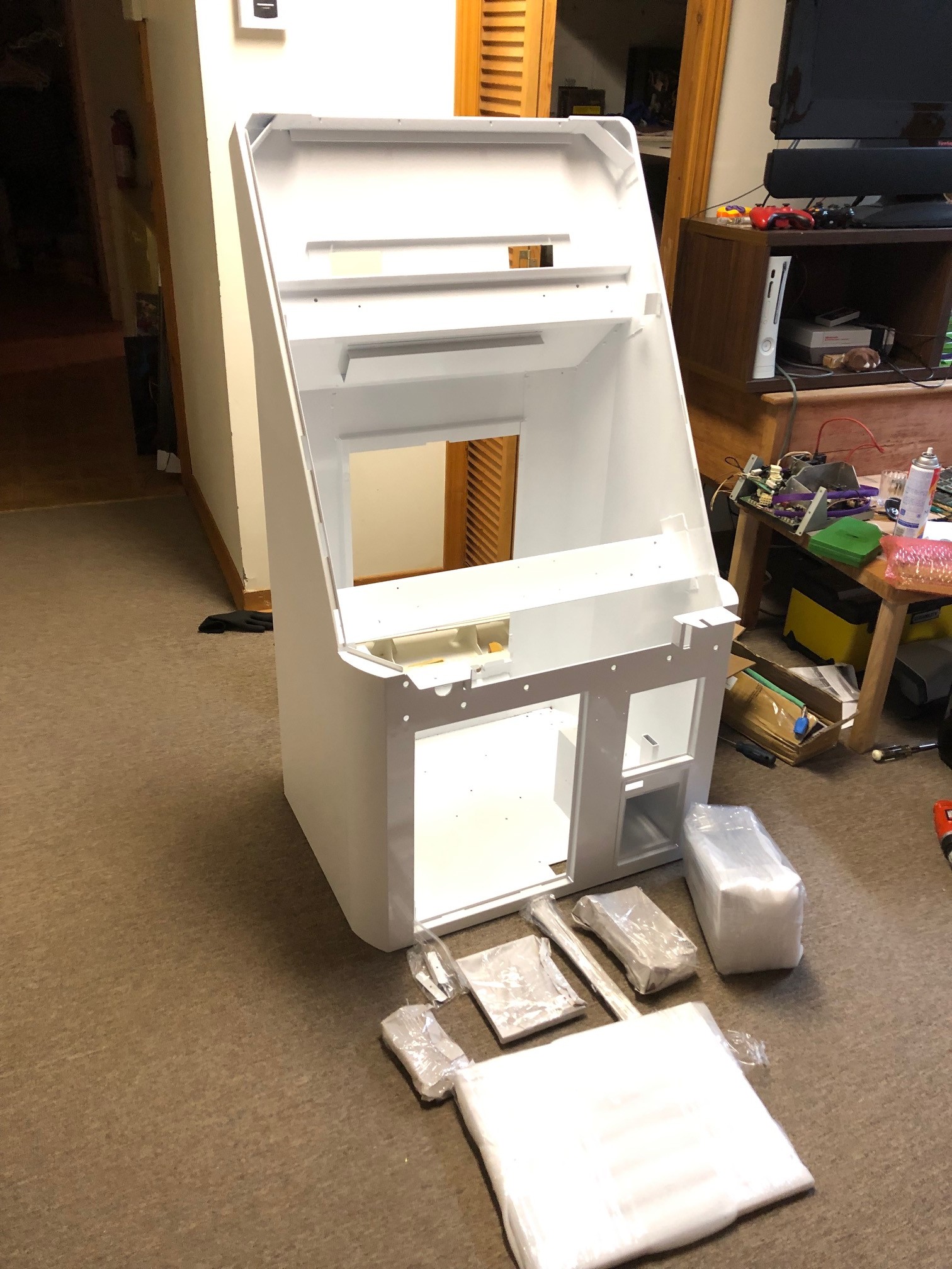

Well I'm so thrilled with the powdercoat results that I have to share the p0rn :) Sorry about the size but it's worth it!

Did you sandblast first?

Is the original coating on the cabs a paint or a powdercoat? The original looks like a paint just because of how smooth it looks, with powdercoat process I have notice that most times you dont get a super smooth finish/look.

- yes it was sandblasted before.
- the original is paint and not powdercoat so that made it cheaper to sandblast. This shop powder coat is DA BOMB and super nice and smooth.

- The wood/rotating/tube is 4 screws and it all comes out. Piece of cake.

Serial plate : Heatgun and heat the shit out of it. use a paint striper to SLOWLY get under and you're done.
