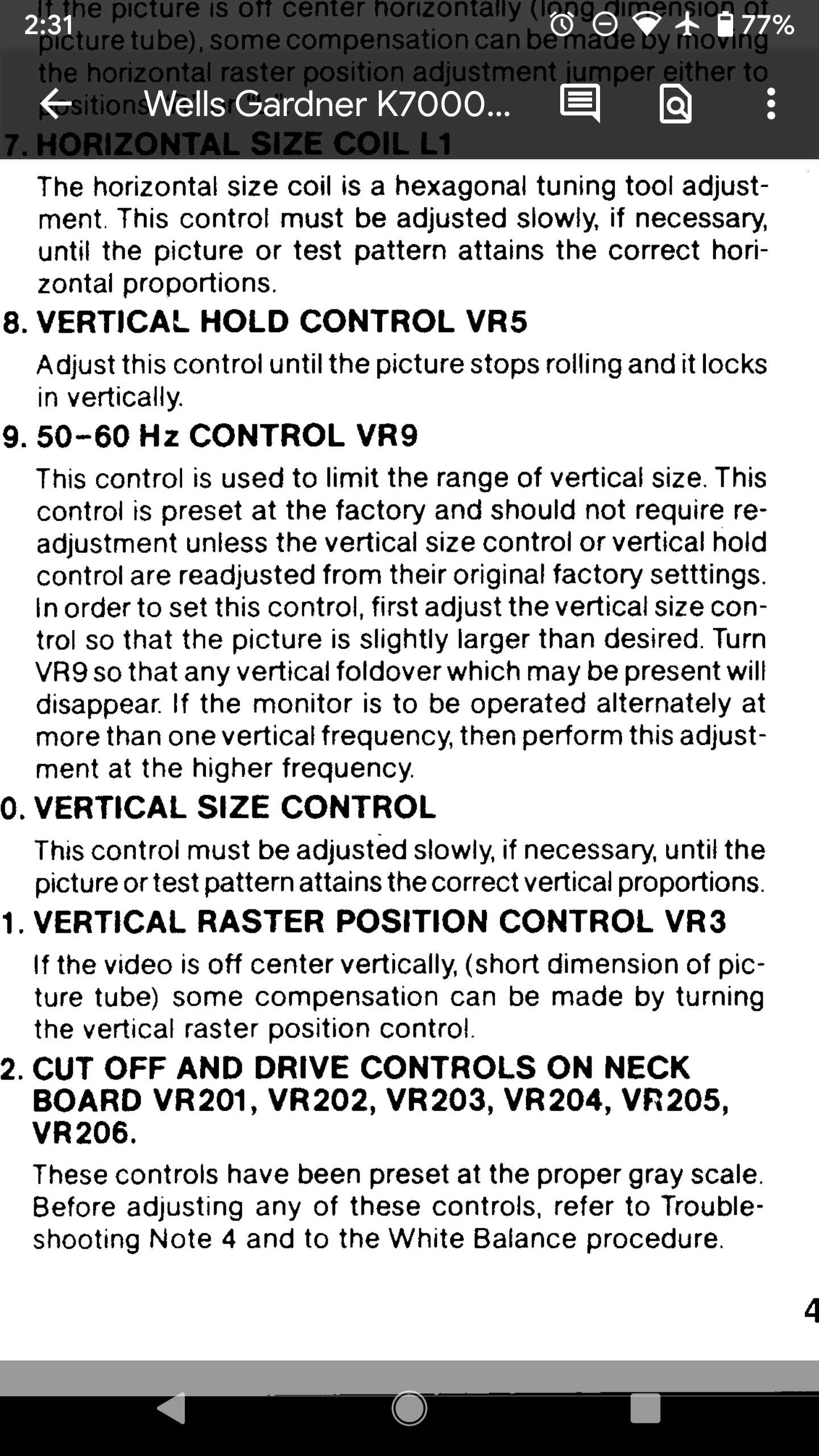

With k7000 be sure to check vr9 it is vertical size limit says 50/60. If not set right will cause vertical foldover
Please read #9
Thanks for the info. I've attempt this adjusted and it didn't correct the issue.
