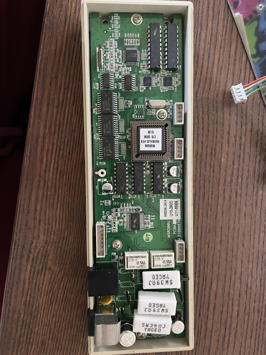

can you remove the swipe section and take a good pcb foto?
whats the socketed chip?
just wondering if we can disassemble the firmware from these printers and readers.
