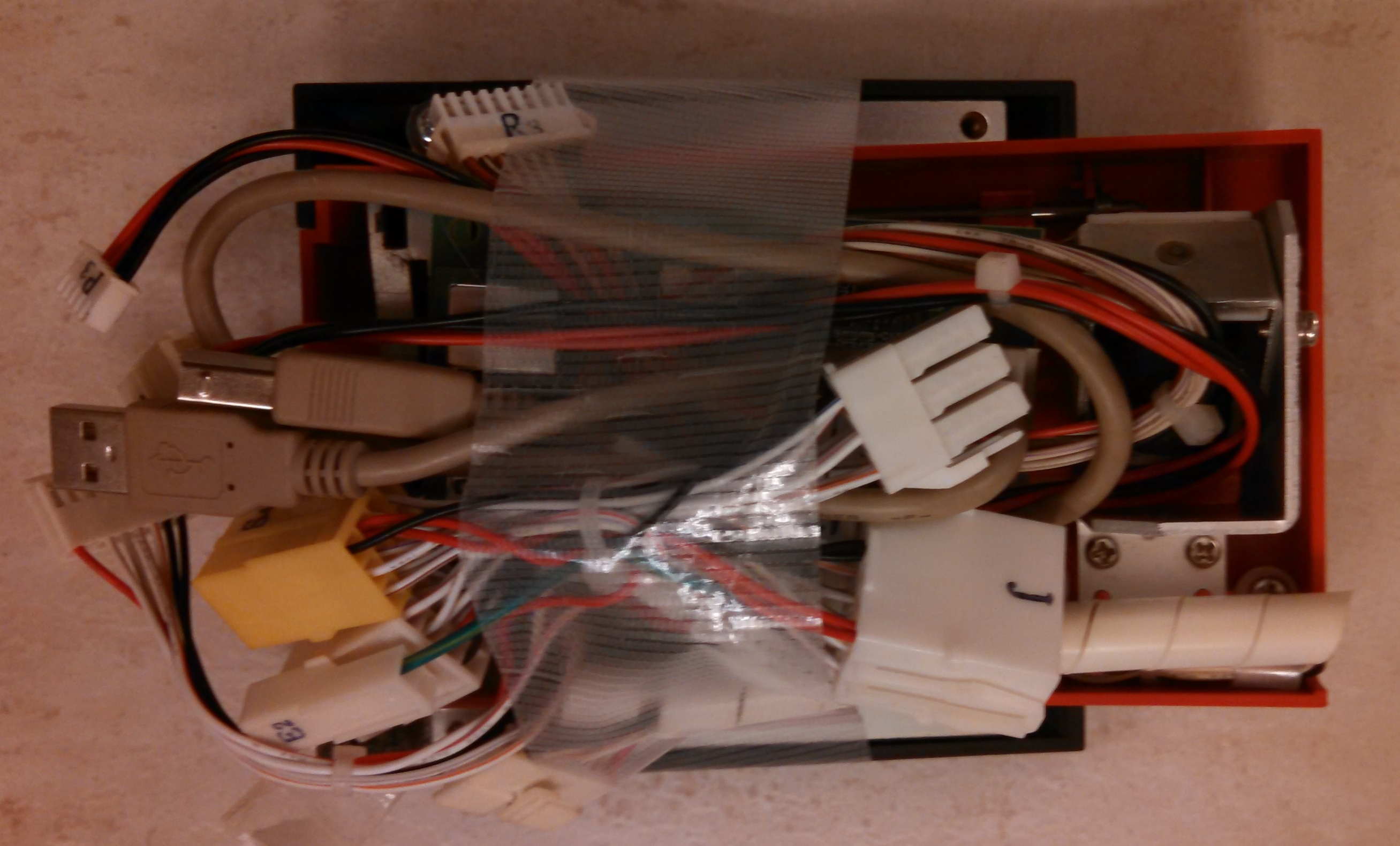

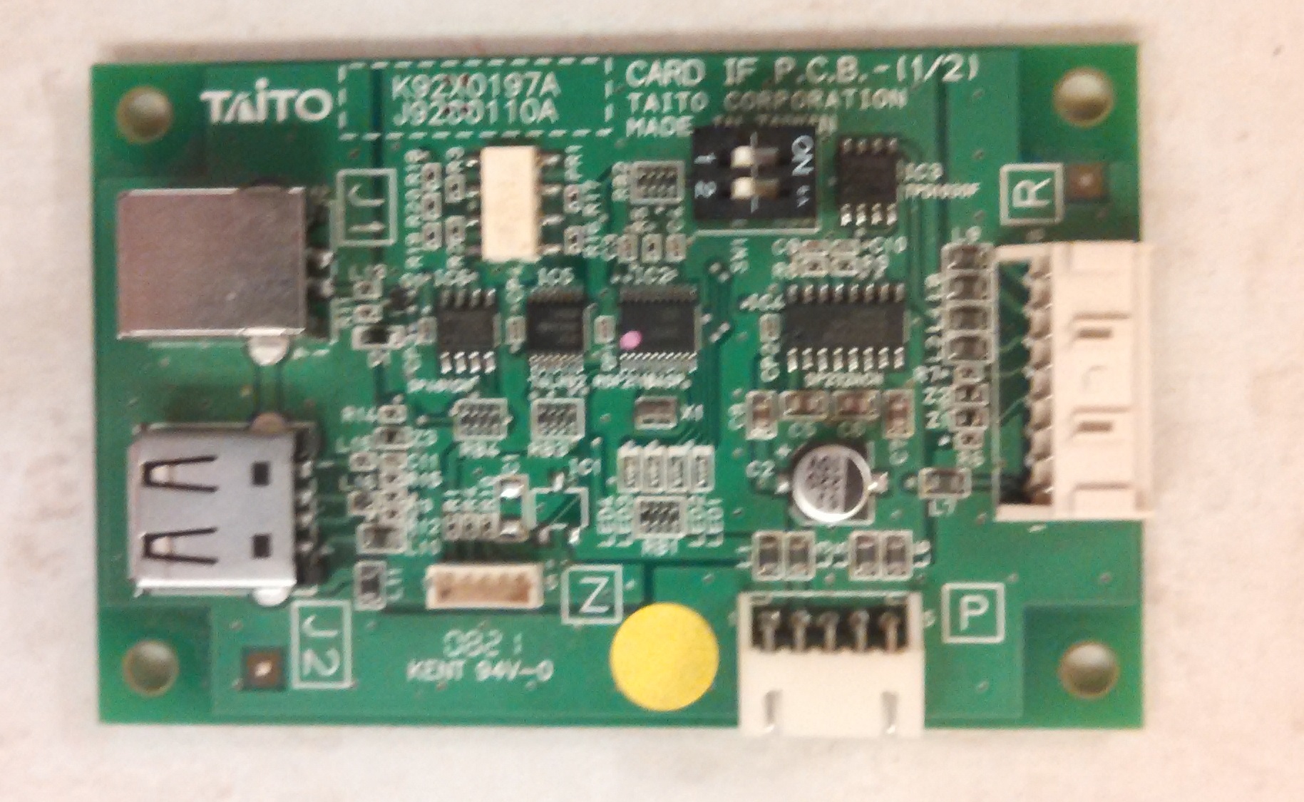

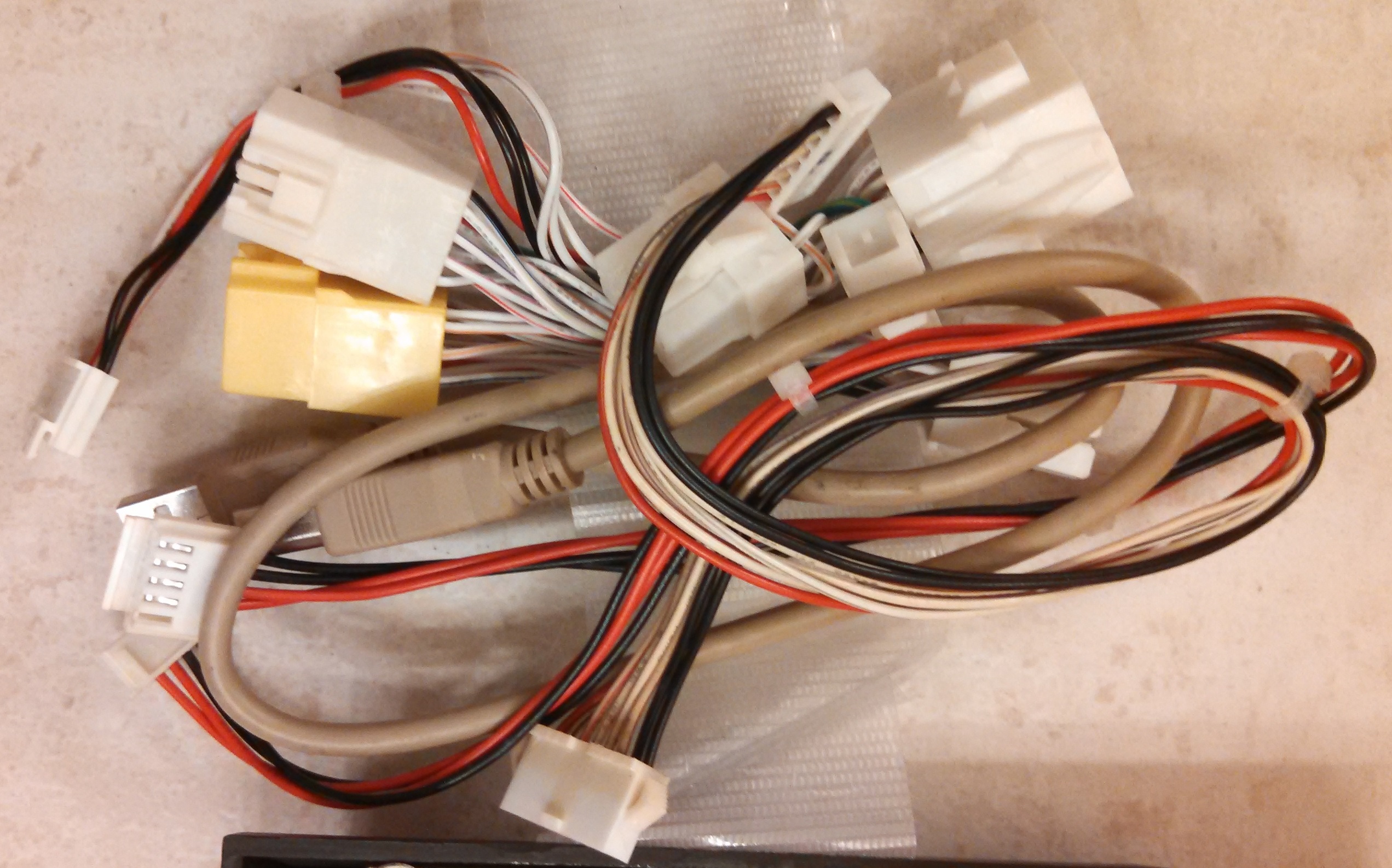

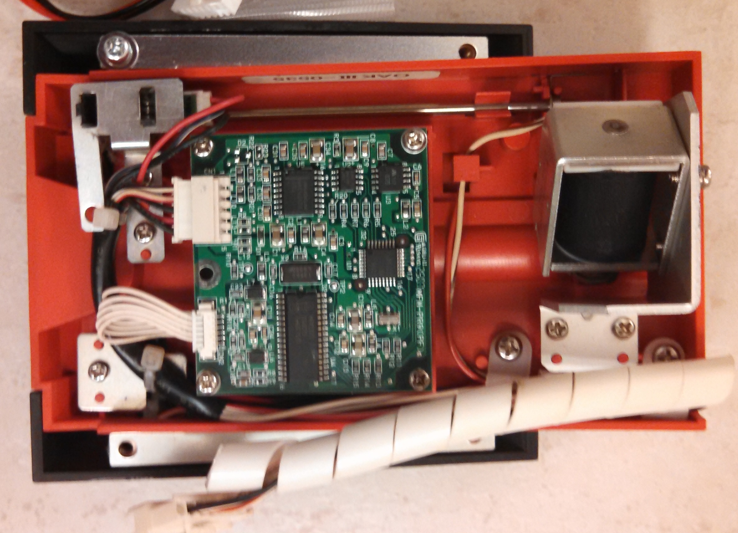

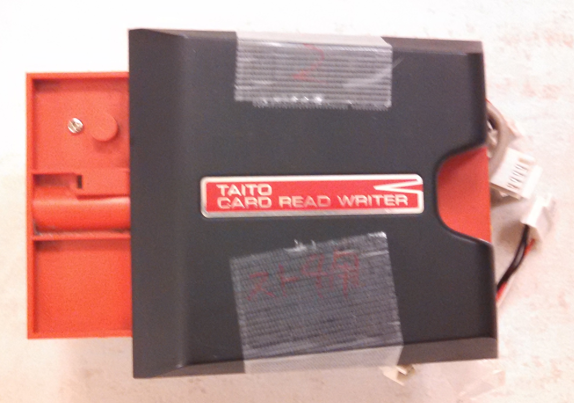

would you be able to upload some photos of the card reader so i can make sure its the correct one
Sorry it took a couple of days. I attached the pictures here.
yea that is the one i need. unfortunately i have to take a short break from this project as i have a new addition to the family. will hopefully pick it back up in a few weeks when things settle down.
Sure thing. Just let me know when you need it. Or I could send it now and you will have it there whenever you get back to it. I am not using it right now anyway.
