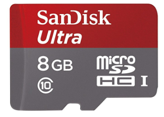

I've got a few Sandisk Ultra cards and never had any issues with them on the CPS2 multi

I've got a SanDisk Ultra in mine as above and I've had no issues, I've also used Samsung Evo before and these also worked fine
It's entirely possible the cards were good but your reader damaged the card as well (I've had this happen 3 times now) - so buying the card and sending it to XianXi is definitely a good idea
Samsung are IMO the best ones. If they are 8Gb or 4GB in size, even better. Like this one:
Windows has diskpart, no need for additional programs.
Even if the card is blank (filled with 0xFF) Windows will properly partition and format if you push YES when it mentions the card need to be formatted.
You should go with the default settings. That will work fine with the CPS2 Multi.
Don't ever let a computer running MAC OS touch the card because it will fill all directories of the card with hidden files that make the CPS2 MULTI stall/crash.
This official tool will "resize" and remove all partitions on an SD card.
https://www.sdcard.org/downloads/formatter_4/
